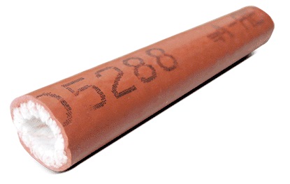

I would strongly recommend to wrap the egr pipe with a header wrap of some sort.

Look for a heat wrap sleeve that will fit on that EGR pipe to protect the wiring harness. DEI makes a few.

Do you know what the diameter of the egr pipe is? I am on Summit looking at the sleeves. ***Never mind - I'm too impatient. I went to Amazon and purchased every size. I'll return any unused ones.

I guess you can’t disable EGR due to being in Commifornia? I think it’s approx 1” in diameter.
Not sure what you’re plans are for the engine harness but you should look into firesleeve for your engine harness nearest the EGR pipe. I got 7/8” but prefer the 1” wrap. It isn’t cheap but it’s better than anything I found on Amazon.
