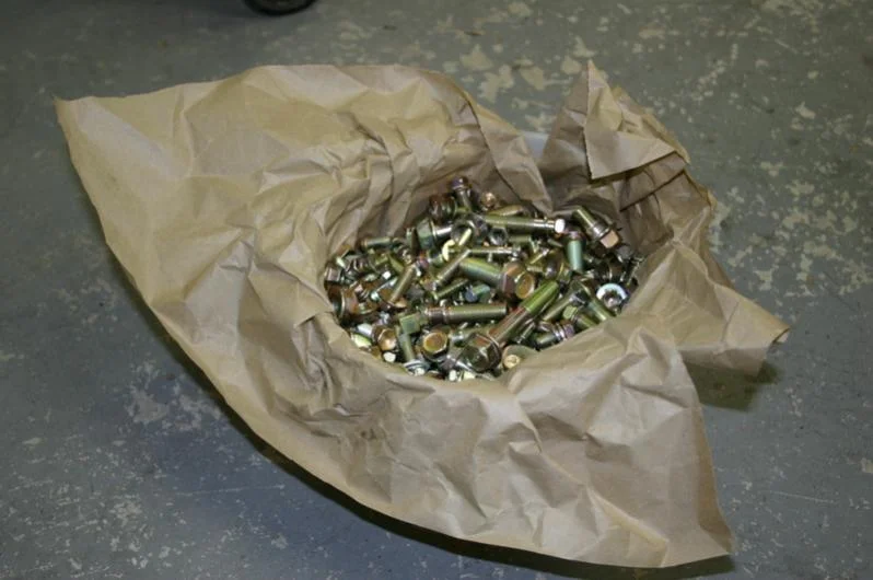

I just take all my bolts to a plater in town. For 3 gallons of bolts it's pretty cheap (maybe $50). That's a couple of trucks worth of bolts.
To get started I went to a junkyard and just pulled common Toyota bolts off of what they had. That gave me enough of a stock to replace bolts, and then those got tossed into the plating bucket. When it got full enough, it went to the platers too.
Best part about it is that the platers can dip them in acid and get them much cleaner than I could without a LOT of labor.
