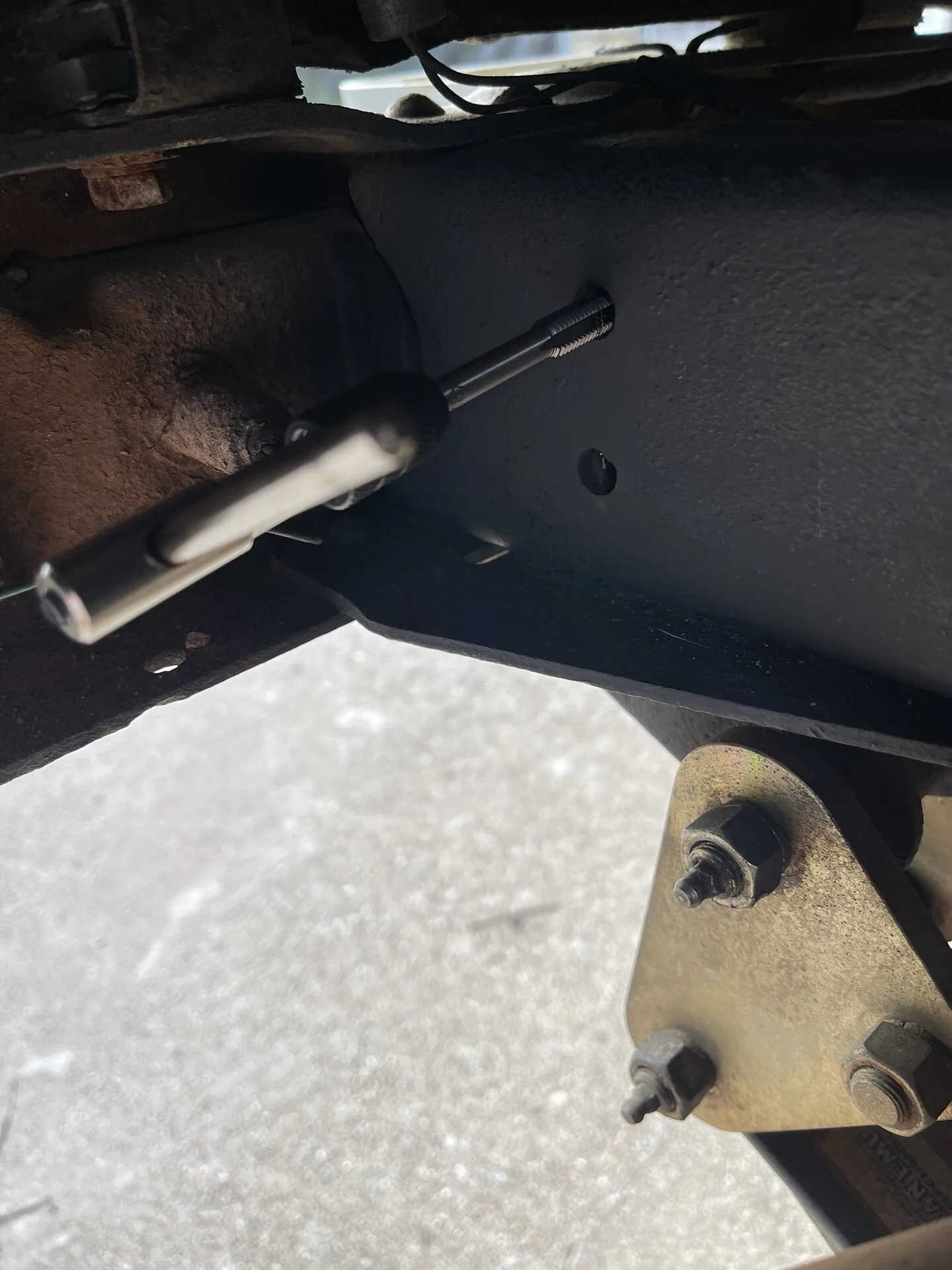

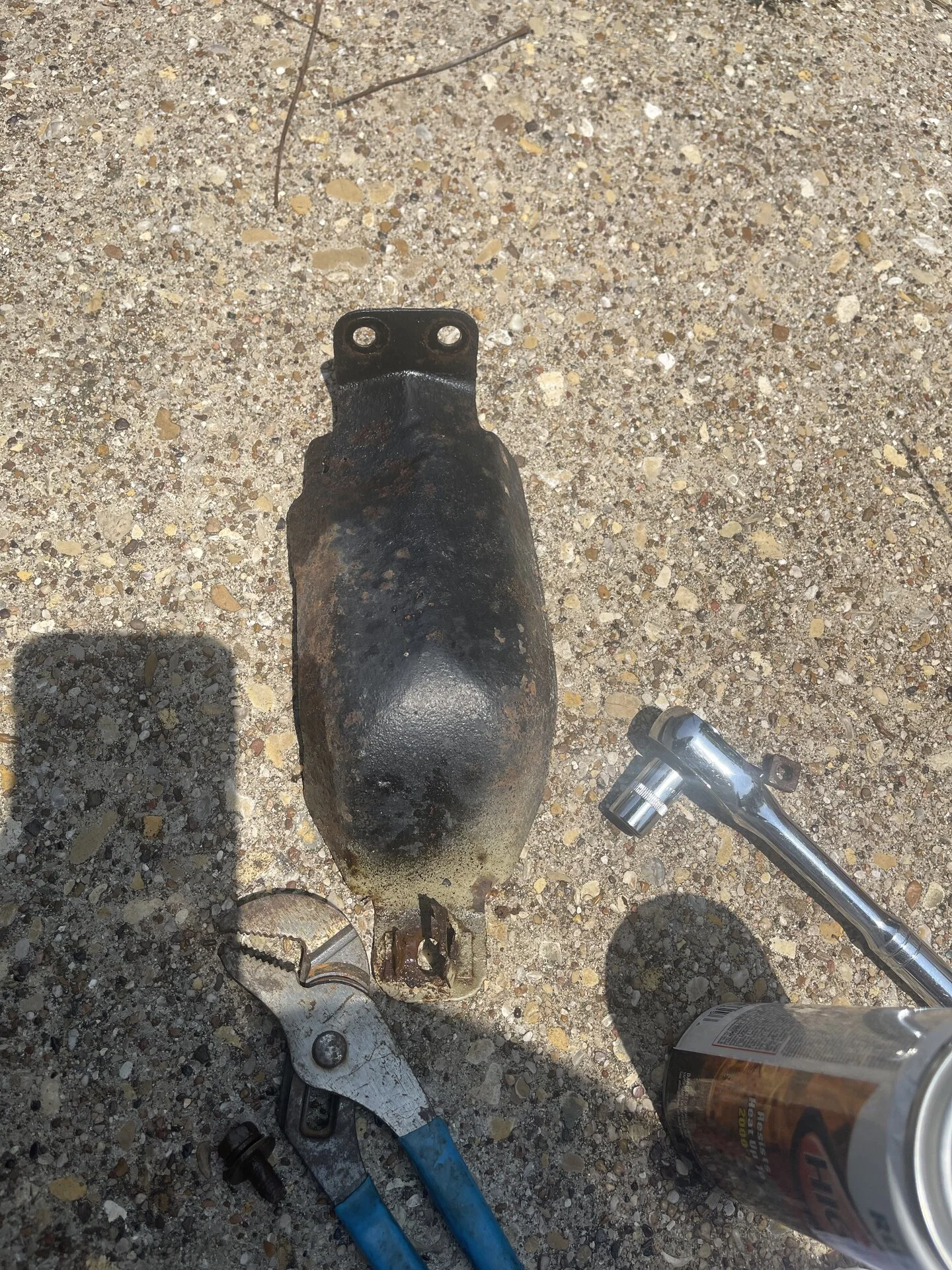

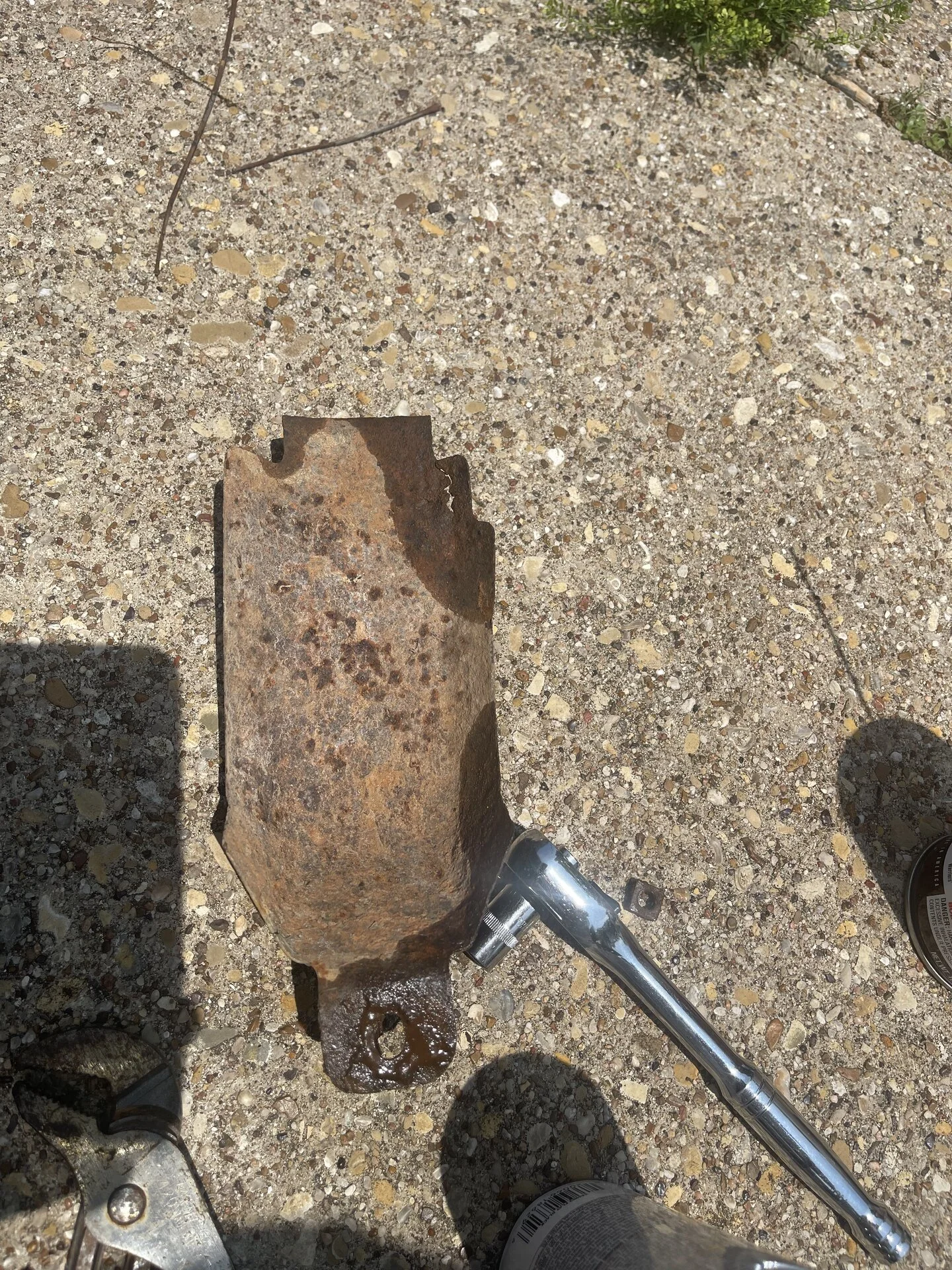

Started with a roof clean and wax then the install. Cleaned and prepared the surface on frame and side wall, but as with a lot of projects like this I’ve found some issues that need attention first. Trouble taking of the rear light covers then the lights themselves. Had replacement lights, started that and found crappy wiring job. Now fixing the wiring, but pleased that it’s getting done right. Hopefully that will be done this weekend and can get back to the install. Will update with picks.
