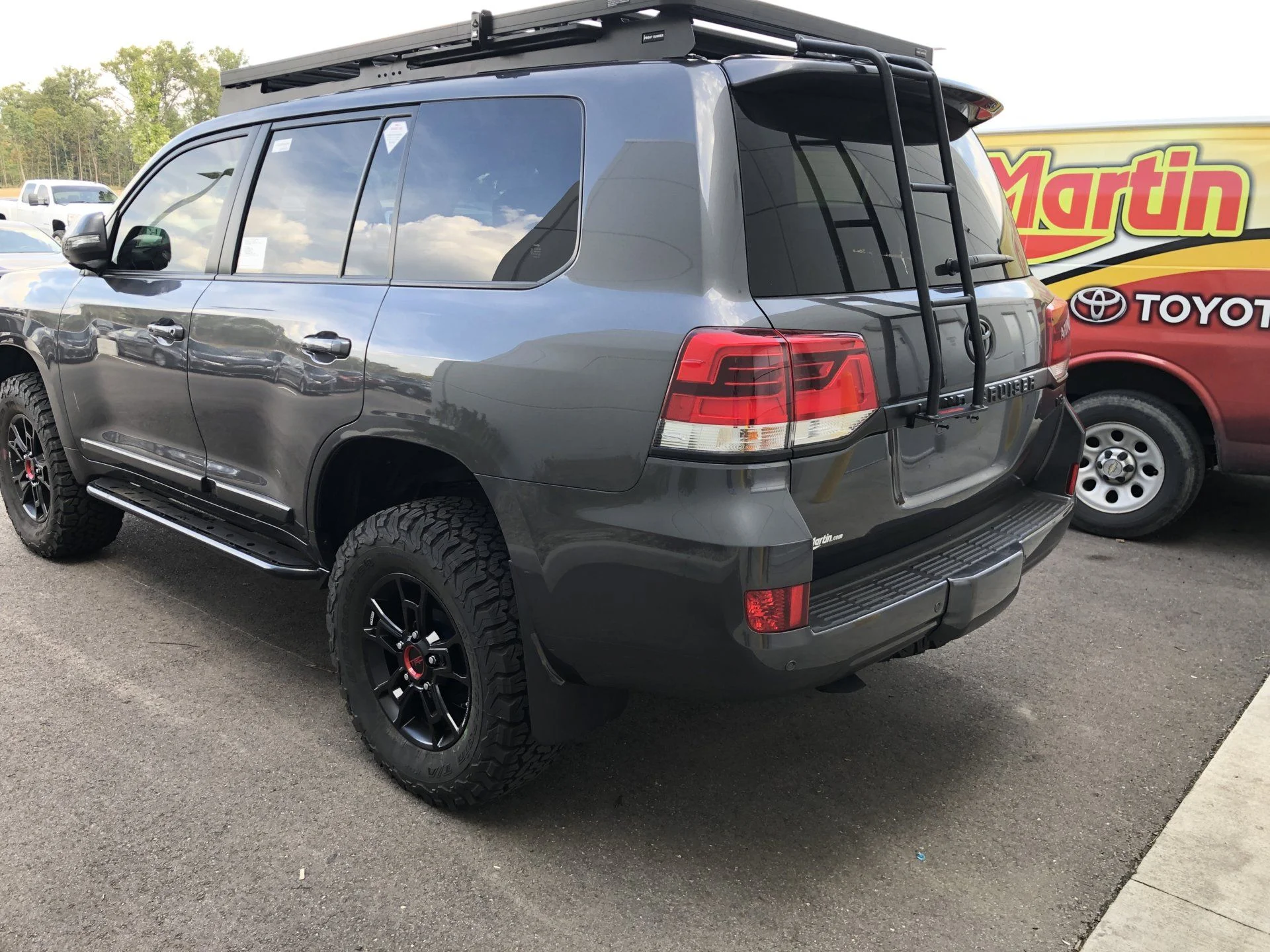

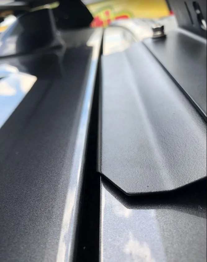

I don’t have measurements, but here are pics from a previous build. You will need to be VERY careful while installing (2018+) you may accidentally pinch or break your power lift gate pinch sensor ($450). I know from experience.
Eric, any tips on how to avoid damaging the punch sensor? I’ll be installing my ladder soon (2019) and would love to prevent a $500 mistake...
Just don't cut the metal, because it doesn't look like there is a sensor in there, but it's an pinch sensor (air pressure). After you install it, there will be a 4-5" gap that the pinch sensor won't work, so it could technically wont. Don't cut the blue area below
Thanks. Is the sensor on the upper portion of the hatch along the spoiler, or the lower portion along the tailgate? I can’t tell from the photo...
Lower part.

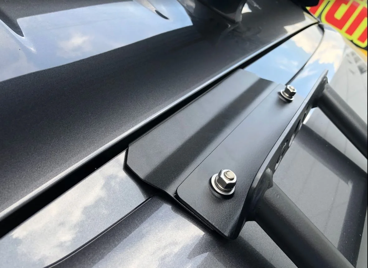

Here’s a tip that may help, and is something you can remedy yourself. I was having trouble after yesterday’s installation with the tailgate intermittently not closing. Pushing against the pinch sensor when this happened seemed to fix the issue temporarily, but it would recur.
There are two set-screws/nuts that clamp the bottom bracket of the ladder to the underside of the lift gate. One of those set-screw nuts contacts the pinch sensor and pushes against it, making it stick out. Remove that nut and push the pinch sensor back against the screw.
Here’s a couple of pictures. On the left side of the bracket, you can see how the sensor (the rubber strip) protrudes outward due to the screw. It’s worse with the nut in place.
This “seems” to have resolved the issue. If your sensor isn’t completely trashed, this may do the trick for you as well.
