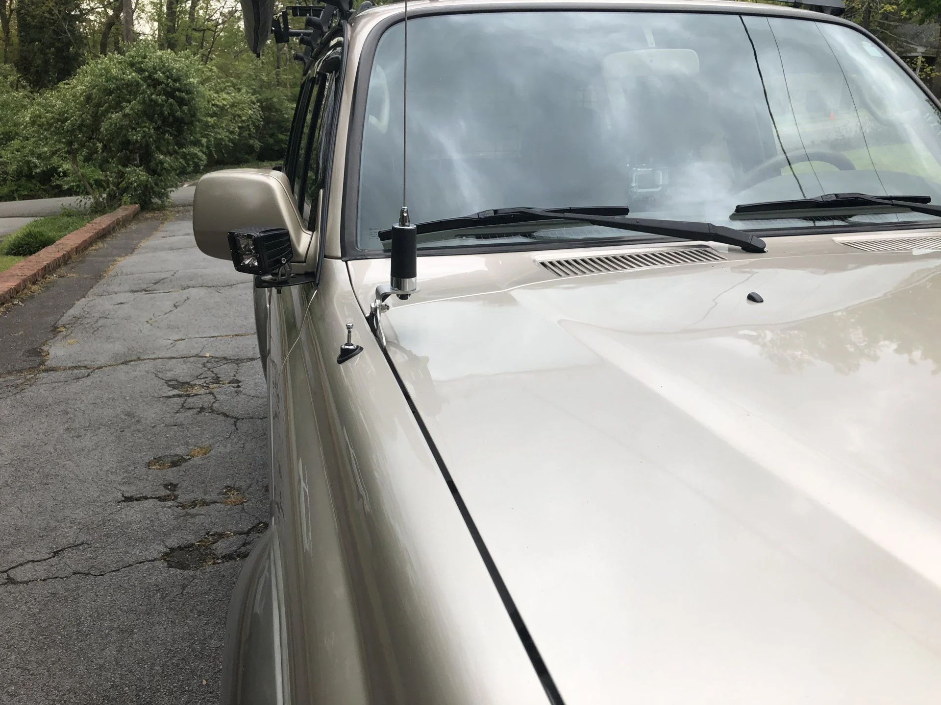

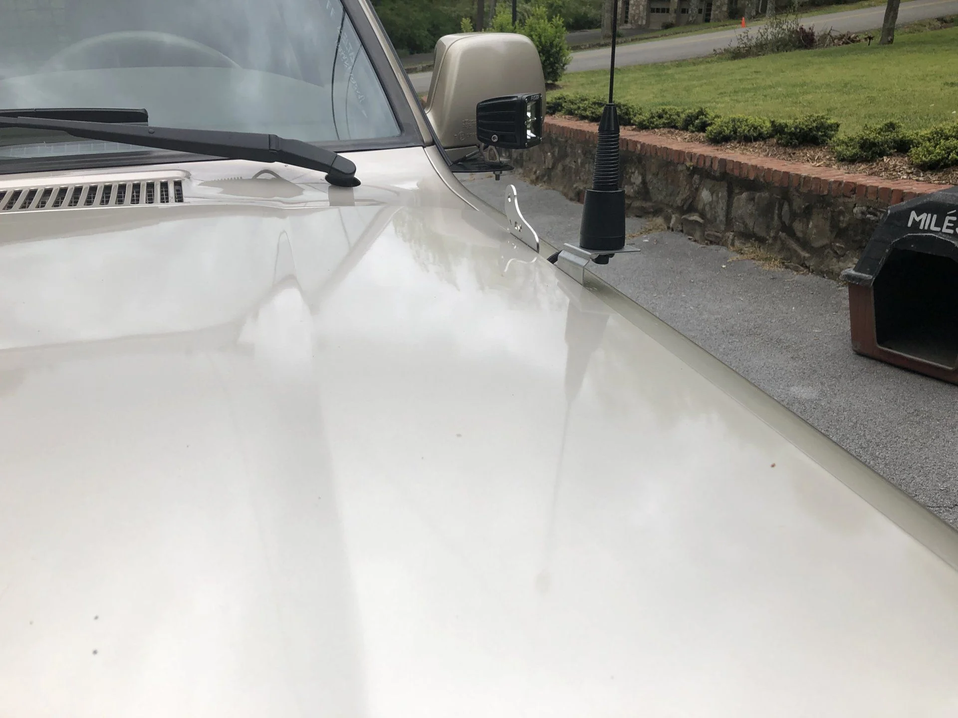

During the quarantine I’ve been working on some radio installs in my 97 LX450. I decided I didn’t want to study for the HAM license and, instead, opted for GMRS and CB. Link to products are below.
I am using a Gamiviti DS NMO Mount for the GMRS and have the Massive Metal Shop hood hinge mounts for both sides.
I’ve decided that I don’t really like these MMS mounts as a location to add lights but will use it for the pending CB antenna install.
My question is about where to mount the antennas. Can they be close together or should I have one on each side of the hood.

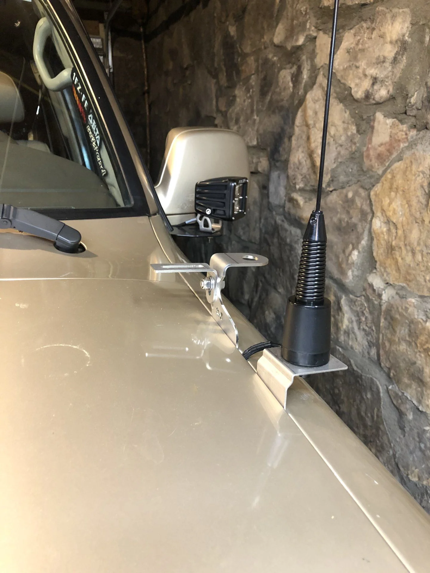

10-4. I have already decided to sell the MMS mounts and I ordered a Gamiviti Antenna Bracket for the PS. Out of curiosity, would could happen if the antennas touched while transmitting?
Power surge could burn out the finals in the radio.

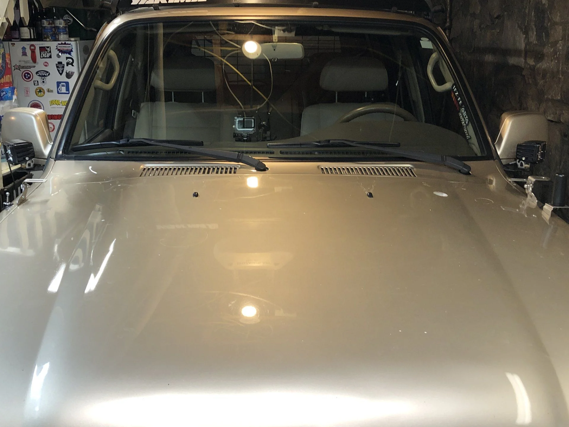

My next question is more about aesthetics than anything else. Please let me know your preference for either the Gamiviti Mount (Driver Side) or the MMS Mount (Passenger Side). The MMS mounts move with the hood and the Gamiviti mounts are stationary.
My 2 cents, I would mount them both on the fender.
