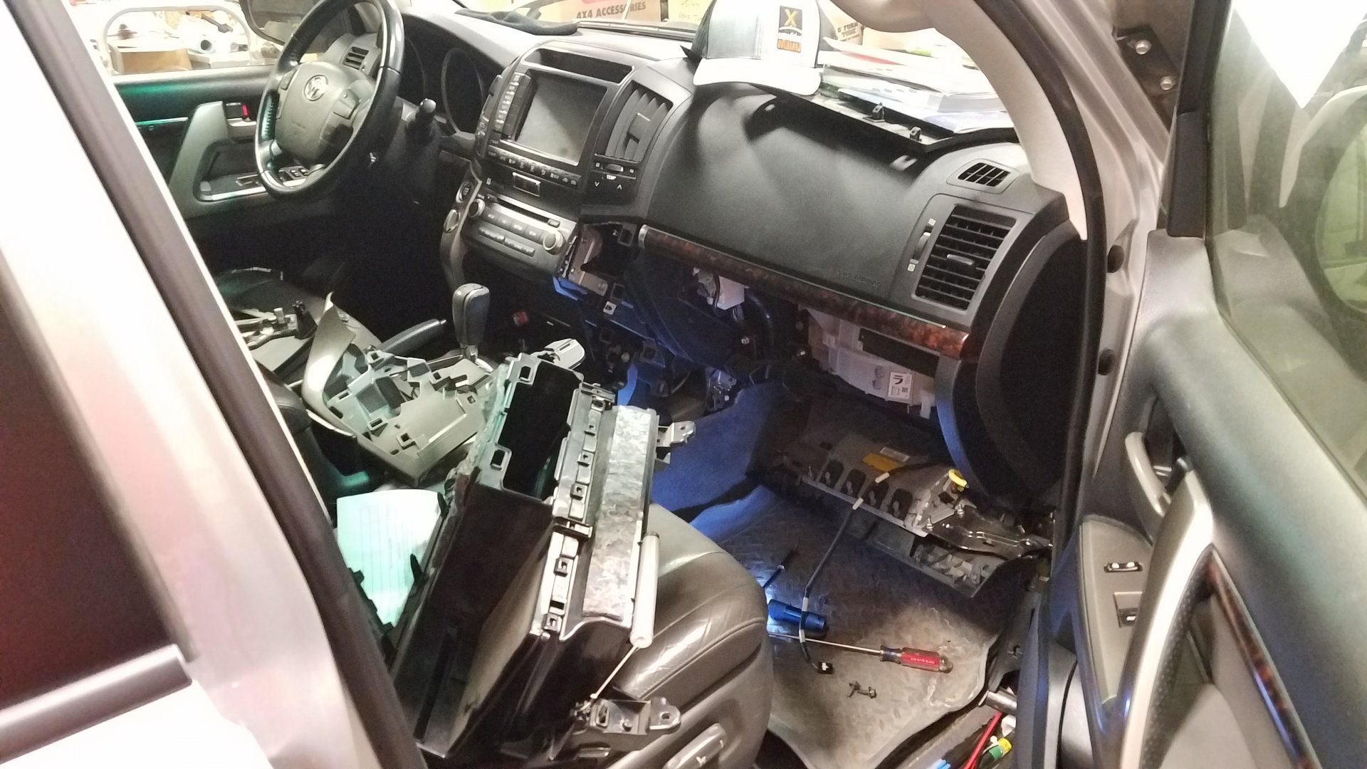

Yeah, so that was a pain. Swapping the glove box door includes pulling the passenger lower airbag and a bunch of trim. They do have glove box lift assist :D

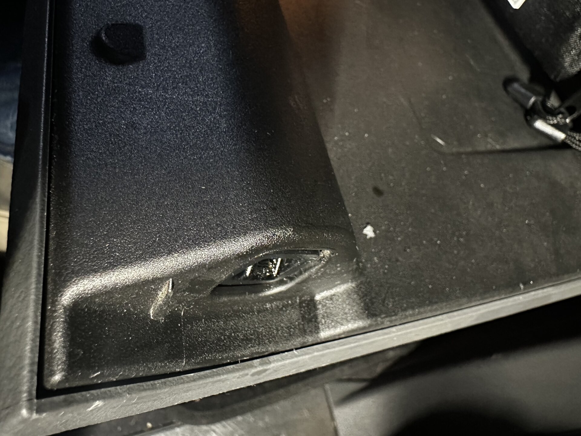

Bump - happened to me today - 2008 was at the shop outside overnight got a bit cool/cold - the in-door latch mechanism got stuck open. Used the house key on my keychain to pry it back out, popped pretty easy, seems like the spring is old and weak and/or gummed up/dirty. Wondering if anyone had success with the repair or cleaning. Looking at the effort required to replace the door - not interested.

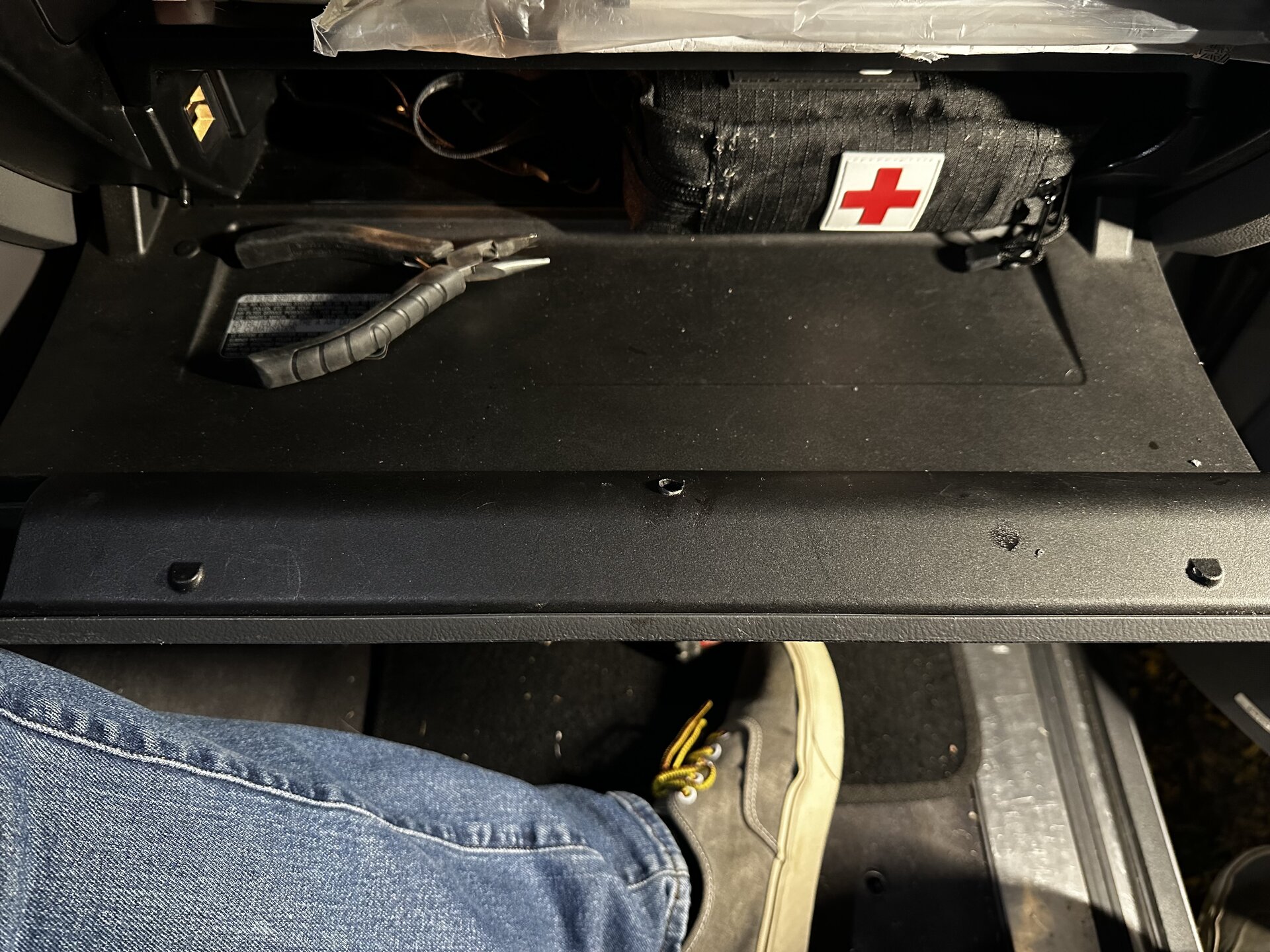

I have a 2009 LX570 and have been frustrated with this issue for quite some time. Thanks to the posts here I decided to dig a little further into this issue. My first thought was to disassemble the halves of the door and heavily lubricate, but the above post about heating up the door was a no go for me. So I decided to move on to the next option, a small discrete hole in the middle of the door. I used a 1/4 inch drill bit, directly in the middle of the inside panel of the door. Upon drilling the hole and looking inside I saw a Phillips screw head. I loosened the screw about 3 turns, pulled the stuck latch to the extended position and while pushing and pulling the latch continued losing the screw until it moved freely in and out on its on. Once I was able to get the latch moving freely I just slowly tightened the screw until I was satisfied with the resistance. Worked like an absolute charm. No expensive new door, no heat and just a small hole on the inside of the door that will never be noticed. I hope this helps anyone else with this issue. Total time, 10 minutes to perfect fix.
A small hole in the middle and a philips screw driver can repair it. I bought a new door so I tore the old one apart.
This is the fix. I added to my post above showing the location of the screw. Your post gave me the information and confidence to try it. Thanks!

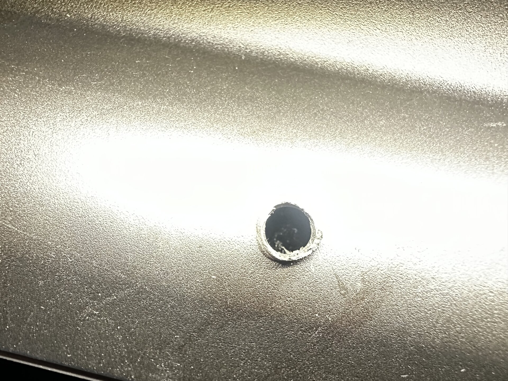

To add to this thread - For anyone afraid of drilling a hole, no worries. Adding a small rubber grommet will make it look good as new afterward. I used a 3/8" drill and capped it off with a grommet from this assortment:

This worked like a charm. 30 second fix. you only need a 6-8mm hole. Kudos to the people who worked this out :)
