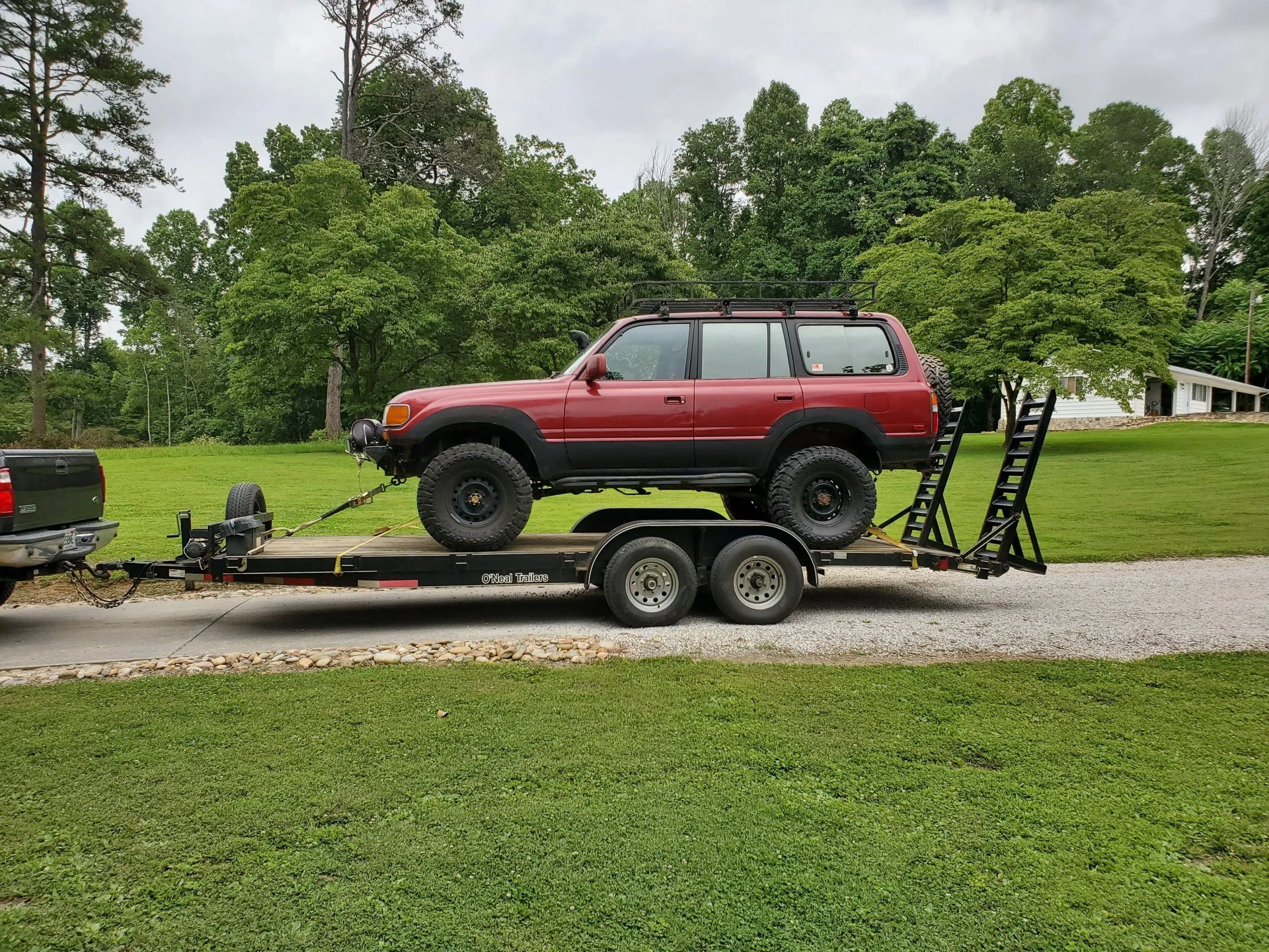

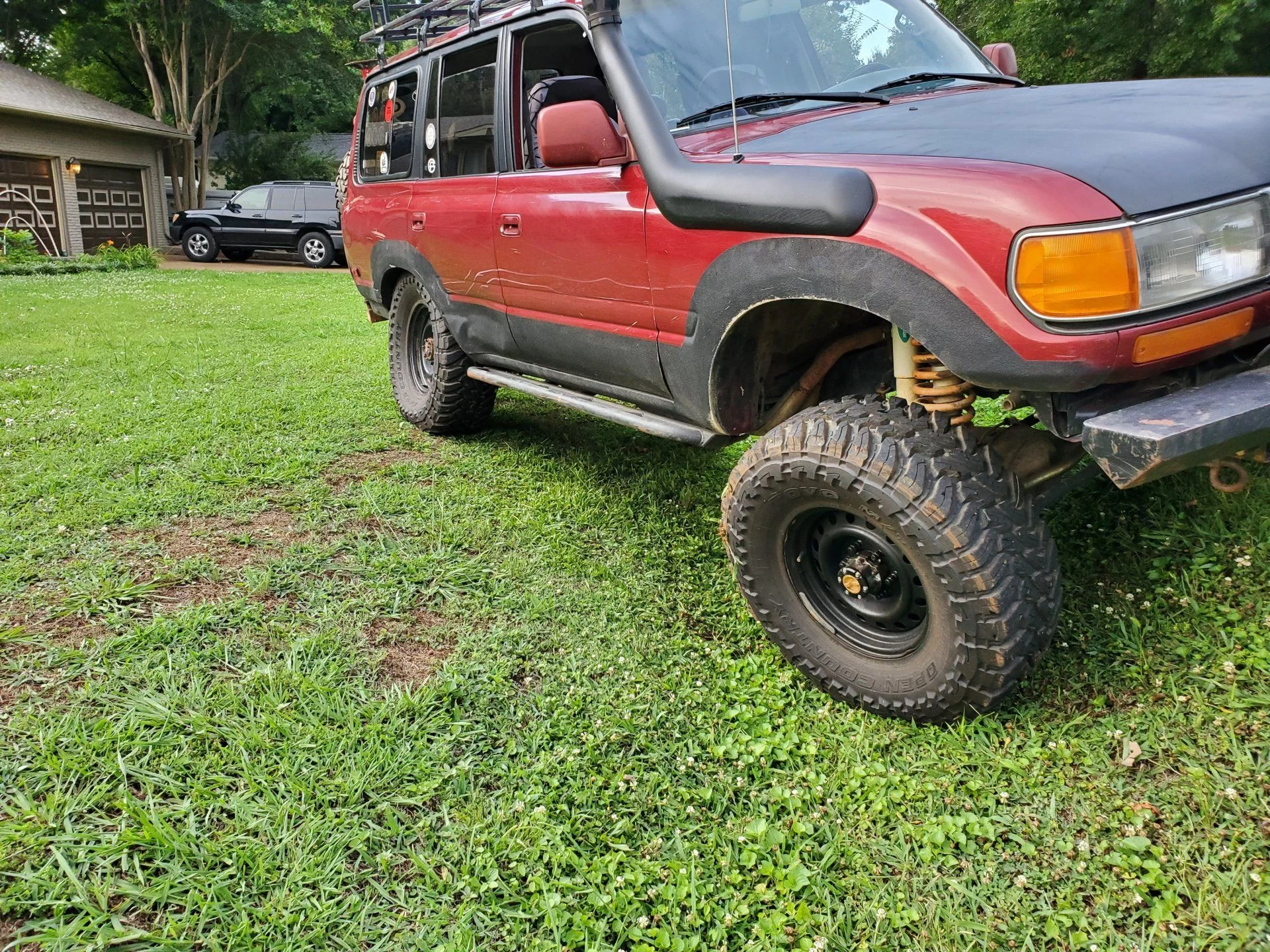

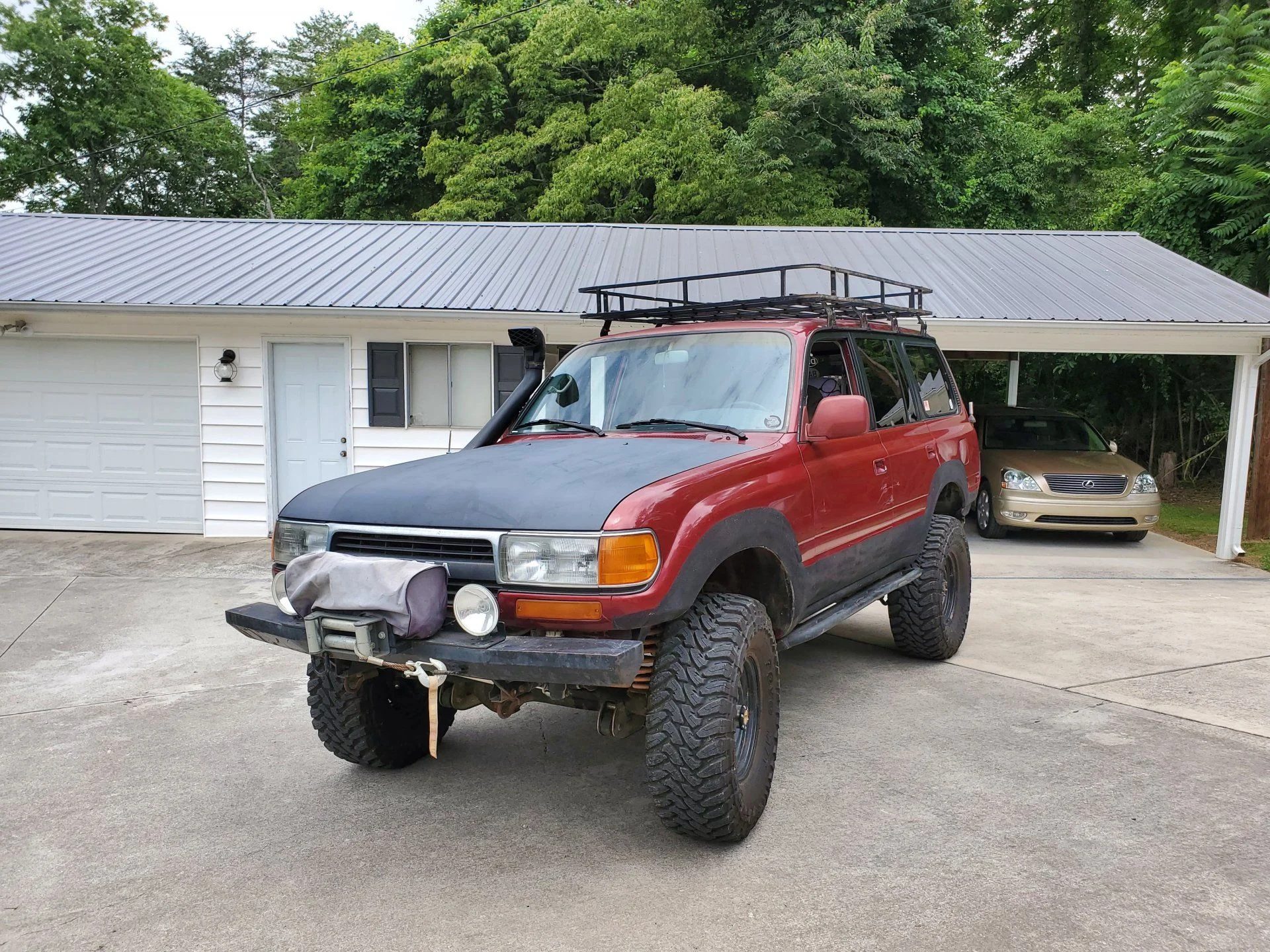

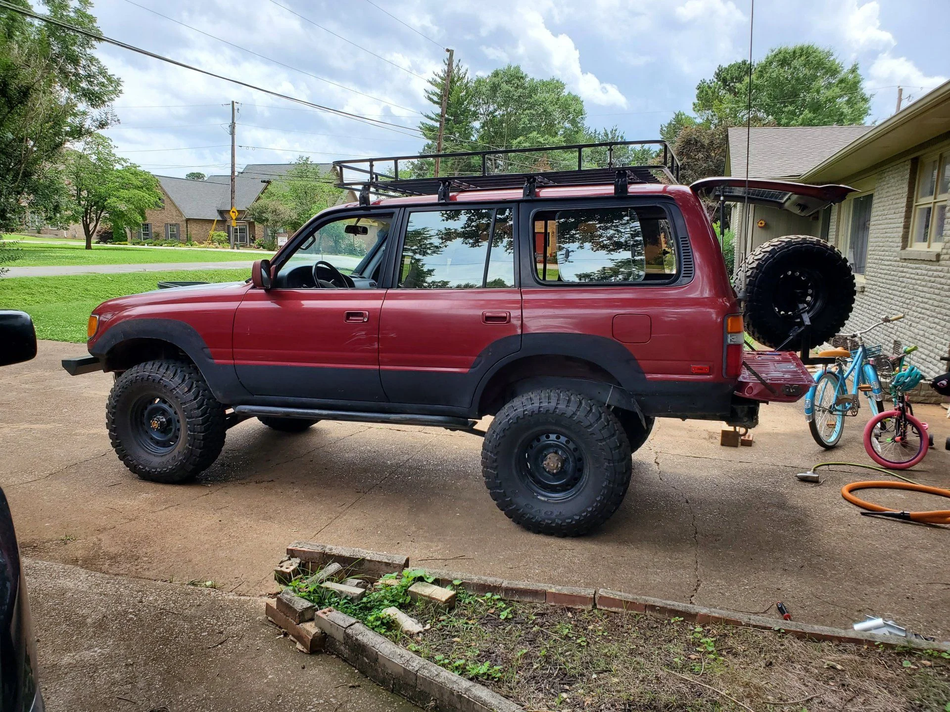

The happy new owner. Ginger by herself, all loaded on the trailer and some poser shots in my ditch once i got her home.

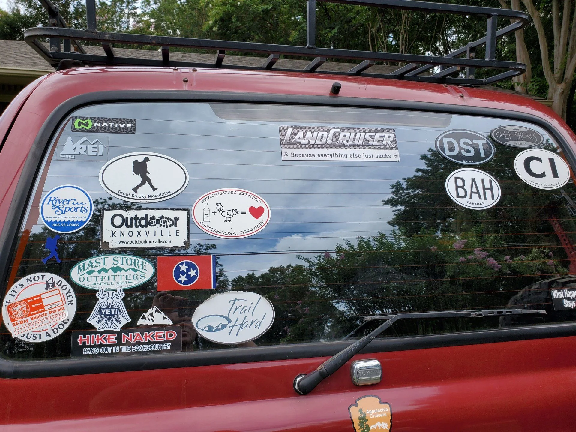

First mod that would definitely cost me 5 hp and probably get me scorned by all LC owners on the web was to remove all the stickers. I am more of an incognito sticker guy... I did have a hard time pulling off all the old GSMTR stickers. Ginger has apparently been to quite a few but it wasnt with me. Left the TEQ sticker only because I want to find another to place elsewhere.

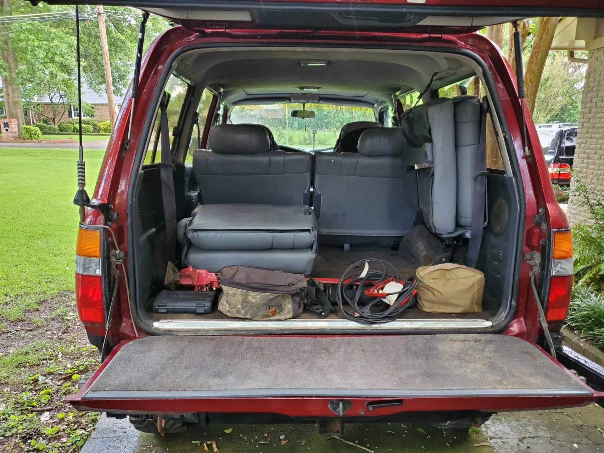

Second mod. remove the drawers and install seats. I have to have space for the damily ( dating family).

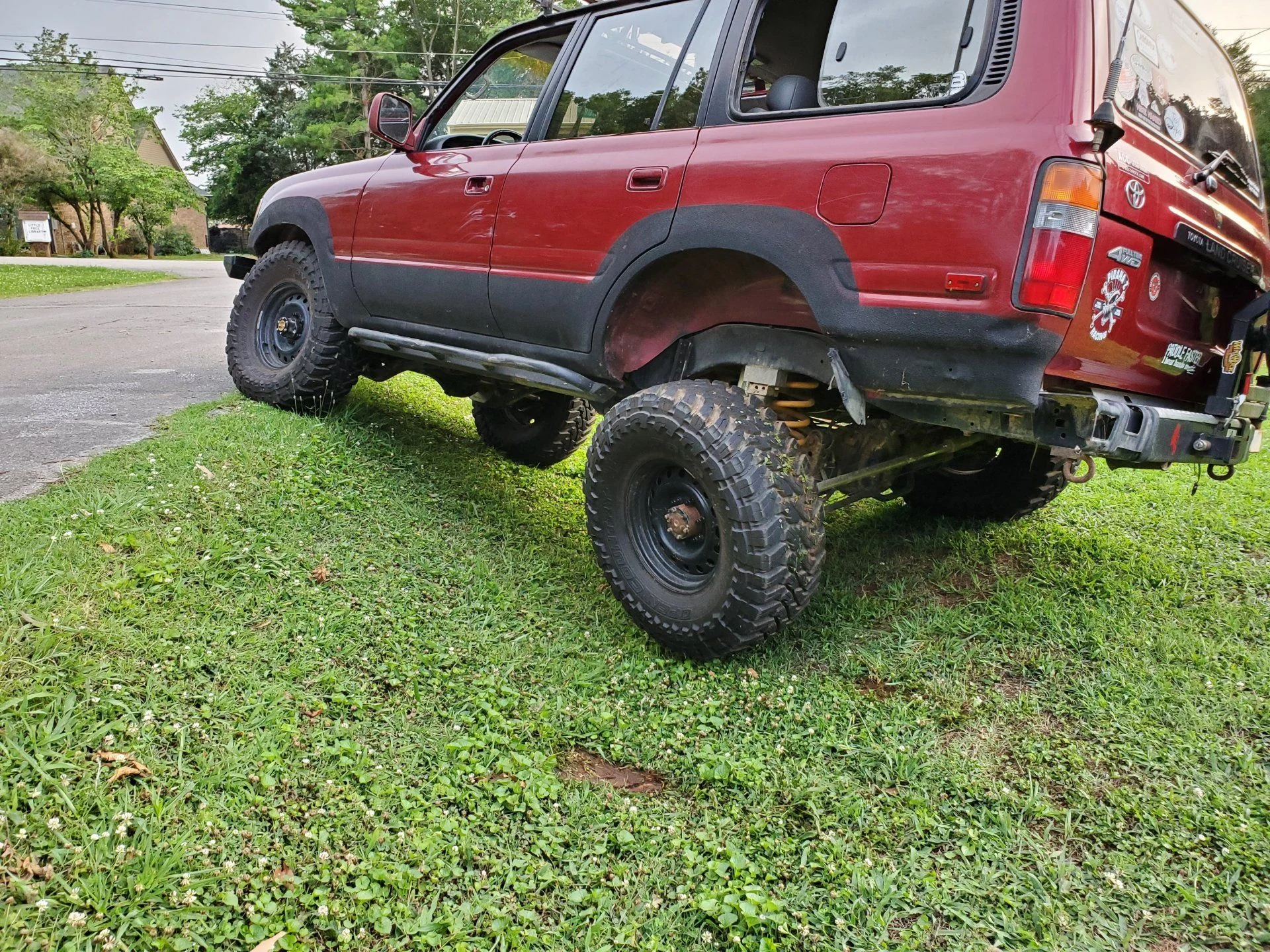

Testing out my stack of gear. Ginger had zero rake with the drawers and a bunch of other stuff in the back. I will roll lighter than that so she has a good bit if rake now.

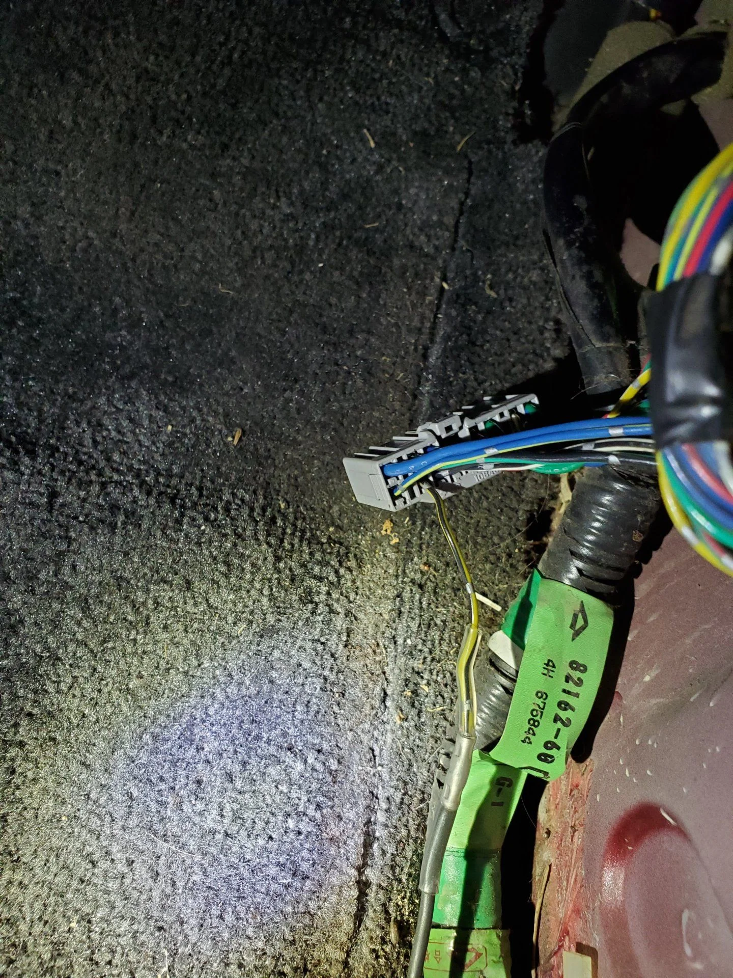

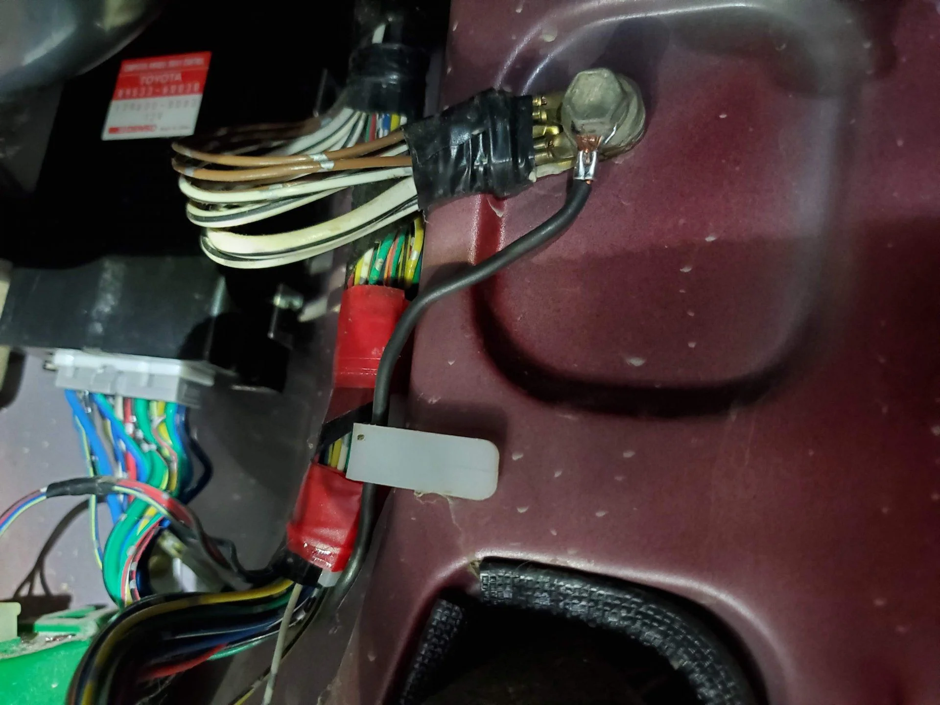

Got bored the other night and went and did the pin 7 and pin 15 mods. Pin 7 mod is covered in great detail all over the place. But the pin 15 mod was a little obscure. If you dont know, it allows the modder to use the rear locker without having CDL engaged. So its only really for the 2wd conversion crowd but when I was a jeeper ( I know sacrilege) there was nothing more fun than locked 2wd low. I call it party mode!
For the pin 7 mod, I removed the pin and put some heat shrink over the terminal, folded it over and zip tied it to the harness.
The threads indicate a different color wire for the pin 15 mod. But I was able to pull the module and identify the pin numbering and pin 15 on a 94 is the yellow wire with the black tracer. You can see the pin 15 location in the pic. Just crimped and heat shrinked a wire with a ring terminal and hooked to the closest ground. Right by the box in the passenger kick panel. And heat shrinked the other end of the wire. Tested and it all works as it should.
The pic of the ground shows the transfer case module in the background relative to the ground.

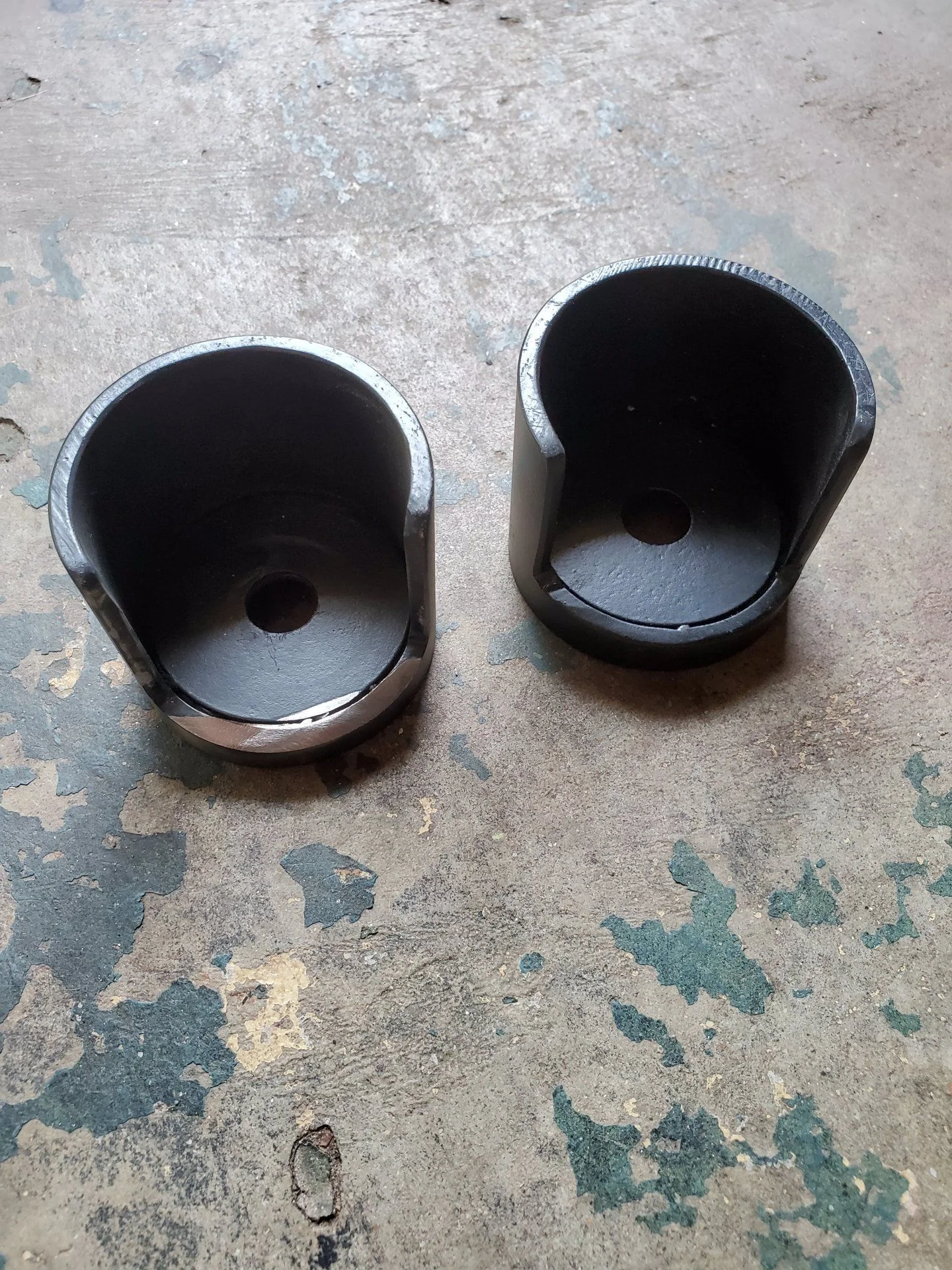

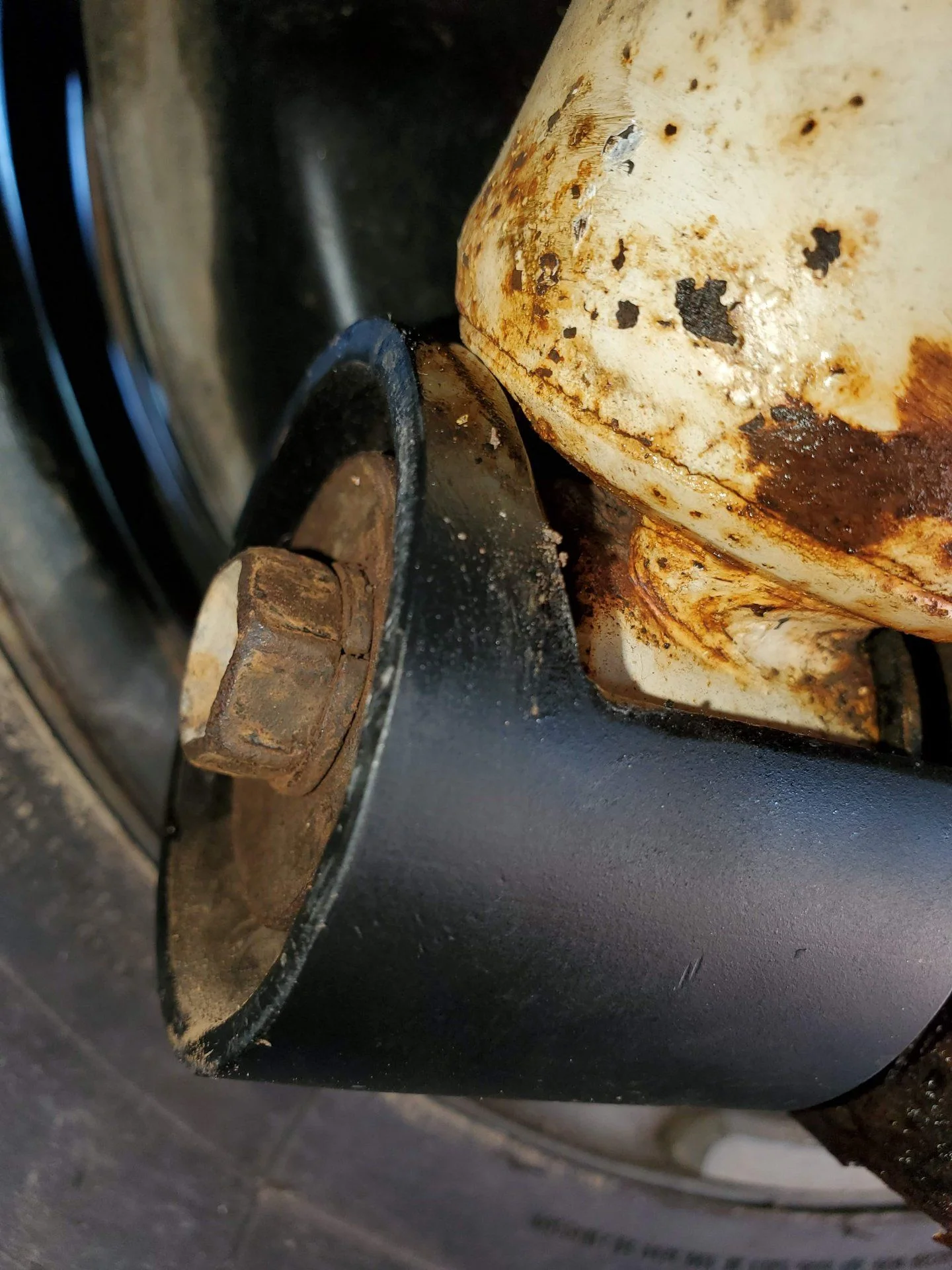

Installed shock protectors. Not sure where they were form. Not much to it but they did contact my Ironman Foam Cell shocks so I had to chamfer the edges a bit to make some clearance. Few runs with the flapper wheel and some rattle can and they were perfect.
Second pic shows contact. Third pic has clearance.

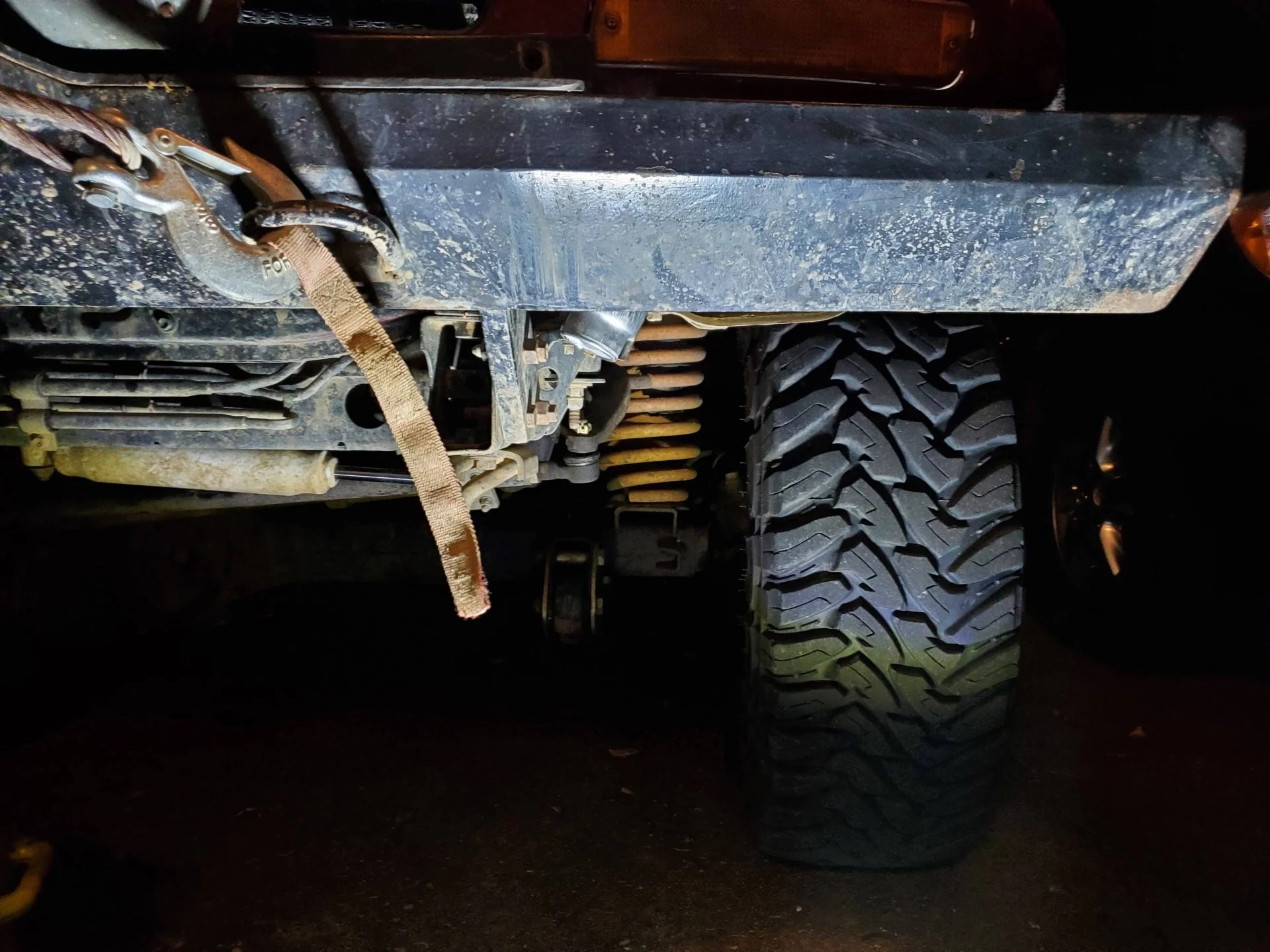

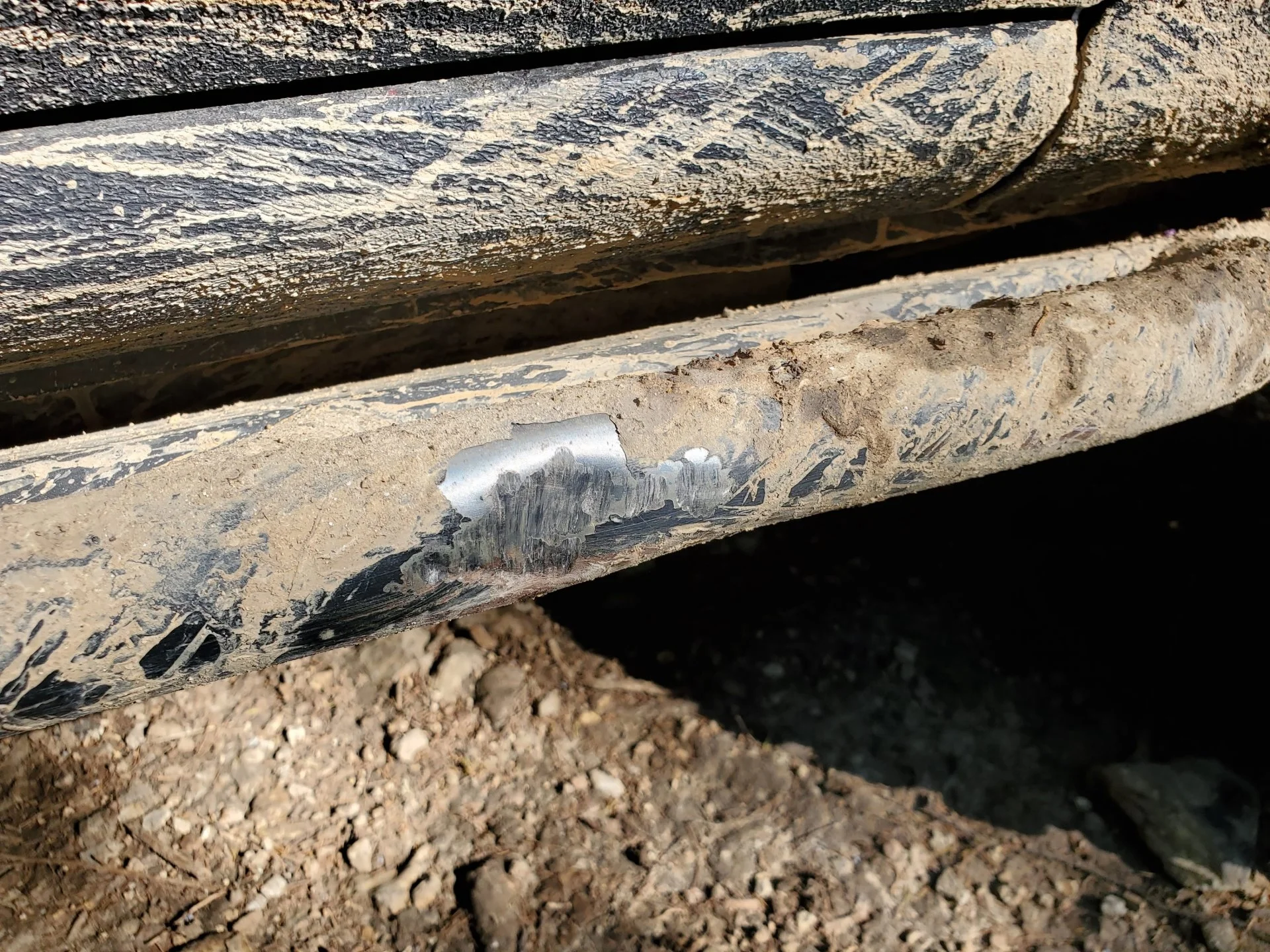

Slider took a hard hit.

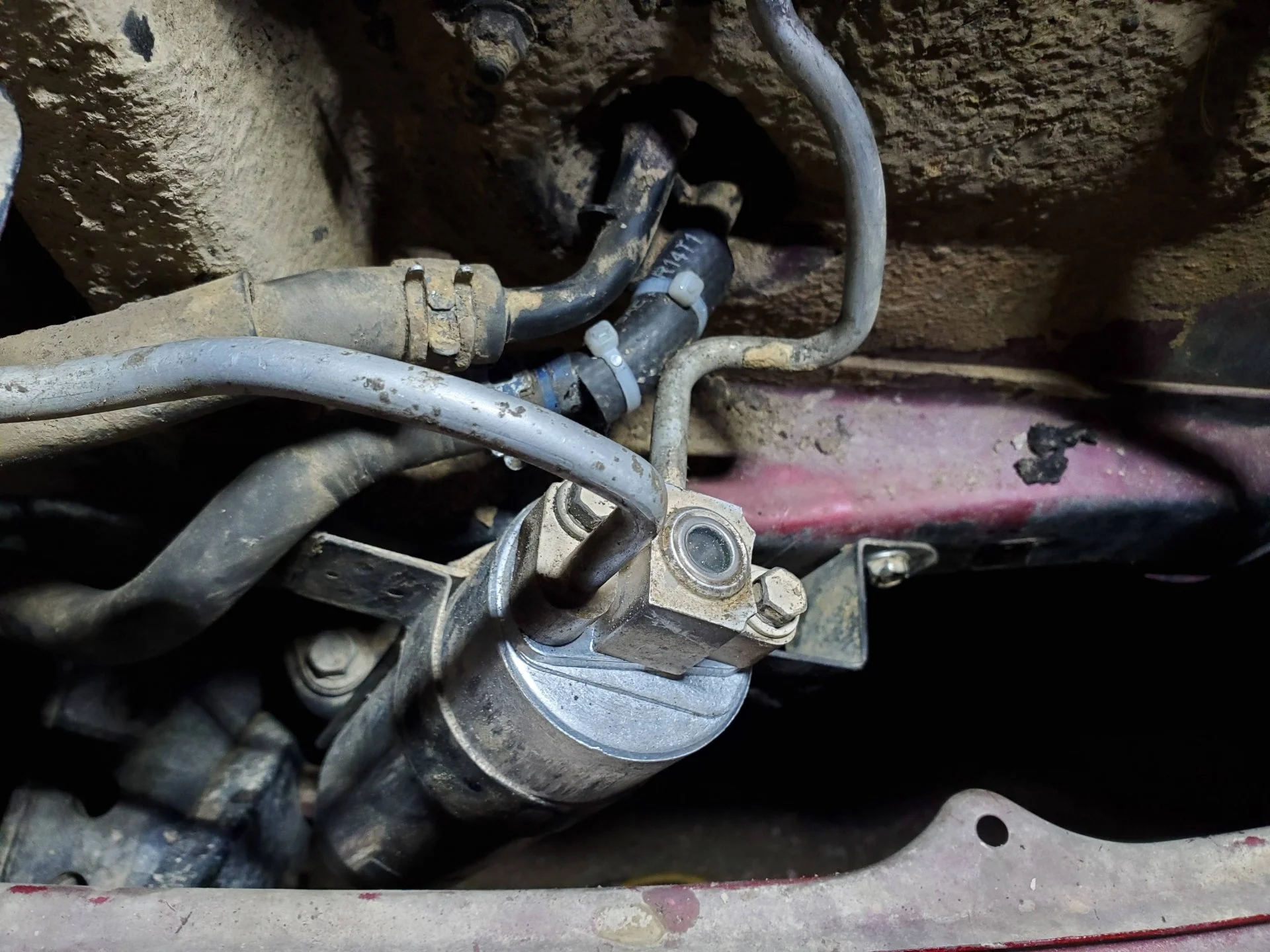

Wanted to keep my AC working so I decided to get the drier up and out of the way. Its tight like gnat bootie but out of the way and not a worry anymore.

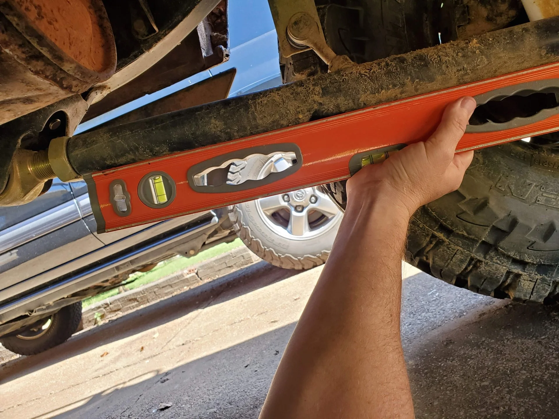

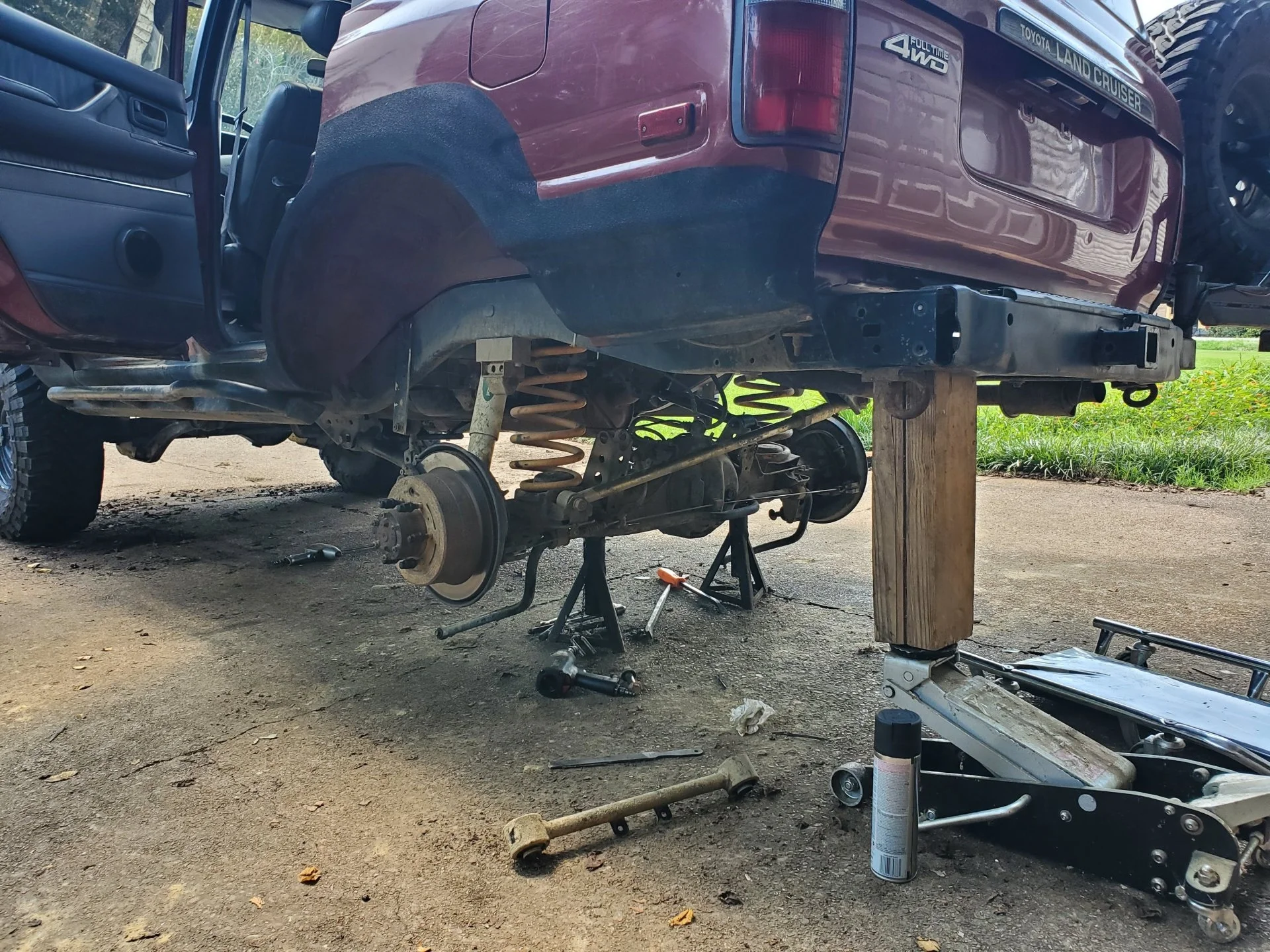

LCAs were bent a little when I got Ginger but I made it worse on that first ride so I decided to upgrade to some Trail tailor Arms. Went with upper and lower to get a little cleaner on pinion angle and to fine tune overall axle location. Also took the rear spacer off to lower the rear and get the stink bug out.
Safety first I promise.
I'm also not big on stickers on my vehicle. I use my Yeti flask for that.
We just need to have an annual " are your motor mounts good" run...
I have them all over the place. Cooler, toolbox, etc. I really just dont like them on the glass. I have been covering the sils in the lift gate though. So you see them when its open.

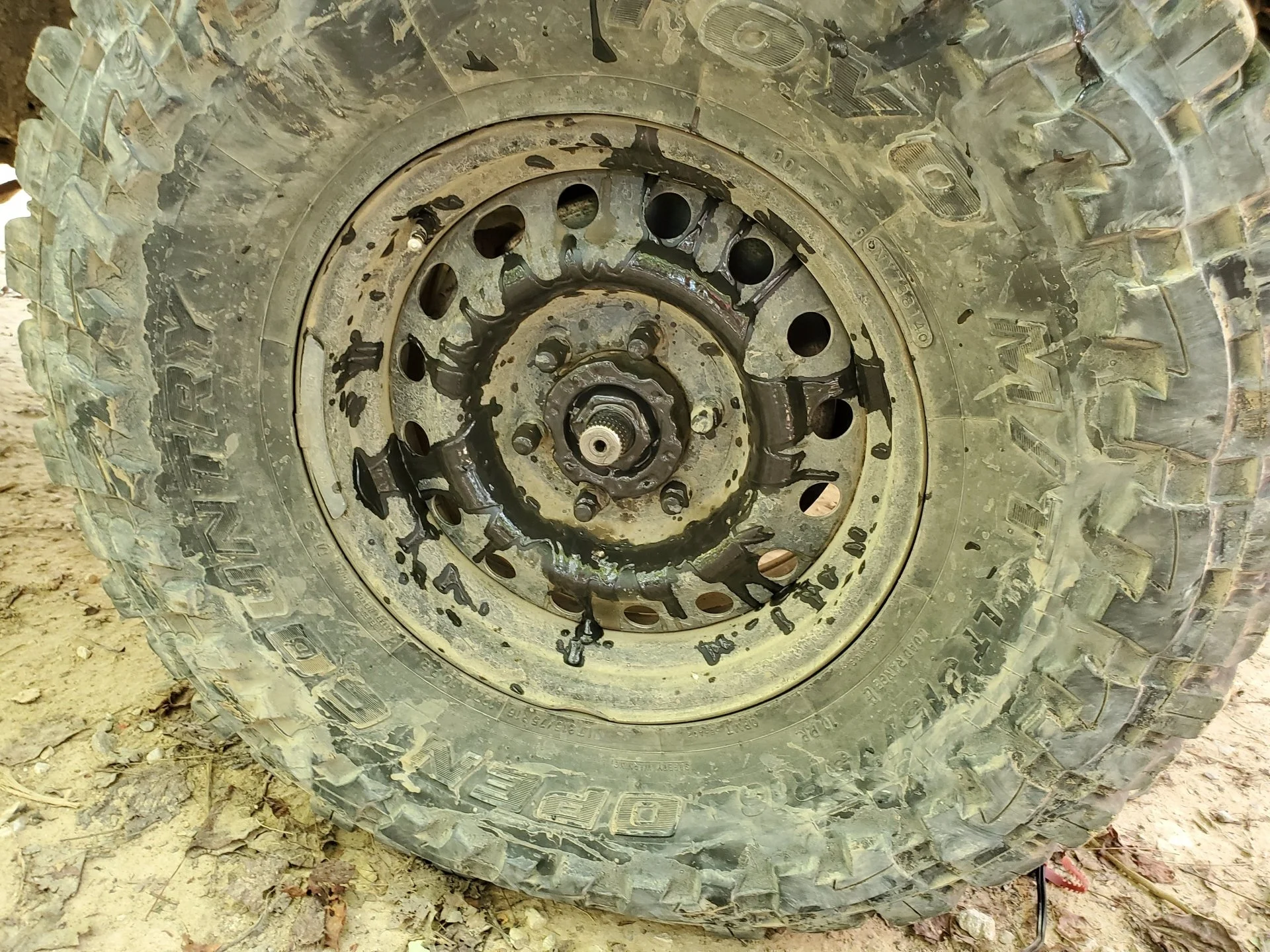

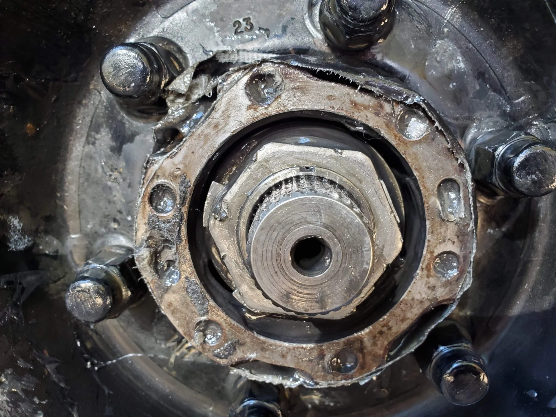

After the MK fun we had we turnd around just a few weeks later and went back to Iron Gap. Ginger held up well to some beating at MK so I was feeling a little bulletproff and decided to push a little harder and try some more difficult limes. And too much throttle :cool::rolleyes::bang:
At the very end you can see the girl picking up hub pieces about 15 feet away.
The carnage...
A little duct tape held the grease in enough to get home. 3 wheeled it the rest of the day.
Good ole hub stud and pin shear action. This one was costly.
In hindsight, I remember seeing some grease leaking out around the hub at one point and thought to myself I needed to check that when I got home. The hub studs are now on my bolt check list for every ride. Expensive lesson.
