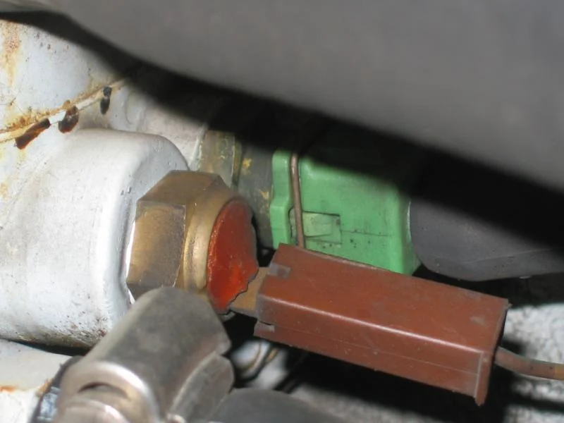

There are two ports in the thermostat housing.
The close up pic shows them.
My questions are:
1) Why are both of them being used?
2) Since I don't care if my factory gauge works any more does it matter which port I use.
3) Are there any other ports I can use?
This is a 3B.
I did a search which lead finding the ports on the housing.
Thanks in advance!!
Tim
I think the brown plug is your engine temp and the green one is part of the glow plug timimg control??
cool thanks for the info....since this is a FJ with a 3B transplant, that function is no longer being used. I have a button I push...
That being said I will probably pull the green one just because....
correct - and you will have to use the autometer sensor.
No problem, just hope the nut fits.....
Thanks again!
Tim
