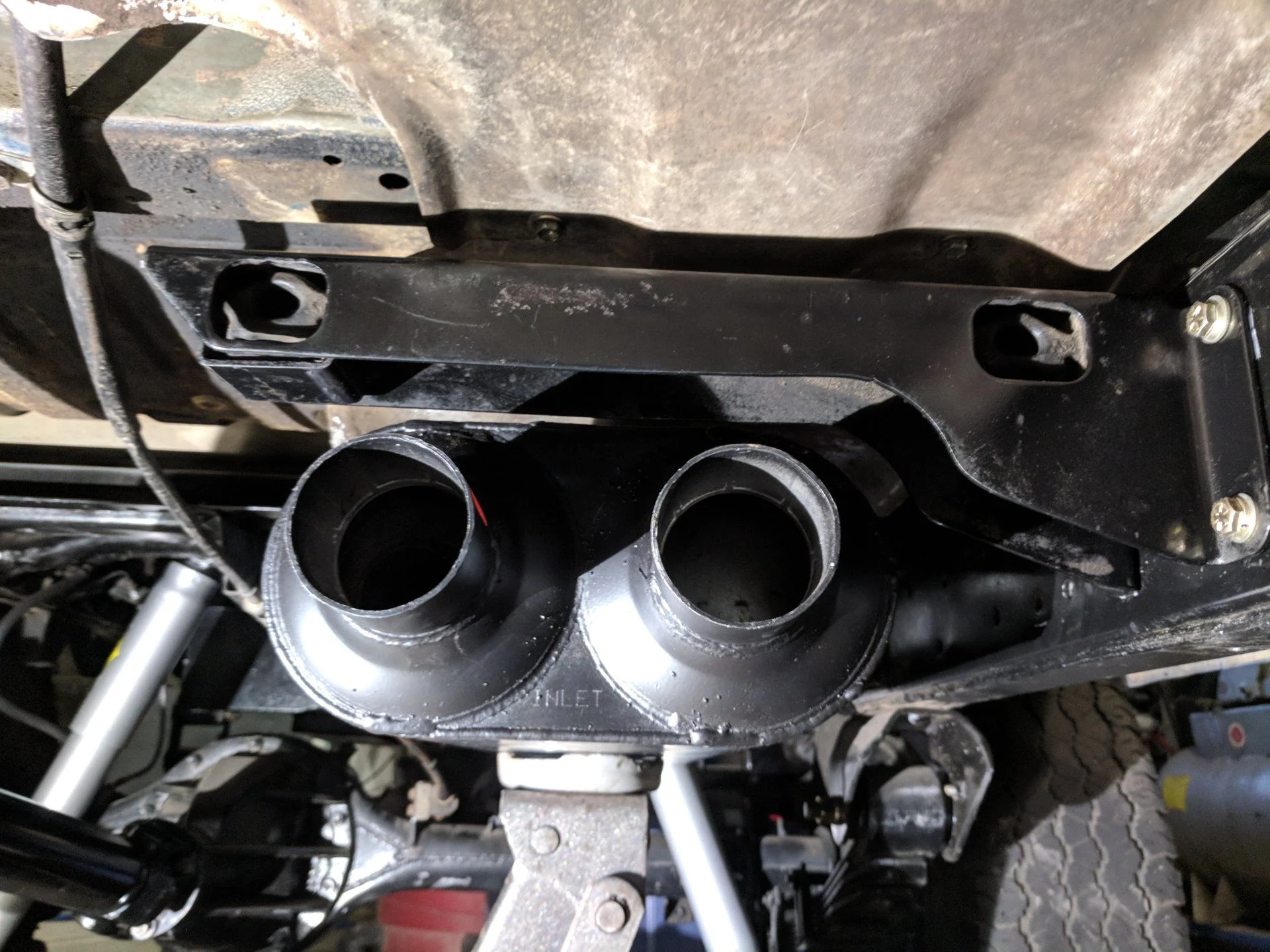

The first step to building the system was placing the muffler. The case is extremely long so I was trying to balance competing demands - you need room up front to make the bend over the tcase and driveshaft but you need room in back to get around the shock and the axle. I wanted to use the factory mounts as much as possible and keep everything high for ground clearance so I put the muffler up into position with a floor jack to see how things fit...

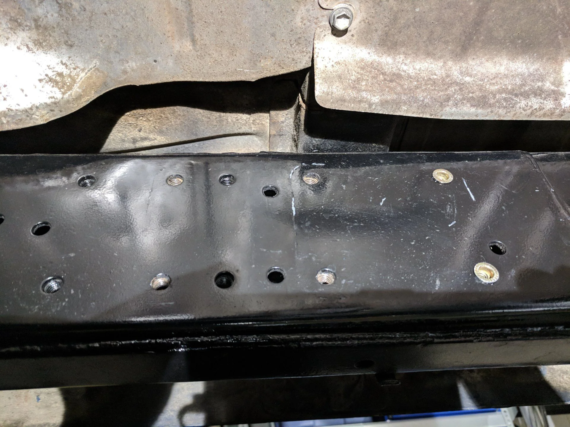

You can't see the fore/aft location in that pic, but using the factory position for the exhaust bracket left me very little room in the rear to make the bend for the tailpipe. Eyeballing everything and lots of tape measure routing led me to believe it would be better to move the muffler a few inches forward. The simple solution to this was to shift the rear side of the bracket to the front-most set of holes in the frame and then add two nutserts, as shown below.
After that was done, I clearanced the back of the bracket a little bit to open it up where the muffler inlets flare to the body so that I could push the muffler as far forward as possible. To make the exhaust itself I ordered a number of mandrel bent J-bends, 45's and 90's from Summit and grabbed a piece of 1/2" round steel rod to make hangers. I ordered two V-band flange kits off ebay to put a disconnect point ahead of the cats in case I needed to remove the system.

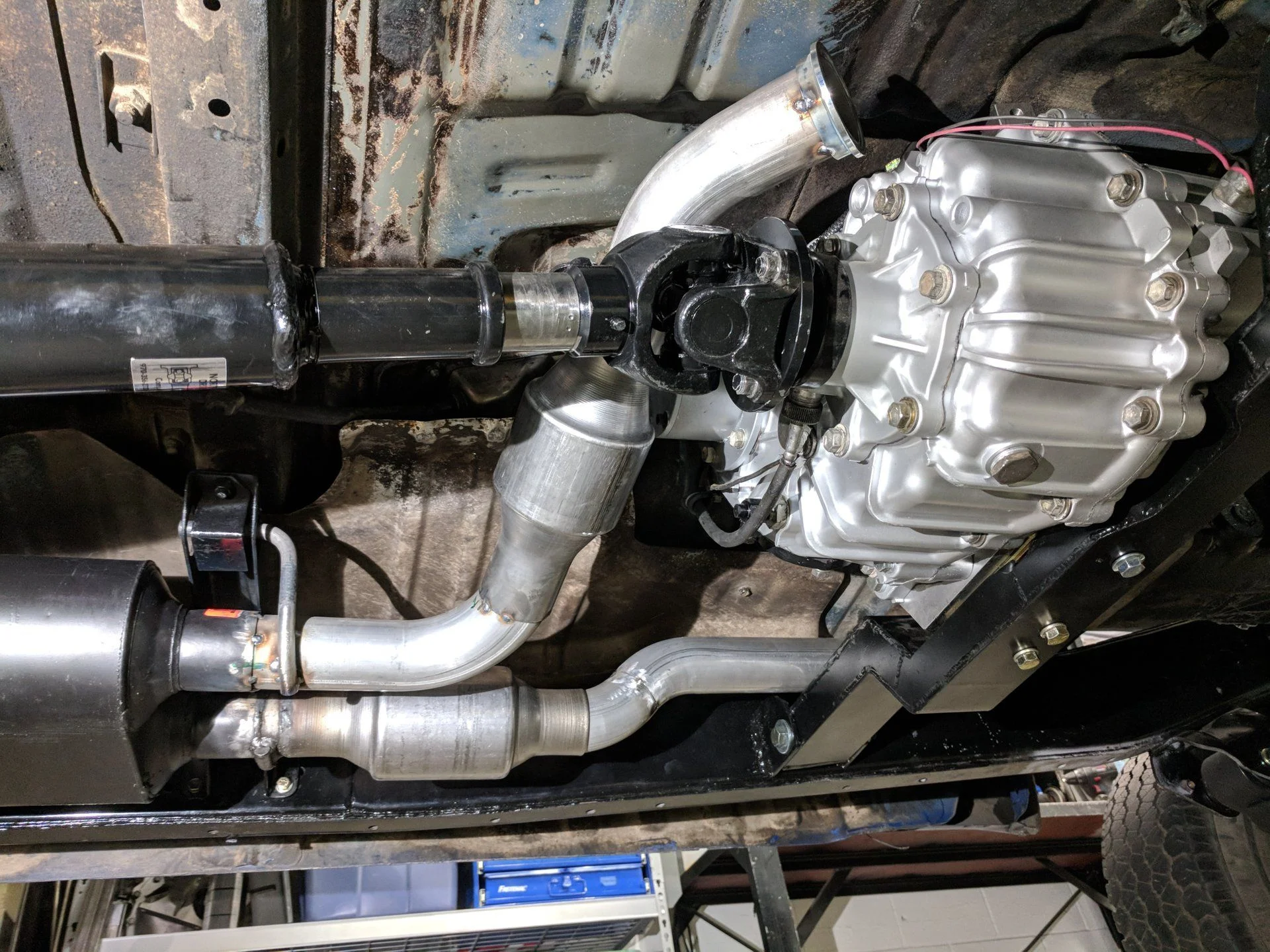

The process started with moving the muffler back into position on a floor jack and then starting to work with the catalyst positions and crossover. The driver's side cat was an obvious fit directly in front of the muffler. I tacked those two together and then bent the first piece of rod to make a hanger. The easiest way to bend the rods is to chuck them in the vice and slip a piece of 3/4 OD pipe over them to get good leverage.
With the driver's side cat in place I then made a small S-bend out of two wedges of pipe to get up and over the crossmember. After that, I started on the passenger side. I could see this pipe would need to immediately start to turn and wanted to place the cat on a cross-wise position relative to the truck's centerline. Using one of the J-bends I came forward out of the muffler and turned right and up to get the pipe going up over the front U-joint. There's no magic to this fitting process, but having a bandsaw and a few extra hands helps a lot and making small cuts to inch your way up to the right position is certainly a good method, these mandrel bends aren't cheap. In front of the passenger cat i used a 45 degree bend and started to sweep around the transfer case to get towards the manifold. I put my v-band flange at the front of that 45 for the disconnect figuring I'd be able to wiggle everything out if I could break the connection there. Tacked together it all looks like this...
The forward extension pipes from there were pretty simple. Ideally I would have been able to run just a straight section with a 45 degree bend up to the flange, but both required a small bend mid pipe. On the passenger side I had the local exhaust shop put about 5 degress of bend in it using their bender. On the driver's side I put two shorter pieces together and put the slight bend in myself using a small wedge of the mandrel pipe. Here's a later shot after the truck was on the road showing the forward section installed...
The factory heat shield does a good job protecting the floor from the driver's side cat. The passenger one is higher up and close to the floor so I added a piece of stainless that you can see in the above photo for a little extra protection. It has a double 90 degree bend to make a flange that rests on the body crossmember and then I put nutserts in to hold it. The front position is held on what used to the heater pipe mount. With the truck driving now I've had no problems at all with heat in the floorboards.
Here's a final shot of the front section sitting on the shop floor, you can see the front pipes also have the O2 bungs now installed.
Is it just the angle of pictures or are the cats different lengths?
Mandrel systems always look & flow so much better than crimp bends...nice.
Good eye! The cats are the same part number but the cans are a little different, the driver's side can is a bit longer. The brick inside is the same dimension so there seems to be some gap in when they were produced. Interestingly, the one on the passenger side appeared older and after two days of driving the brick broke apart. I called Flowmaster and they replaced it under warranty, the replacement part looked like the one of the driver's side.

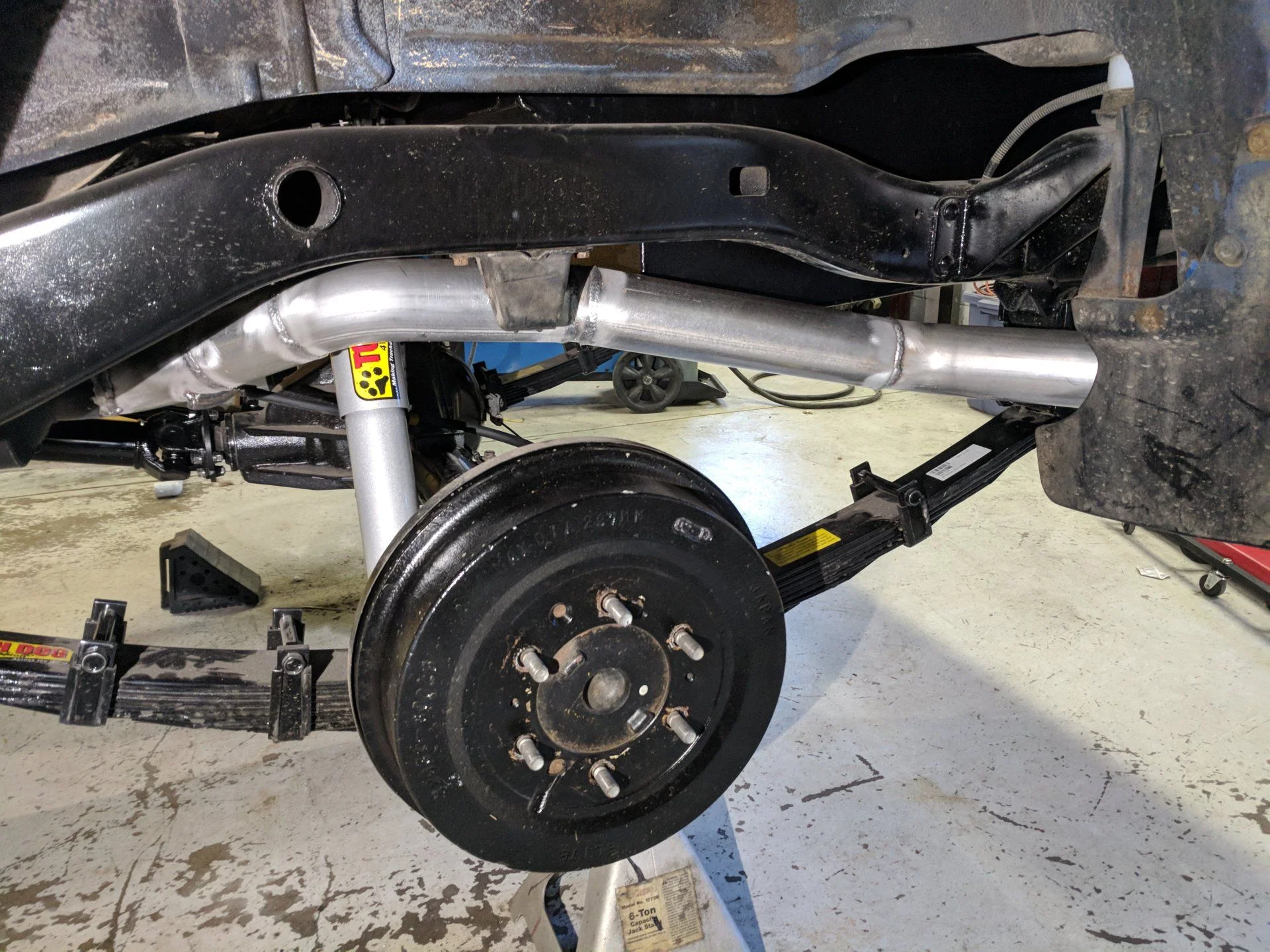

The tail pipe was last and not actually as difficult as I expected. The 3" mandrel bends aren't cheap though, so take your time if you go this route. I ordered a J-bend, a 45, and a straight section and was able to get it done with just those parts. With my 40 gallon long range tank the tightest part was getting the fit between the front LH corner of the tank and the leaf spring. Again, a few extra hands helps a lot and slowly working up to the cuts and angles. Here's the best shot showing the installed routing, I think it's pretty good and balances all the clearance requirements (spring, gas tank, tire). You can just see the bottom of the hangar on the left side, it curls around the pipe and goes up to the factory hanger location.
Here's a shot of the system on the shop floor after final welding...

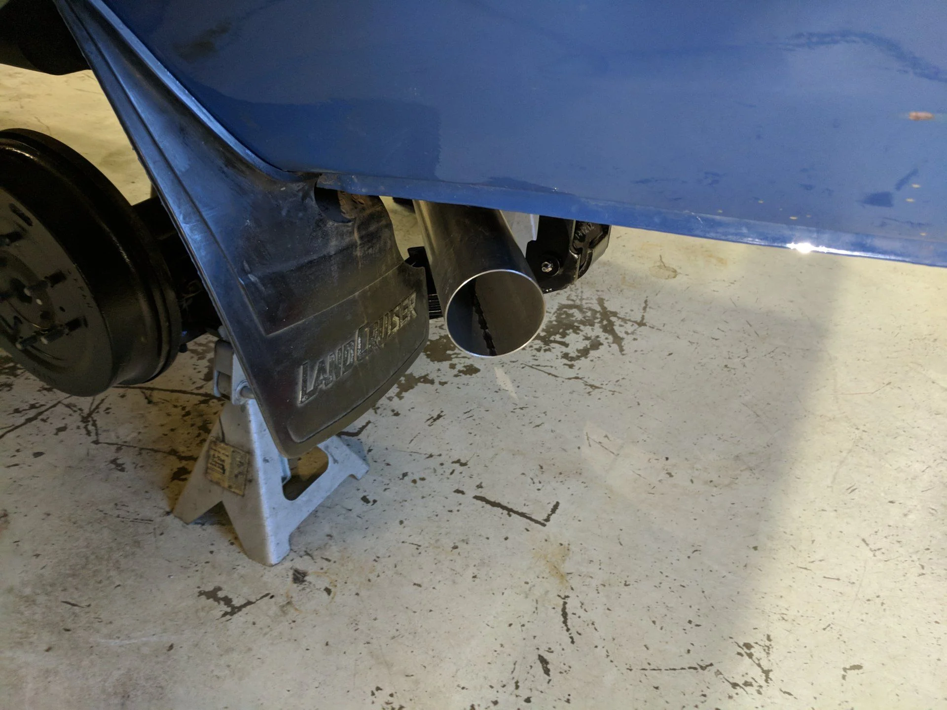

And the tail pipe outlet where all the happy V8 noises escape...
I'm getting ready to build rocker protection as part of my rear bumper setup so later I'll have some photos as to how that tail pipe fits with the armor. I tried to keep the pipe outlet as far forward and high as possible to avoid rock bashes when out on the trail, we'll see in a few months if I'm successful.
