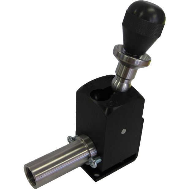

No familiarity with the LC200's locker, will a detent or a position lock be required for either or both positions?
I know that OX had to design in some float as their first generation shifter design was fixed at both ends of the lever's motion, and that caused some problems that took a while to show up. A friend has one of their very earliest Dana 30 lockers and had the first gen shifter. He liked and had no problems with it, but they tracked him down and replaced it with the second gen shifter (excellent CS!).
Seems like once you can effect the lock/unlock with a cable that you can then actuate that cable with lever, an air cylinder, a stepper motor, or even a linear actuator depending on the level of complexity that you require.

@ntsqd a lever like this would be nice but atm I didn’t find one like this here in my region. Especially in this size.
Atm I ordered one of these

@ntsqd
a extra cylinder, actuator, motor or something else would just bring me back to what i had bevore. I mean the rear diff lock is something you just need all few years with the 200 also in heavy wheeling.
What could be easier than just push the switch (the upper picture) by hand down when I need this.
This fits perfectly for a Africa-Version LC200 manual shifter ;D
My thinking is that with the cable that any such more complicated actuation method can be inside the vehicle out of the muck and dirt. I went direct air with the soon to be deployed OX locker in my FSB, but if it gives me trouble I'll be ordering the shifter that I linked and a cable.
