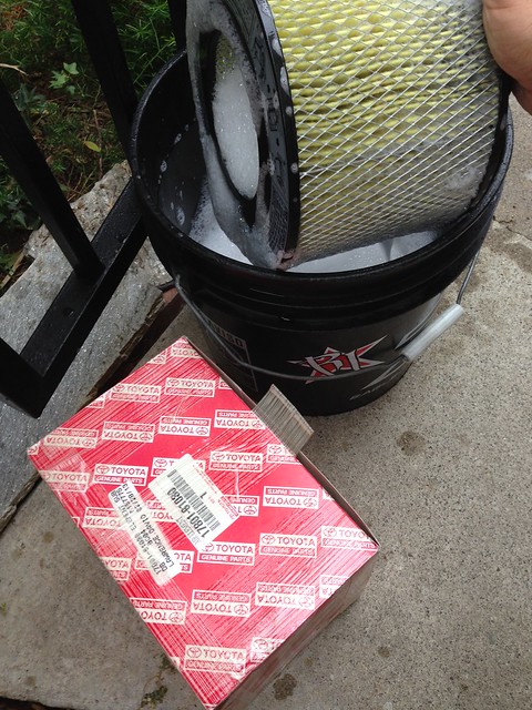

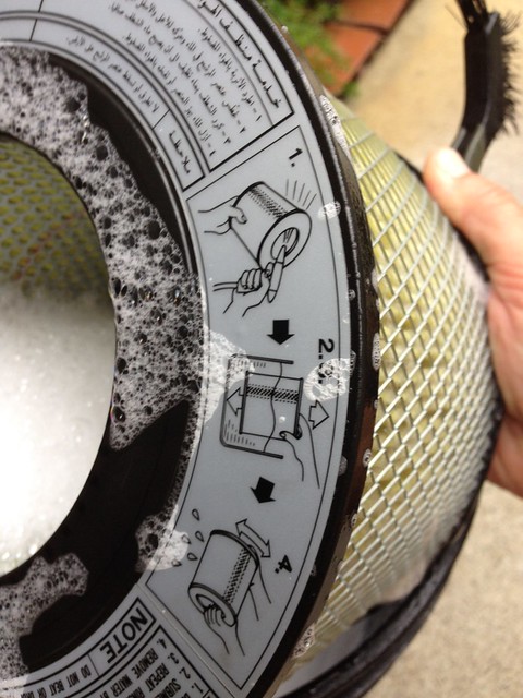

Not sure if I have posted this before on the fact that the factory Toyota filters for the 80-Series are WASHABLE!!!!
I've purchased two of the factory filters and taped up the flimsy factory box so I always know which box is the ADV80's filter. This way I can swap it once I'm back from dusty trips. When you wash one, it does take a while for the filter to dry even when you blow it out with the compressor. Or at least I want to make sure it's dry. I learned this trick of swapping filters from my rally days in that I would have several filters and would swap them after each stage. When you are running a production class vehicle, clean air is everything! For the ADV80, its a convence and preventative maintenance and with 245,000 everything counts!

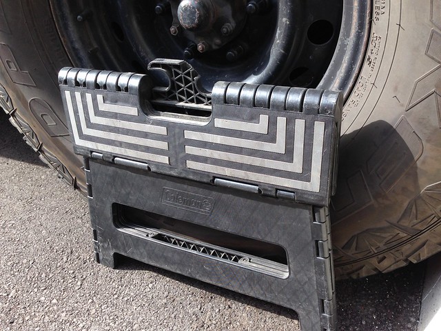

Side note on working on the rather tall engine compartment and my height challenged reach with 29" inseam requires some vertical assistance!
This Rubbermaid step has been a nice addition to my kit!

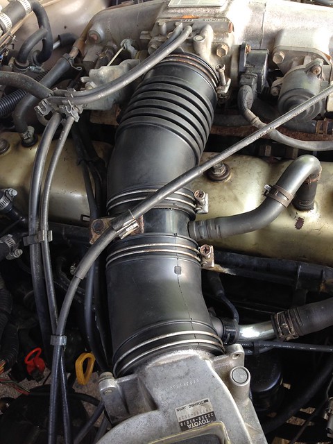

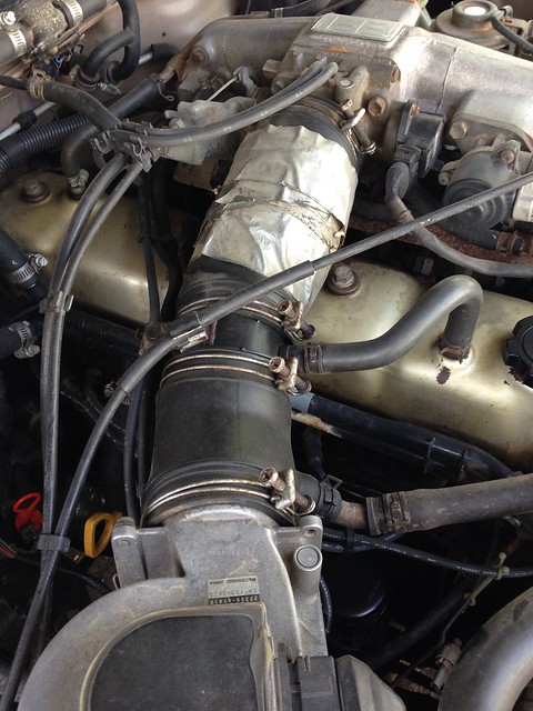

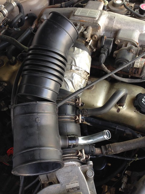

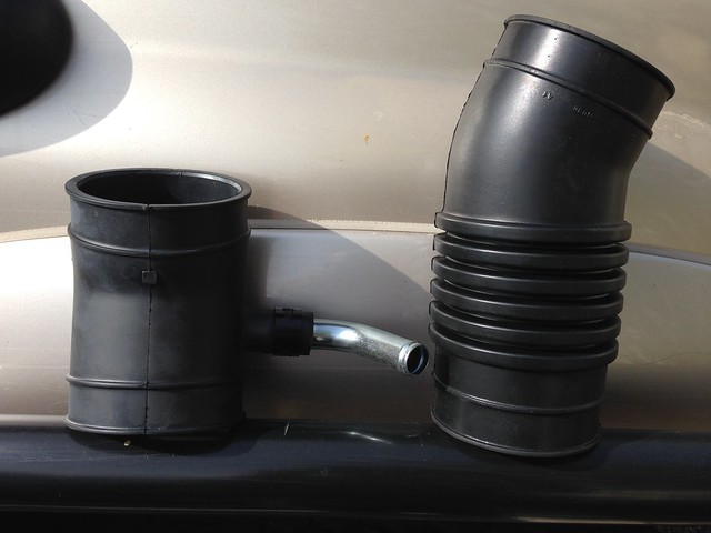

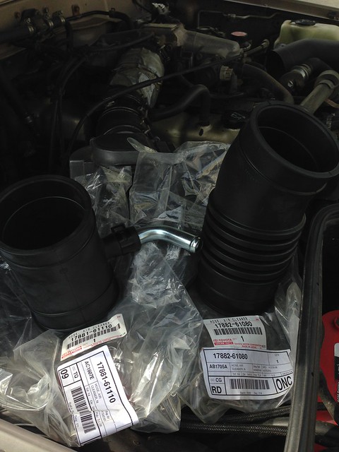

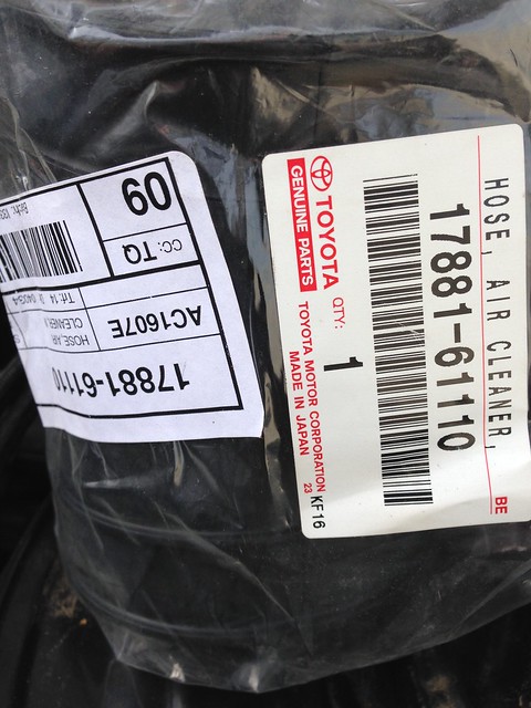

FINALLY getting around to tackling this mess of an intake!

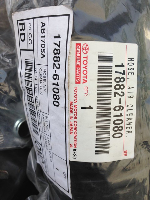

Got some factory replacement items!
17881-61110 is the shorty tube
17882061080 is the corrugated or flex tube. If you only change one, this one is the most important.
These items are going to look way better than the 100MPH duct tape, but better yet will PERFORM way better! Heat just makes these RUBBER items BRITTLE PLASTIC over time! If you have your 80-Series long enough, you are going to replace at least the corrugated tube! I thought best to replace both while I was sorting it out.

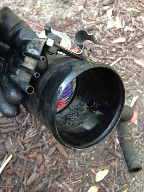

As you will already know or find out, there is a metal inlet tube in-between the two rubber inlet tubes and I pulled this out to clean as well.

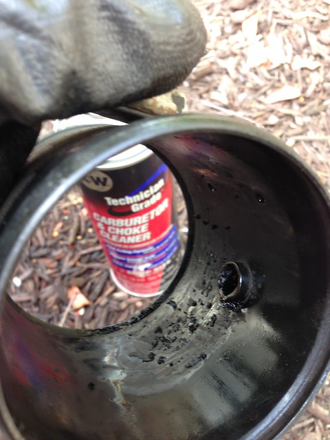

I used carb cleaner to blow out the side inlet tube. lots of crust and buggers.
More to come...

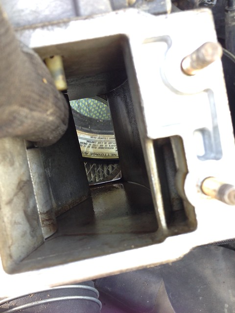

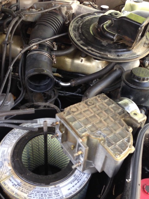

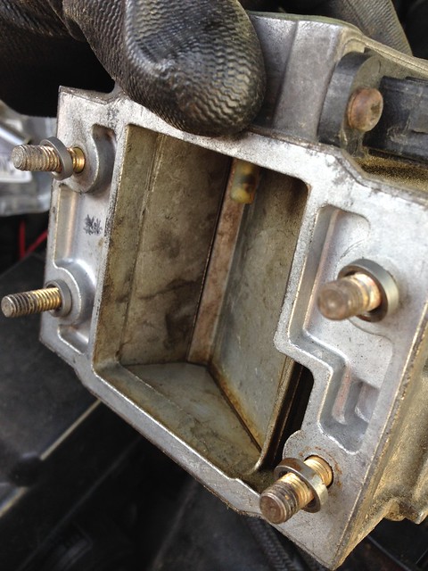

While I was in there I may as well clean out the mass airflow body.
This is the inlet side and as you can see, it gets "dirt-dursty-crusty!"
PAY VERY CLOSE ATTENTION WHEN UNBOLTING THE MASS AIRFLOW SENSOR FROM THE AIR BOX COVER AS THEIR ARE SMALL SPACER WASHERS BETWEEN THE TWO! SEE THEM IN THE ABOVE PHOTO. It is very easy to miss these little suckers and you will be cursing and chasing them down the driveway.
Funny how dirt builds up in here. Make sure you clean it all out. I typically try to spray in the direction of airflow. Just make sure you take your time and spray spray spray! You are in here, so may as well do a good thorough job!
Button it all back up and looking nice!

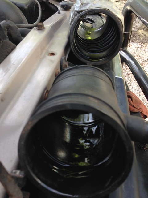

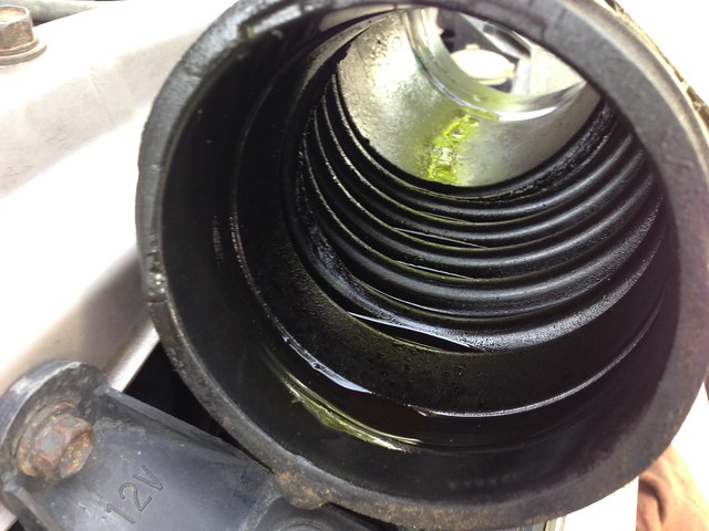

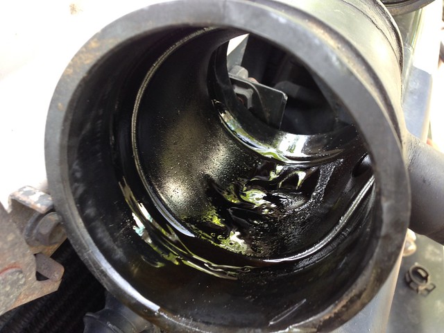

Now, a little discovery… As you can see:
These are the air inlet tubes that I pulled out and it is obvious that I have yet to slow down the oil breathing 3FE.
Back in my post #302 regarding PVC Oil Catch Cans, there was no clear-cut instructions for the 3FE engine. Here is a link jump back to the threads I saved from 'MUD:
https://forum.ih8mud.com/threads/gcrad1s-1992-adv-fj80-land-cruiser.233037/page-16#post-8940562

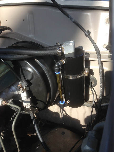

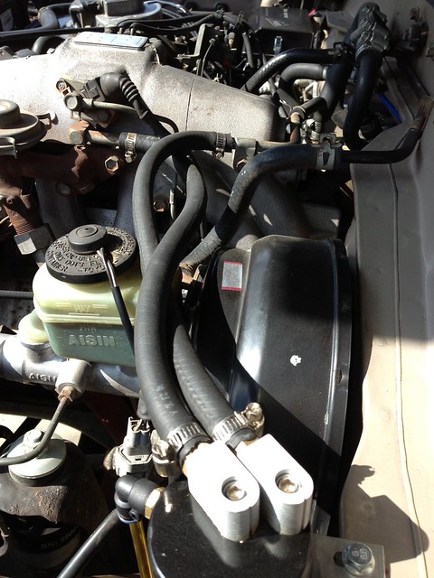

Moving forward from that old post, I have taken one small baby step forward:
I've added this oil catch can located on the back of the valve cover as it ported directly into the intake manifold. It is catching oil, but it does not seem to be the major contributor on inlet-Valdez.
I now know it is the PCV valve on the front of the valve cover and will put another catch can their.

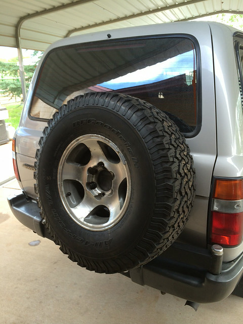

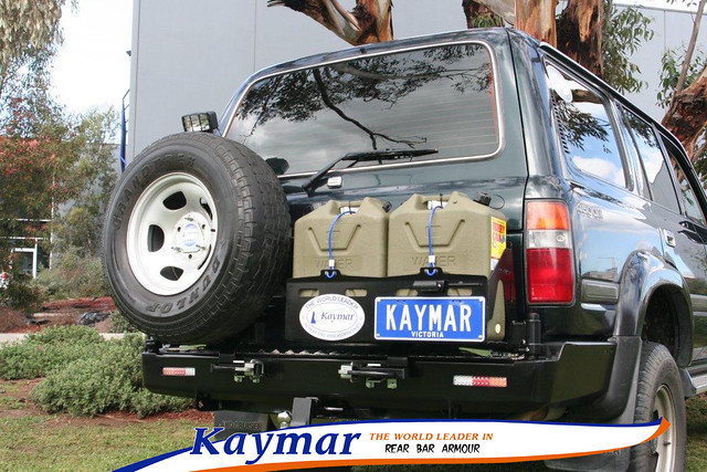

Spare Tire Carriers… Yep, seems simple enough… But lets start with the simple-simple.. And while "simple" is the theme, I have to think beyond the simple…
Lets start with the three general directions:

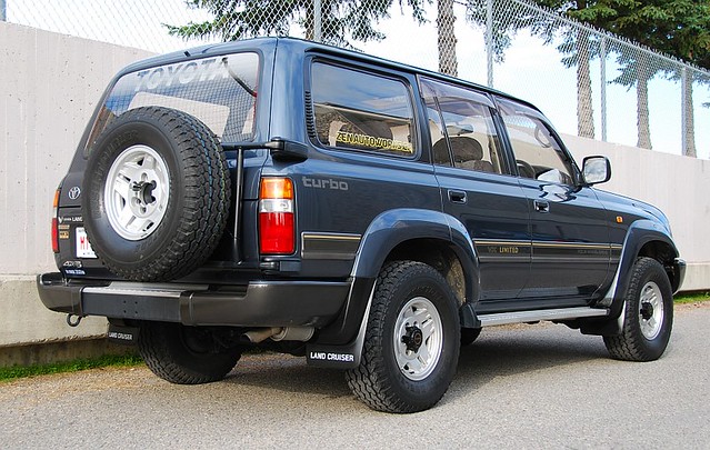

1] Factory JDM Spare Tire Carrier and think about tire size
2] Stealth Spare Tire Carrier Mod
3] Aftermarket Spare Tire Carrier
1] The JDM Factory option seems logical enough, but is hard to find as the 80-Series did not come with this option to the USA. But Canada got them. Finding one from Canada is not so easy. Then comes the question of tire size limit of the factory unit? Does anyone know anything about the JDM version and its tire size limit? Found a cool image of one in this thread (post #4) as someone was asking about mating a Nissan unit onto the 80-Series.
https://forum.ih8mud.com/threads/installing-a-path-finder-spare-tire-carrier-into-80-series.454648/

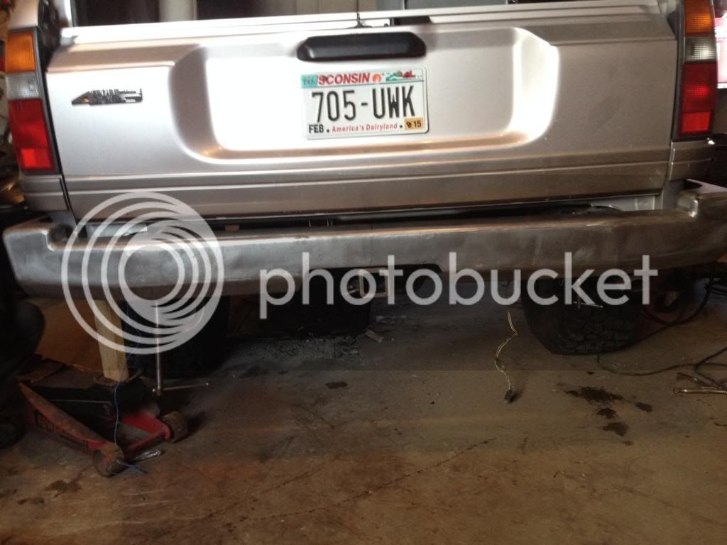

2] The Stealth Mod is basically making use of the factory bumper and modifying it in such a way to carry the spare. I like the resourcefulness of it but then it takes time to plot-plan-source-execute the ideas. Found this thread from MUD'member LightFighter that I really like:
https://forum.ih8mud.com/threads/another-stealth-tire-carrier.811750/
2.2]
SHREG has a really nice bumper built close to stock-look too:
https://forum.ih8mud.com/threads/not-just-another-rear-bumper-build.800889/
3] Aftermarket is great and while I have my eyes on a ARB/ICON/SLEE/KAYMAR type units, SHIPPING SHIPPING SHIPPING cost is EXPENSIVE on top of the EXPENSIVE bumper! While I have not ruled this option out, I do tend to look at location of mfg in proximity to my location. I do need to explore this more as well.
