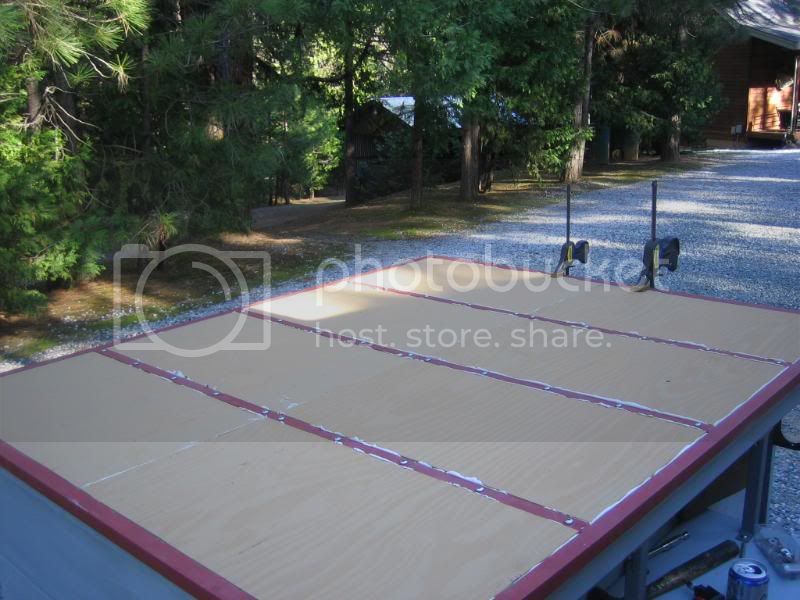

Started on the lid structure. We ended up doing a steel frame with plywood that we routered (sp?) out and set into the frame.
The lid in primer

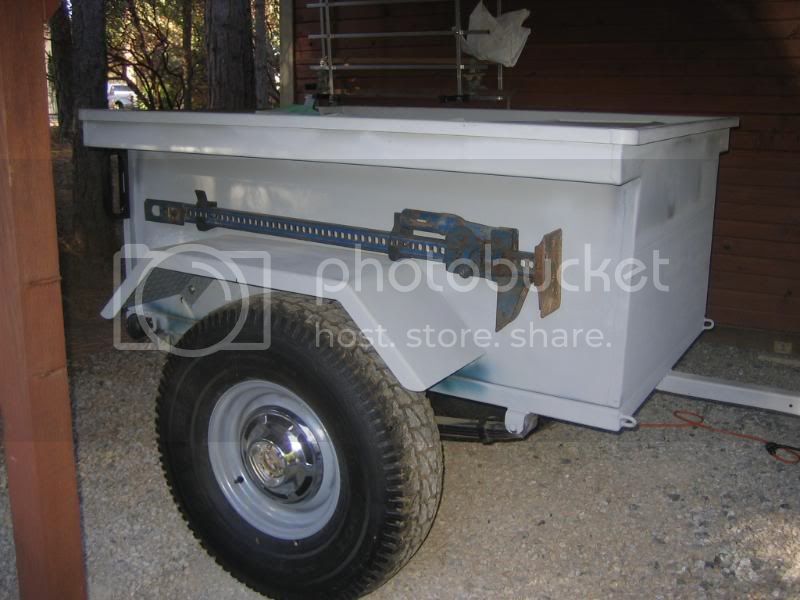

Tied the fenders back into the body so they were not hanging off the side.
Finally the lid completed with a little luggage/support rack
