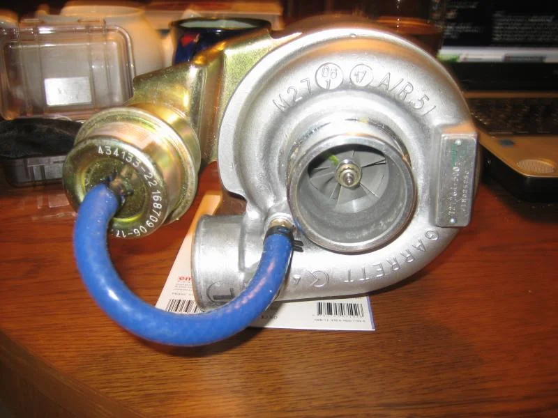

Well i'm the new proud owner of a garrett turbo. I'll post pics tonight. This pretty much just fell into my lap. I was reading up on the gt2052 on mud last friday (because i just bought another Bj60!!!!) and then decided to cruise craigslist and there it was just freshly posted.... very coincedental.

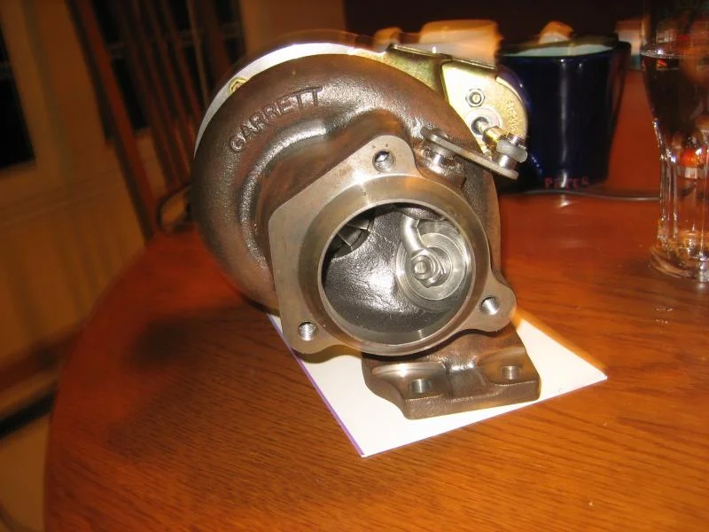

Some pics
looks like mine, nice score. I bought my 13BT manifold from 4wheelauto for like $425, but they are usually between $400-$500, I beleive G&S has them, TBI has them, I amabout to take mine to get ceramic coated along with the wastegate. I will try an look up where I got my oil feed and drain kit, comes with everything you need, u just decide where u are draining the oil to, I went to rear of oil pan up high.

Do you know the complete model number? They have around 6-7 trim on that model that denote different turbine ratios. The kit Diesel42 and i put together uses the 1 designation (last number in the model number) I think the 3 and 7 can also work without much tweaking of the wastegate. You might get a slightly slower spool from other trims.
Why don't just flip the exhaust manifold .. and made an adapter .. looks like impresive deal ..
The serial number on the compressor housing is 727264-5001
I believe its the same one that diesel42 has.
correct me if i'm wrong
On the compressor housing its says AR51
On the exhaust turbine housing it says AR50

This is were i'm stuck. What did you do for a downpipe? If i buy a wastegate outlet exhaust collar such as this; look at #tk057
http://www.jgstools.com/turbo/index2.html
If i use that can i just get an exhaust shop to use a 3" exhaust and mate it to the wastegate outlet? I'd like to keep this on the less expensive side. A custom made downpipe with a flex elbow is too expensive.
Will regular exhaust pipe hold up to the heat exiting at the wastegate outlet?

No, ours ends with a 5. for the down pipe - buy a mandrel bent "J", cut out a 90 degree drop and then go to a muffler shop and have them flare a piece of 2.5 inch pipe, then cut the flare off and weld it to your 2.5 inch mandre bent piece. do not use a 3 inch pipe - it is overkill and this turbo needs some back pressure. for a flange use a universal 3 piece type and notch it out to fit. i ran into the same problems and it was annnoying but I am done now.
