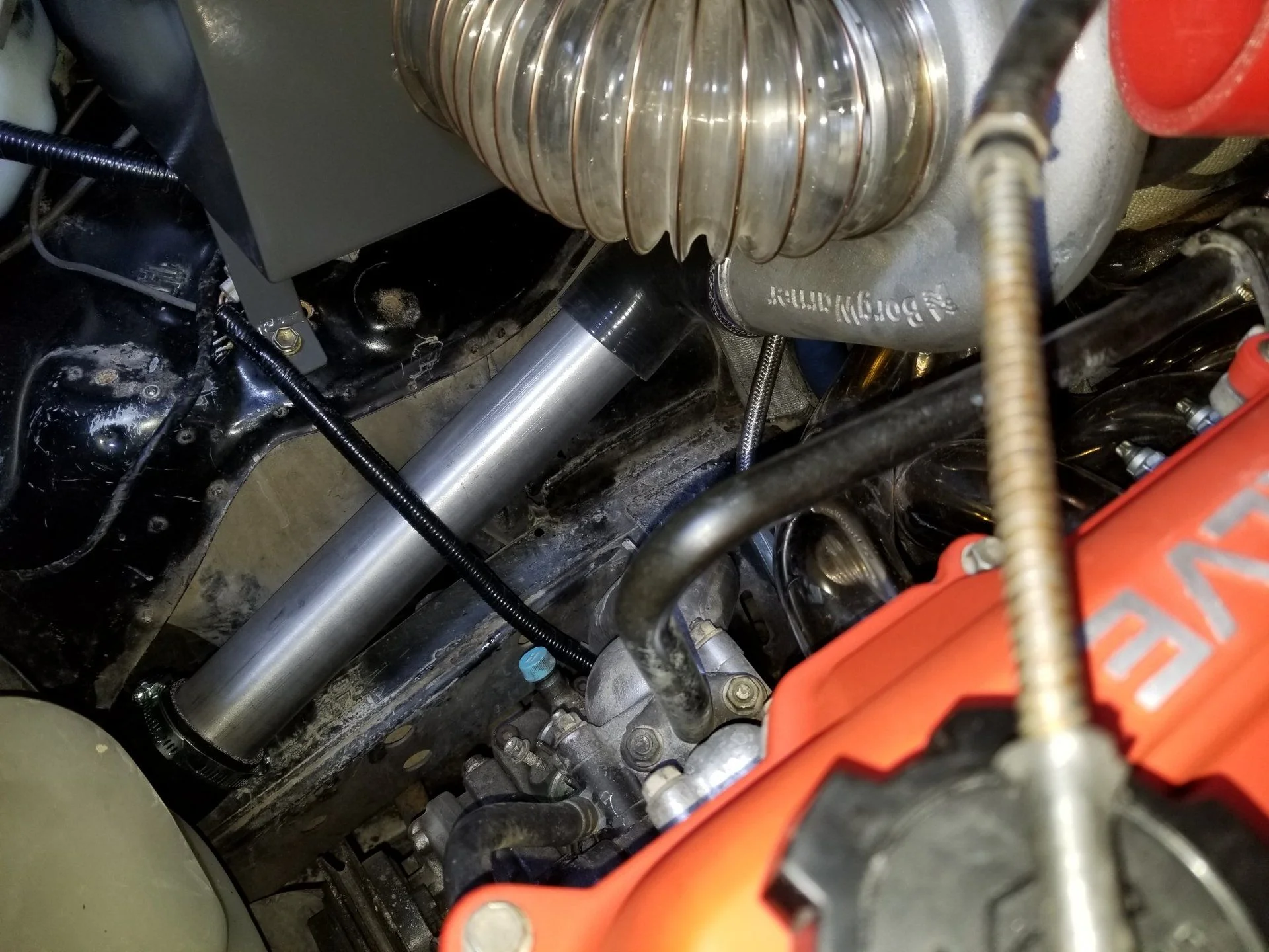

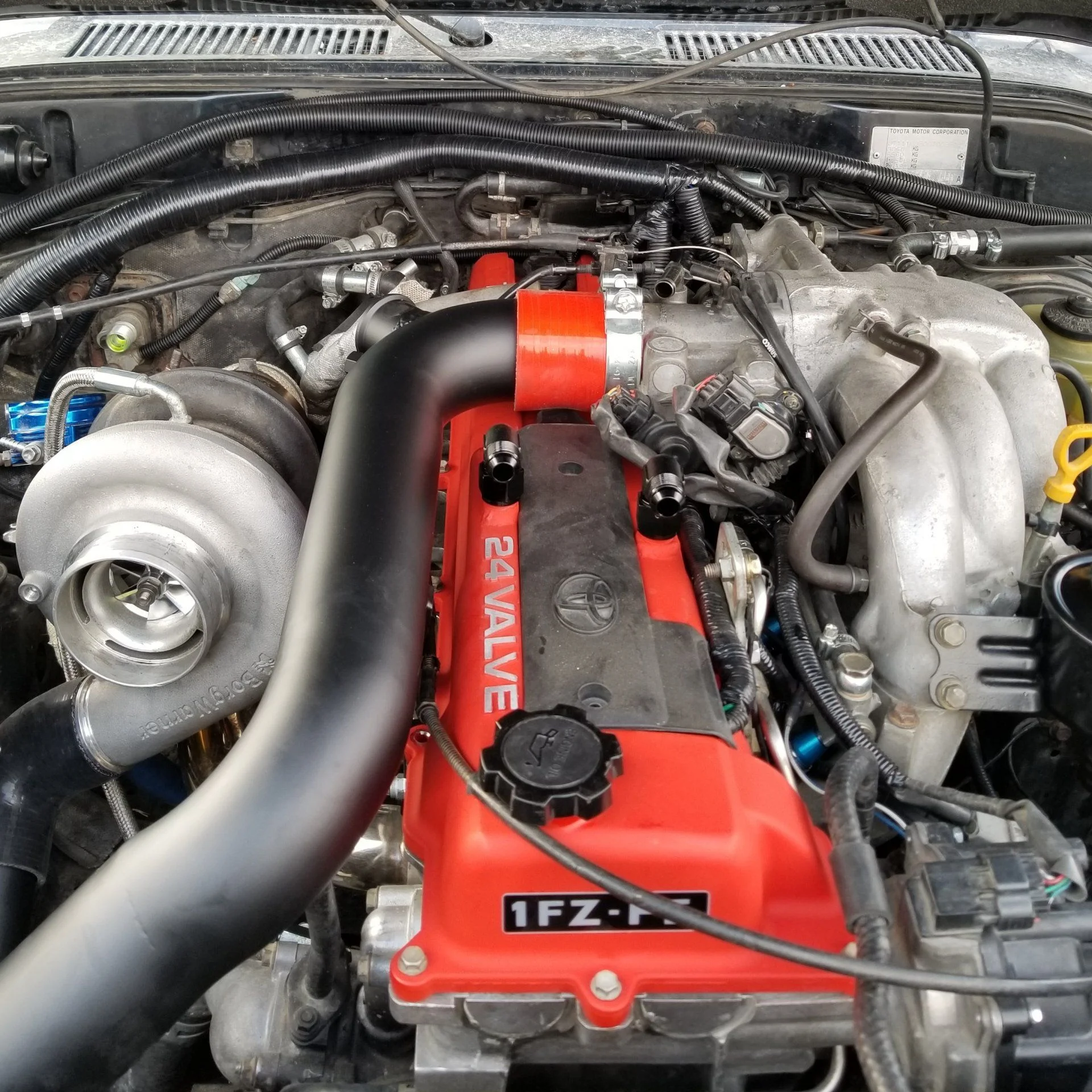

Coil packed 1FZ too, nice. I'd like to see a better view of the IC tube/hose routing. Is ECU Master a piggy back or stand alone?
ecumaster is standalone, control fuel, ignition, idle parameters. oem ecu is for auto gearbox..

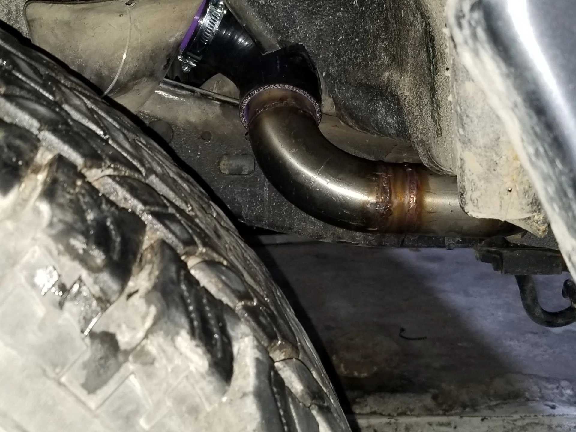

hot side goes side of chasis and cold side is under the headlight.. i think it is a good solution for left hand side 80s, i dont want use any water to air intercooler because of pump needs etc. its a daily car, more simple is more reliable.. and the iat is nearly 24-25c when its on boost and ambient is 10c.

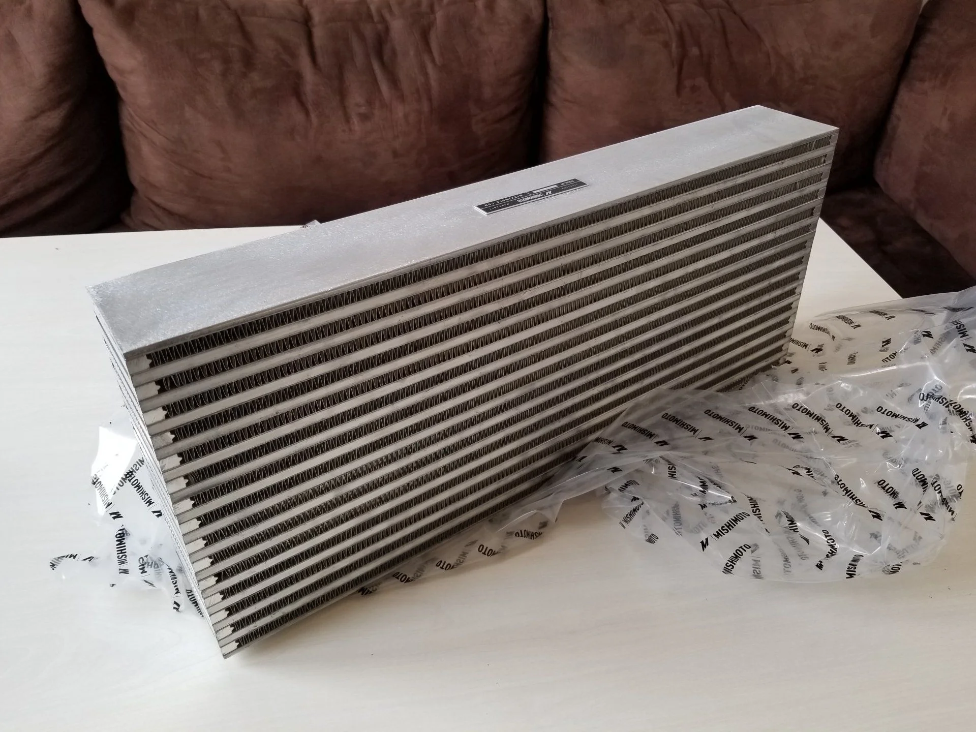

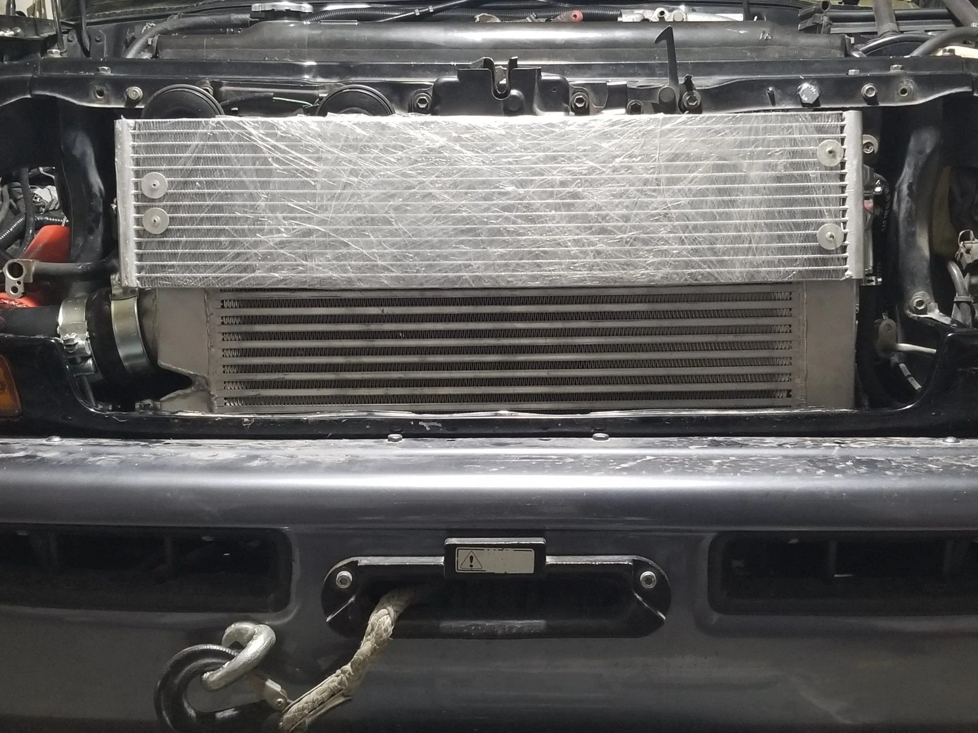

Amazing job on the intercooler and piping! Airbox looks great too. I've been thinking about how to crack that egg for a few years now. Too bad you have to weld your own end tanks to get a decent sized cooler that fits properly with inlet/outlet on the same side.
If you have dimensions or drawings on your intercooler, I'd love to see what you did :beer:
intercooler is mishimoto mmu ic 10 which is 700hp raiting, you can easily do this job..
