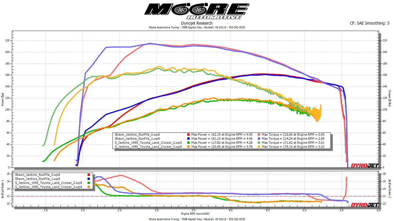

I’ve seen a few up but no harm in adding another. This is a GCC Spec FZJ80 so it runs open loop only. The only modifications include:
Pacemaker ceramic header (no cats but that’s is standard for GCC spec)
Iridium IKI6 5303 plugs
Unifilter foam filter from Australia
I had the vehicle dynoed to ensure it was not leaning out. I’ve read a lot about JDM, GCC ecu’s tending to lean in higher rpm. I have a Kazuma unit I purchased from LCH I plan on installing so having a baseline is valuable.
