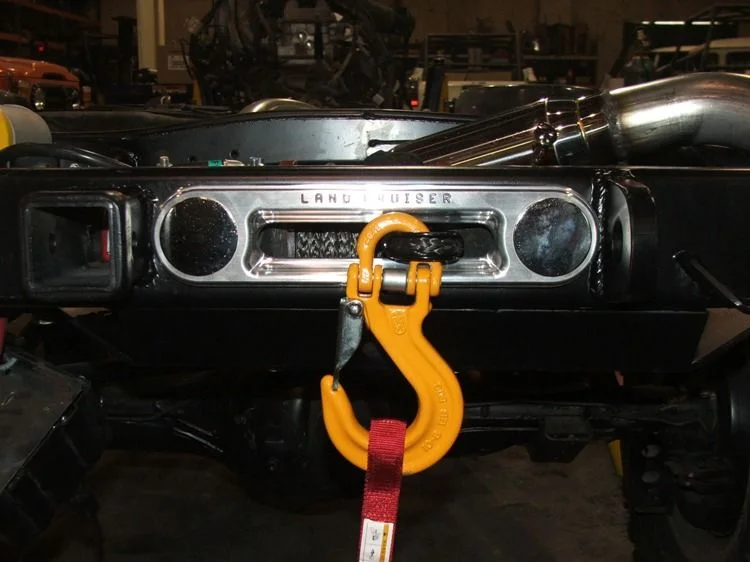

Finished installing the rear battery and winch this weekend. I had originally planned on running a full size winch and had picked up this cool winch fairlead from Cruizilla. The 9.0RC has a 4 inch drum though, and needs a fairlead with a smaller opening. I really wanted to run the land cruiser bezel fairlead so I tig welded up some aluminum inserts that bolt into the back side of the opening to direct the cable onto the 4" drum from the 8" fairlead.
Lance
