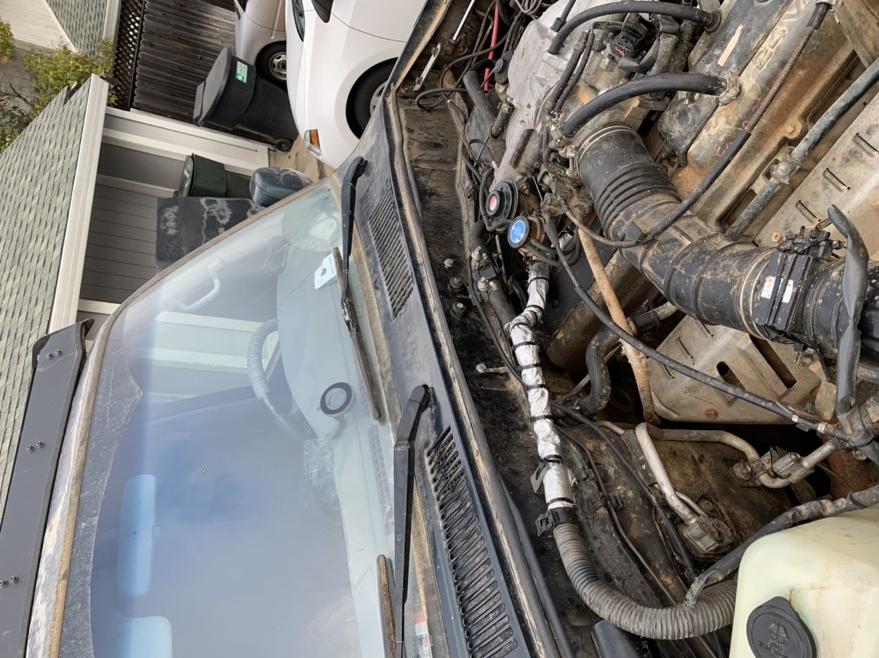

I would start with the common trouble spots like the area around the EGR pipe where all your injector wires run.

Injector 6 plug is pulled out a bit, digging in to look at more harness down there.

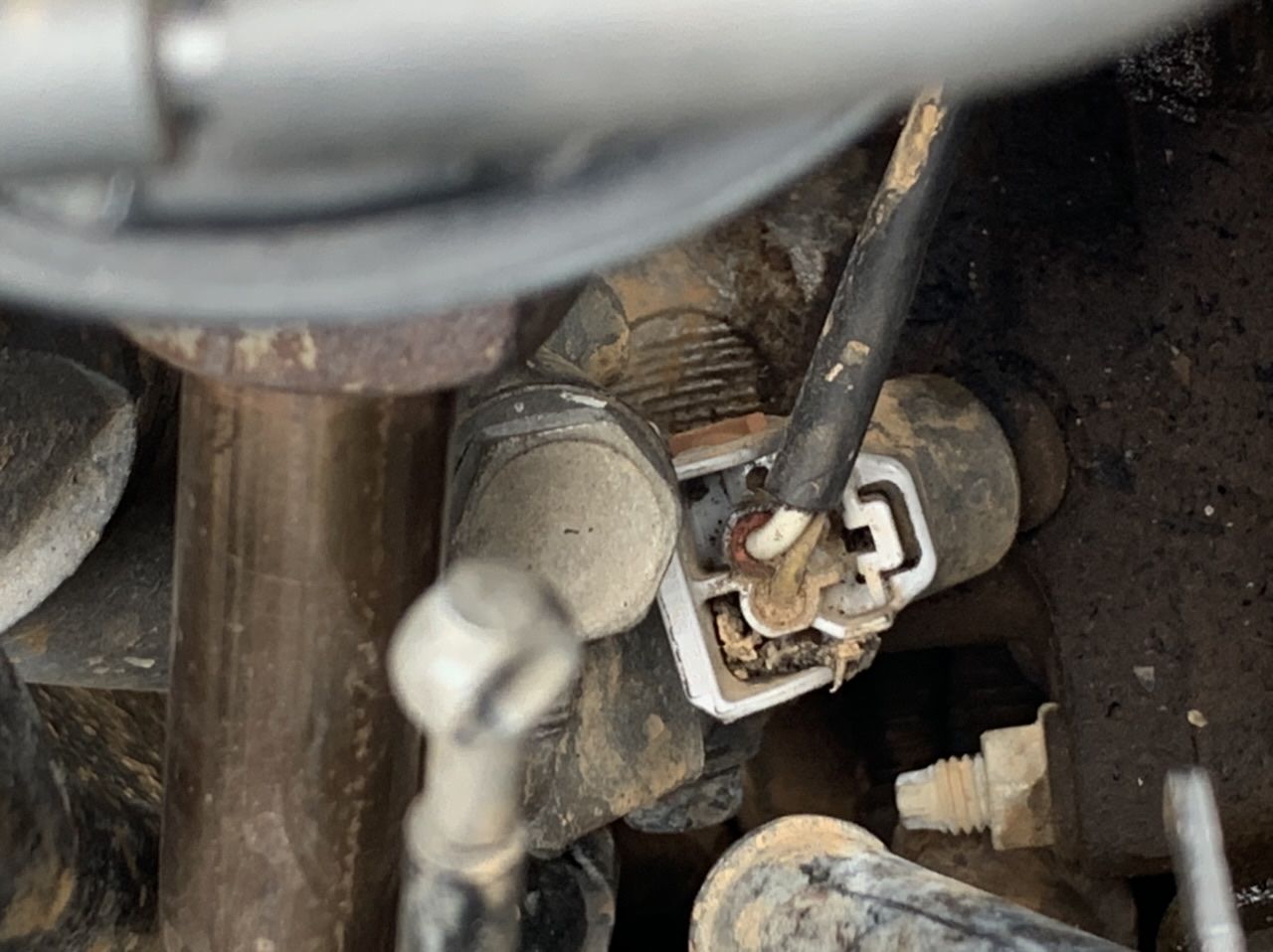

Also, that’s the connector for my Alternator (which I assume is the generator on the diagram) looks a little fried, I guess I could imagine the ground for it may be the culprit, if there is one? Has to be
Any idea what posts are which to test?
None of them should be ground, if that's what you're asking.
Pin 1 (yellow/light blue) will go logic low to light the charge lamp on the dash.
Pin 2 (black/light blue) is +12 when ignition hot
Pin 3 (black) is +12 from AM1.
If the internal regulator is shorted to ground, that would take out AM2 and you would read a short to ground on the solid white wire that runs from AM2 to the alternator output.

Looks like I will hook up all of my wiring that I have disassembled and test the alt, everything is torn apart ATM
I’m going to take a wild guess And say the plug housing on top of my distributor is not supposed to wiggle back-and-forth?
Just for future reference for guys looking for solutions, my distributor was the cause for immediate pink fuses going.
