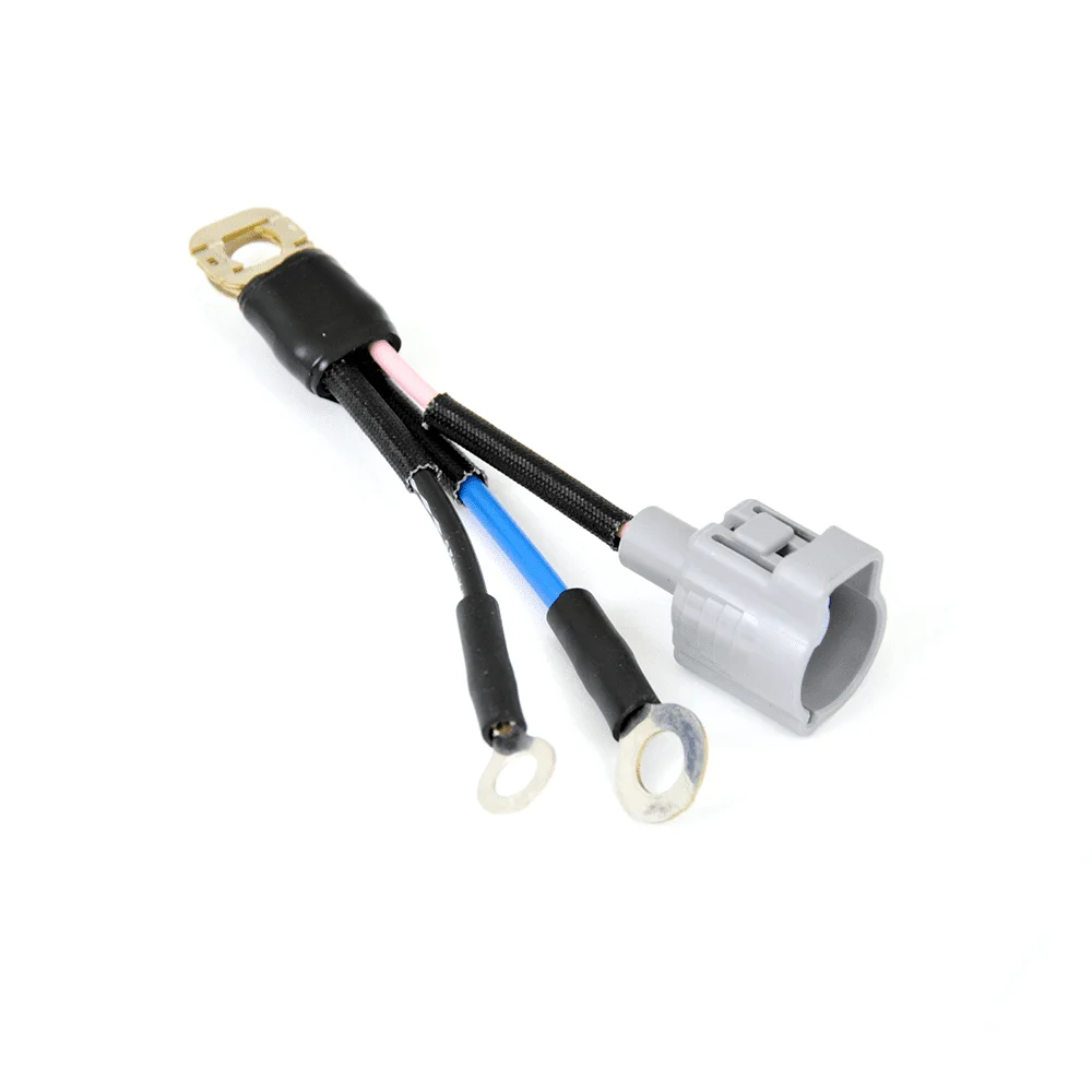

Is that not available as one piece from Toyota? It looks pretty close to the 80 Series one with different ends.
