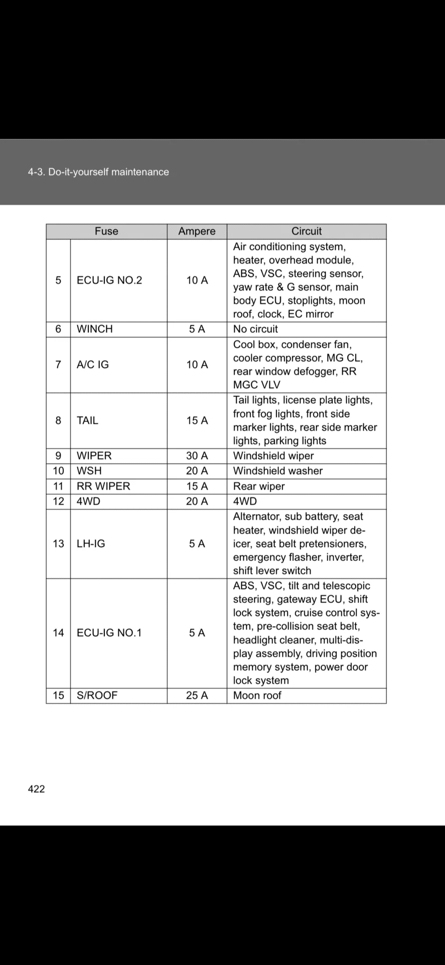

Note: I really tried to decipher the instruction manual to find which fuse controls the puddle lights (they stopped working after replacing the bulbs with LEDs).
I really hope it’s not labeled something obvious like “PUDLT” cause then I’ll feel really dumb.
Also, whats the part number or name of the screw that is used to attach the windshield washer reservoir?
thanks in advance

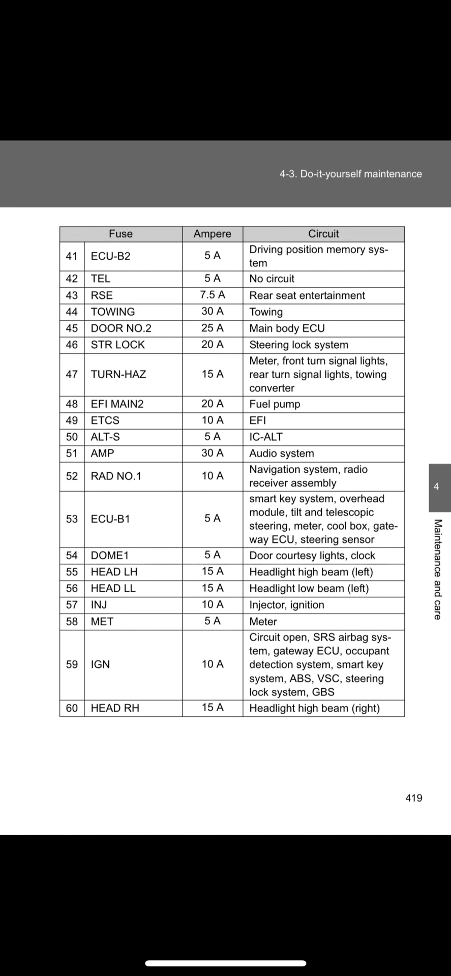

No puddle lights on our 2013, but it seems like they would be connected to the individual door interior courtesy lights? So same fuse?
And assuming the LED's aren't polarity specific :)
Anyone have any info on the washer fluid reservoir screws?
Flip the LED bulb. Lots of them only work one way and will be off if you put them in backwards. You have a 50% chance of getting it right. :)
My washer reservoir filler neck is connected with a plastic push pin type thing. The dealer looked it up for me and charged me an arm and a leg for it.
