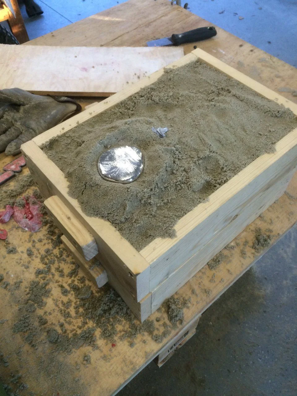

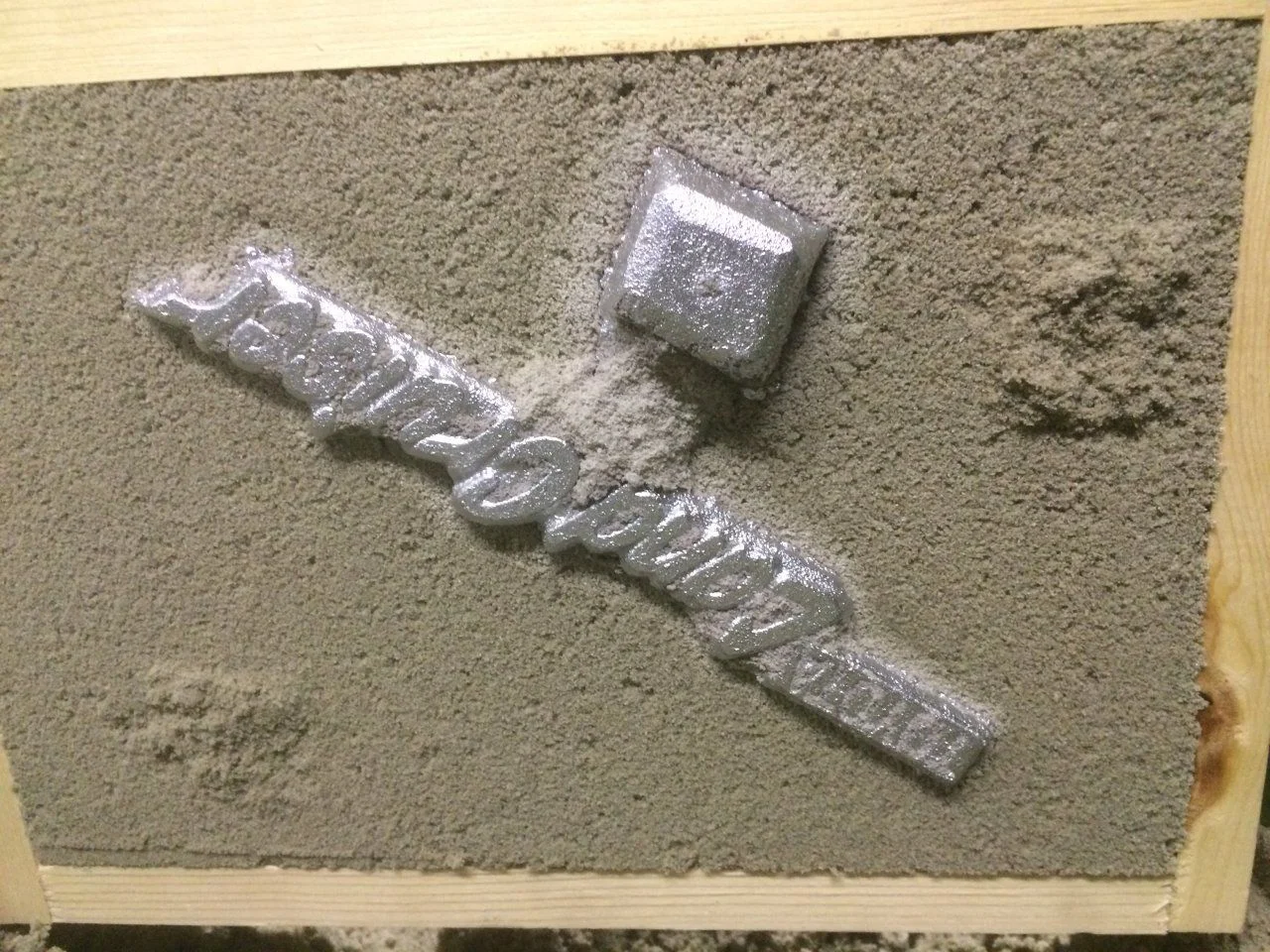

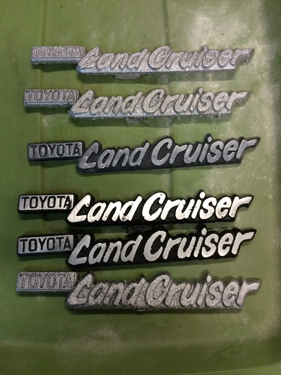

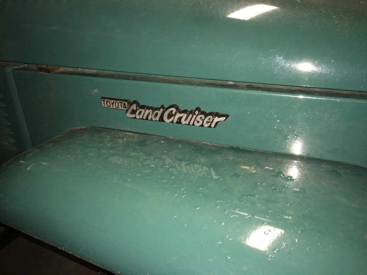

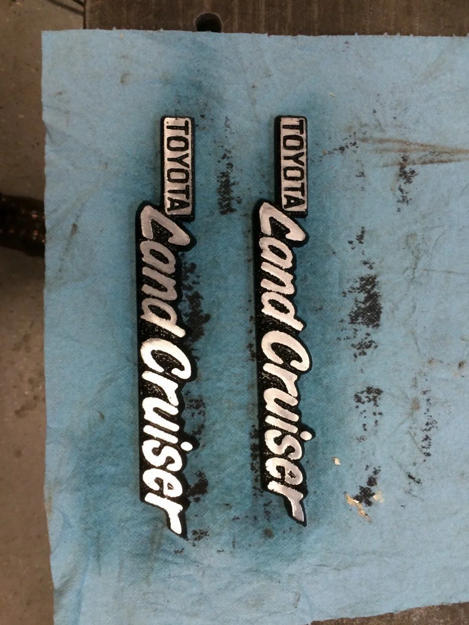

My "Toyota Land Cruiser" emblems were having the broken mounting post problem again, and rather than buy another set of plastic ones, I decided to build a foundry and make some aluminum versions. The plan is to use some VHB adhesive and stick them on, just like all the new cars do. It's a fun process, plus i was able to teach my son about the foundry process. in the pic with all the emblems, the original plastic one is fourth up from the bottom.

If you pursue this further, there is a market for these. How are you fastening to the fenders?
Originally was going to try to drill and tap them, but once i really thought about it, the 3M VHB tapes are the typical attachment method for car badges now. Everything from moulding to window trim seems to be attached that way.

I missed that part in your opening comment. Could be easy to run short tiny screws from back side of fender into the aluminum.... Where one can get access, easy on 40, not so much on 60.
Most of my plastic pegs broke off as well. I broke the rest off and used the 3M peel and stick to re attach them. I've always been interested in different moulding procceses, nice work.
The first ones i made are relieved on the back, just like the plastic versions. By the end of the day we decided to fill in the back so there would be lots of surface area for the VHB to adhere to, and ew got a little cleaner casting as well. Once i have a set cleaned up and painted, I'll take some more pictures and post them. Fun little project, and this way I'll have 'aftermarket' emblems that should last as long as the rest of the truck!

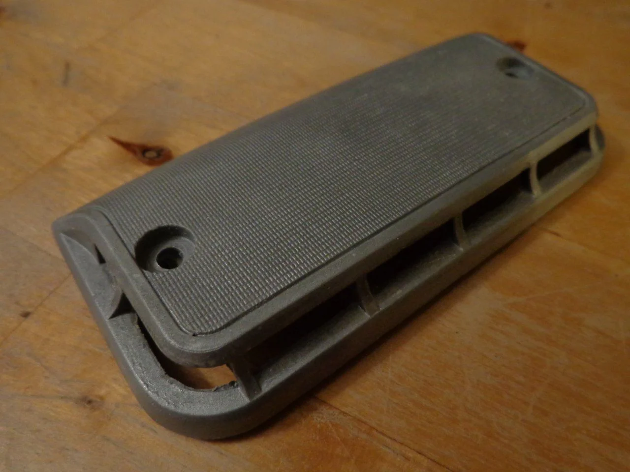

Diesel 40s had a apx 1.25" x 3.5" vent below the kick out window. The last plastic covers were sold a few years back for $30+/side. I don't know if they came on any US models. Mine are both long gone so I'll likely machine something up on a milling machine when I've got access to one again.

You would think so, but I havent seen proof of that. I started a thread last summer after I made a set for myself and got 0 responses. They look close enough but have rough edges on the inside. Thing is the plastic would get soft at 45-50 deg c, so I'm still testing them.

Those look real nice. I think I'd go body color with them. They look a little to modern in bare aluminum.

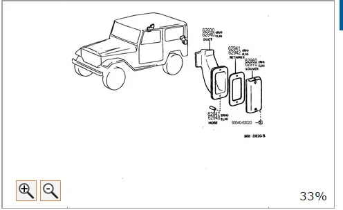

I think this was for "cold climates" aka Canada. It's to help with the rear fogging up.View attachment 1019769
These were on gas models as well as diesel models. Plus on the 45 pickups as well. Only on Canadians imported 4X series. There were other cold climate countries besides Canada that got 40 series cruisers but these are Canadian market only.:meh:
