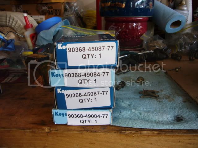

You see a mix of OEM and aftermarket. I got new KOYO bearings, seals and gaskets from CDan, as well as some new e-brake pins and parts that I don't think I have pictures of right now. Rotors and e-brake hardware are Raybestos from RockAuto.
New Bearings from AZ, interestingly the OEM's were Timken and looked to be in pretty good shape.

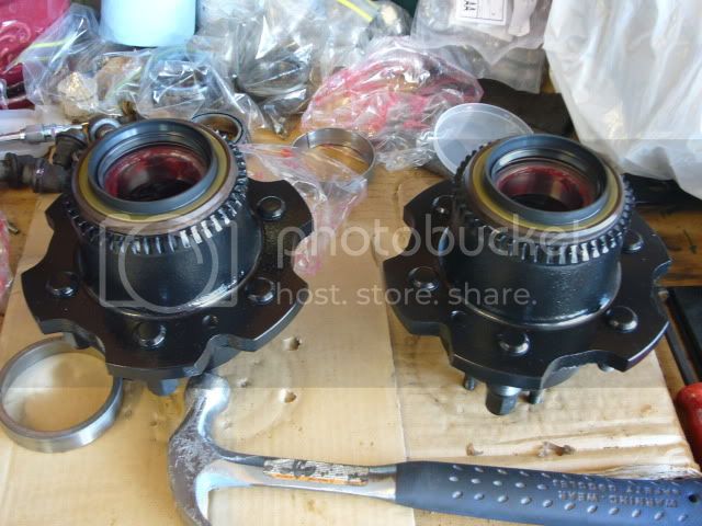

I cut the old races to use for driving the new ones in, man that is the way to drive a bearing race. I packed the bearings with MP and loaded up the hubs. I installed the inner bearing and seated the new grease seals.
Both hubs, cleaned up and painted with races, new bearings and seals installed.

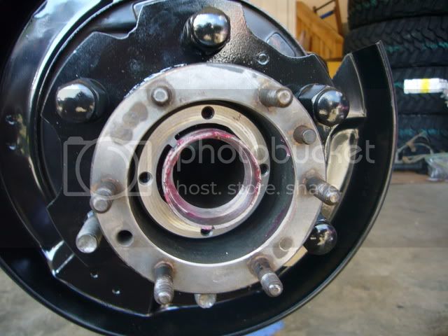

Install hub
Install outer bearing
Install Washer
Install hub nut
They are hand tight right now since I still have to pick up a fish scale to check preload before I install the locking screws in the big nut.

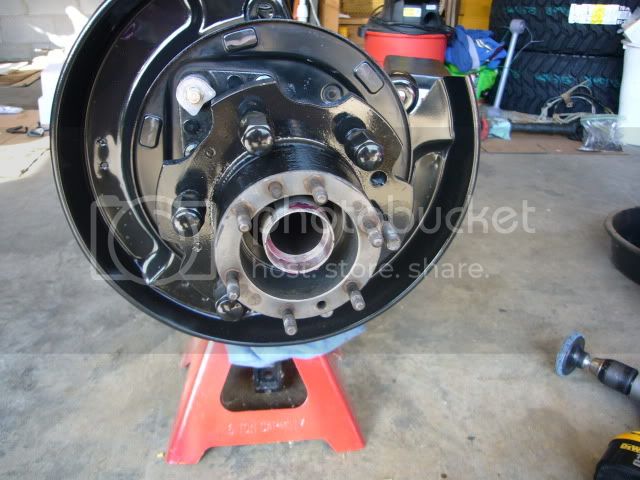

I spent a good bit of time getting things on right, so I don't have any good install shots, but here are the finished products with some commentary.
One of the main things I want folks to take note of is that the bent pin that goes towards the front of the vehicle (middle left in the above picture) should be installed in front of the e-brake actuator arm. I studied on several schematics including the FSM and the actual e-catalog that Beno had posted on here and after I put it on backwards and fiddled with it for a good bit, I figured out that if installed backwards the arm and the shoe bind and do not operate correctly. Once turned around things play much nicer together.
Secondly, the pins DO NOT go thru the shoe itself like on most drum sytle brakes, instead you slide the pin thru the open slot and then you put what I called the pin locating plate over the pin and hook it into the hole in the shoe, then your spirng and retainer go over that. I will get a better picture of this since I still have to do the other side.
The original adjuster installed with a new spring. I turned the spring inboard against the adjuster. Someone might confirm if I got this right, the FSM is not all that helpful on this one. Also from all I can tell the threaded end of the adjuster goes toward the rear of the vehicle.
Here is a little better picture of how the pin and retainers go together, as well as the return spring. You can't really see the slot I was talking about, but you can see the little tab seated in the hole with the other end of the return spring. You can also see that new actuator for the e-brake behind everything.
A new rotor hat covers everything up. I spun it by hand and pulled the lever and as long as I can get the cable adjusted properly, I think she will hold nicely.

Correction
Just finished this today and was using your pics as a guide.
The blue spring pictured should be hooked behind the adjuster, on the axle side of the parking brake shoes. Don't know if it would make much of a difference, except to make adjustment a lot easier.
Anyways, thought I'd post up for anyone else. Your pic's were very helpful. Thanks!:beer:
X2 i just finished up my ebrake also, from factory the blue springs is behind the shoes....although not sure if you have the holes there since you used aftermarket shoes. You cannot flip the shoes because the shoe with the lever will be on the wrong side.
Good work dude.:beer::beer:
Thanks for that, I still need to adjust them out one or two clicks so it will hold with a few less clicks on the lever, so I may try and swap them. I am pretty sure the little catches are on both sides of the shoes.
