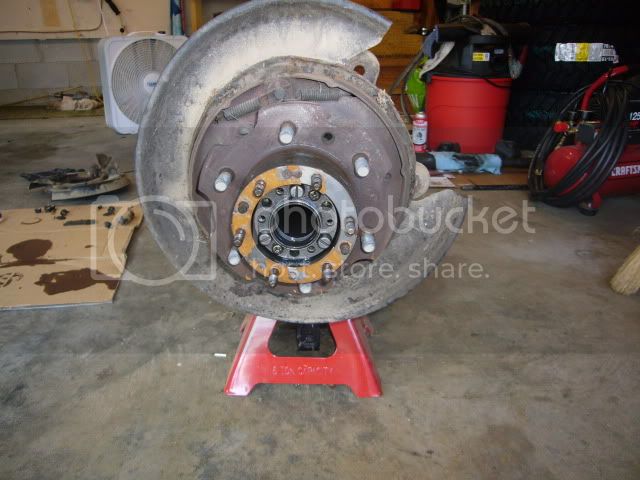

Drivers side - Had a lot of brake dust inside but seemed to be in good shape.

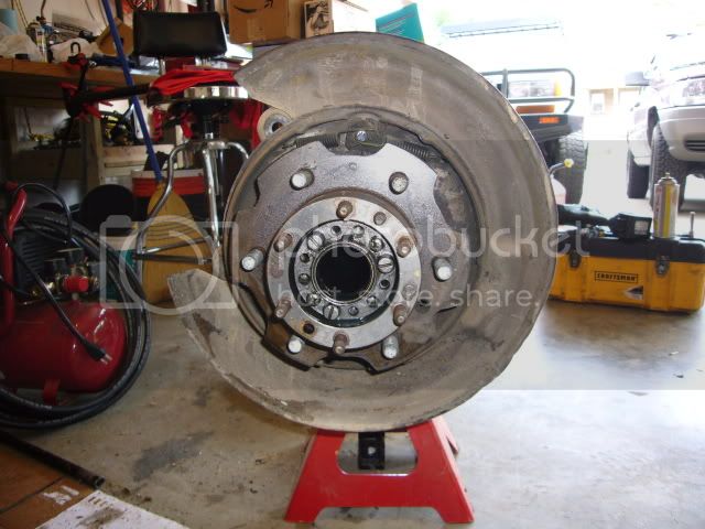

Passenger Side - Was very dry, had a lot of cob-webs and was pretty rusty.
Both adjusters came out with just finger pressure.
And the perfect tool for breaking loose the locking screws that haven't been touched since they left the factory.

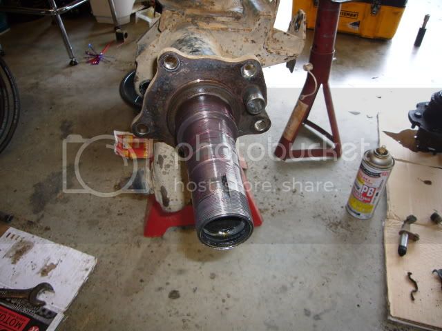

The interesting thing is that once I removed the hubs, both outer bearing fell out and there was NO grease in either side.... they actually had to sit for a little while and let the gear oil drain out. :doh:
The outer bearings showed some slight signs of wear, and rolled freely, so I want to get the inner bearing out before I decide if they need to be replaced or just repacked.

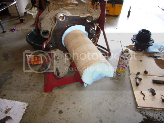

So I stripped off both sides down to the the bare spindles, greased them down and then wrapped them up to protect them while I clean the housing.
All stripped down and ready for cleaning.
After all is said and done, most everything came out pretty good, but the passenger side backing plate left me with a question.
Is it supposed to have that little gap between the backing plate and the collar? This gap looks a little larger than the drivers side.

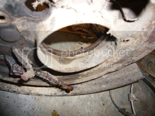

I went to remove the cables that activate the shoes for the emergency brakes and I had to use the grinder to cut the pins and ends down just to get the cables off. Good thing I already have a pair of these and the pins and retainers on the way from AZ.
I was able to grind down the pins enough to get them thru the backing plates, but will have to drill out the ends once I get the new pins to make sure the holes are the correct size.

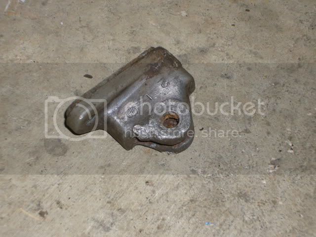

I broke two of the four bolts removing the brackets that hold the arms on the backing plates (you can see one of said bolts peaking out on the left side) and one of the brackets came apart at the pivot, and after taking a look at the other one, I think a new pair of these are on the list also.
I looked at the broken cross-section and it looks like the brackets are made of pot medal, but they are light and look more like aluminum, so I am not sure.
See the spot that looks like a booger weld from a previous repair....:confused:
