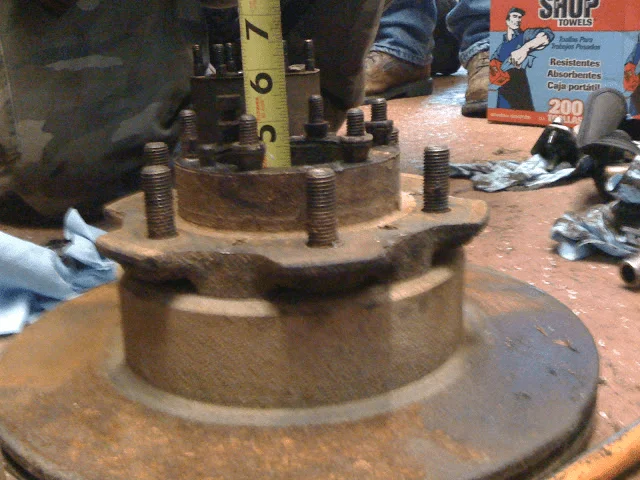

would the "assembly" of the rotor, hub, spindle nuts,etc... land in the same spots/measurements on the spindle?
Yes it will work fine
The hubs will fit on the spindle, yeah, but rotor to caliper mount distance? Not sure.

I know the rotor attachment method is different for mini truck junk but if I went mini truck wheel hub route (easier to source around here) would the "assembly" of the rotor, hub, spindle nuts,etc... land in the same spots/measurements on the spindle? I ask as the caliper/bracket is obliviously in a fixed location to some degree and the spindle needs to be the right length as well.
