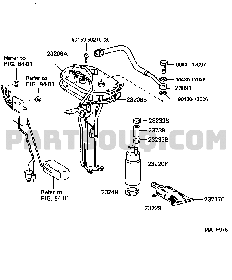

4) Remove the second row seats, lift the carper flap, and remove the fuel pump and lines from the top of the tank. (You WILL need new copper washers to put it back together)
Do you happen to have the quantity and the part number or size of the copper washers?
