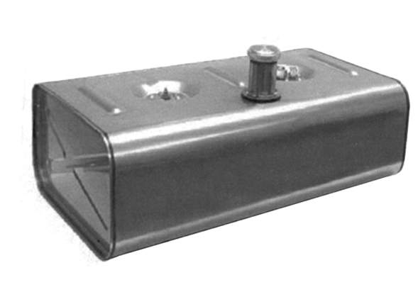

Way back in the mid 80's my 72's tank developed a weep along a seam. I did the alcohol proof gas tank liner treatment from JC Whitney. Tank is still there and leak free. My dad welded lots of gas tanks - learn about proper inerting.
I'm considering this behind the rear axle aux tank to replace my in poor shape datsun b210 12.5 gal aux tank I klooge in back in the early 90's. Or perhaps welding one up out of stainless steel.
You kind of need everything in that sor parts pic you have. I did a video where I showed an installed tank and some of the supporting parts being installed.
Unfortunately a lot of those parts have been discontinued and are hard (expensive) to find.
The Spectra tanks are good. Get that and convert to intank pump. Even if you don’t have emissions checks I would still add a charcoal canister if you don’t have one, they’re a good device that just avoids wasting evaporated fuel.
