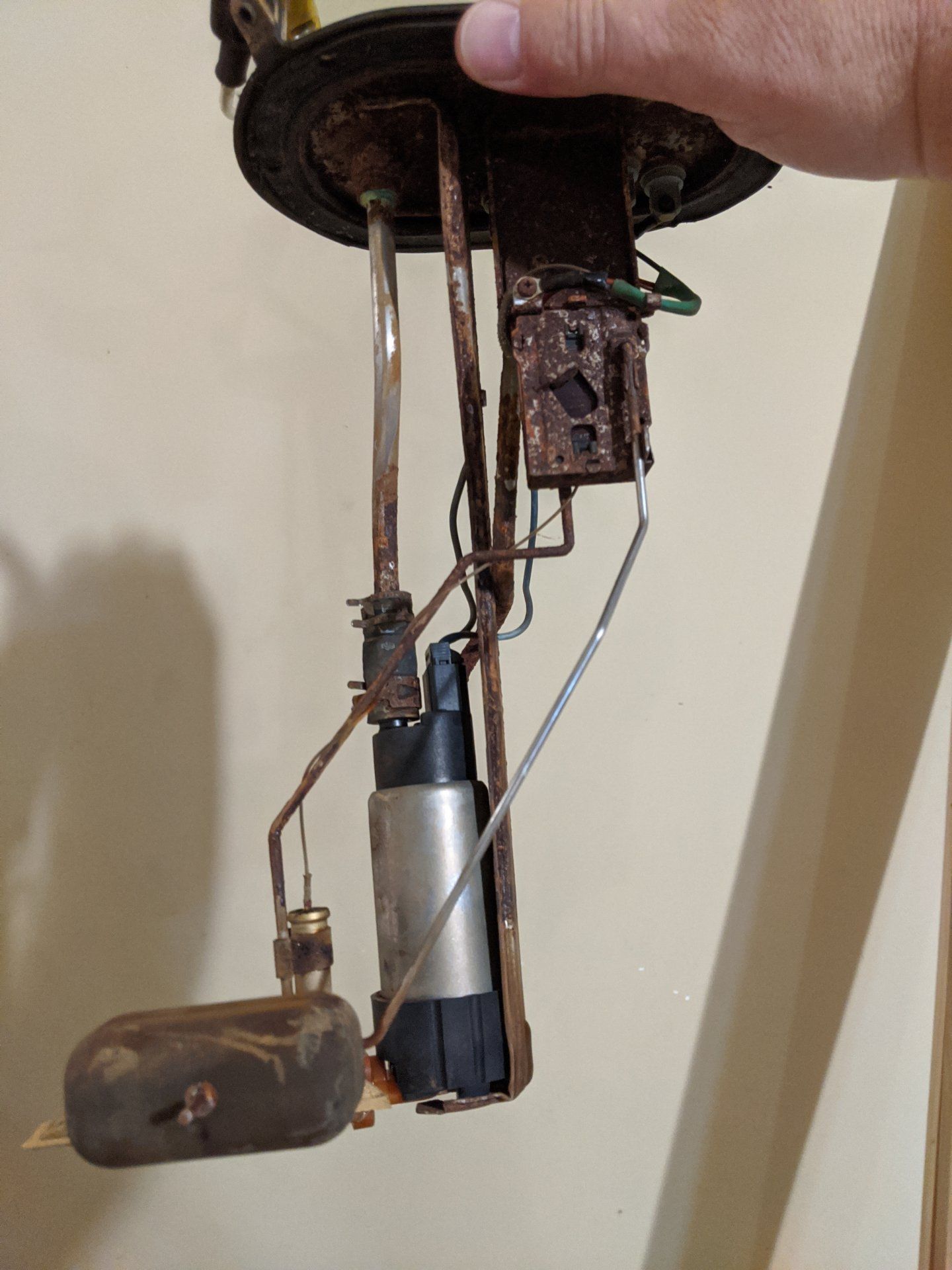

Probably 23+ years of moisture has the sender looking like this....

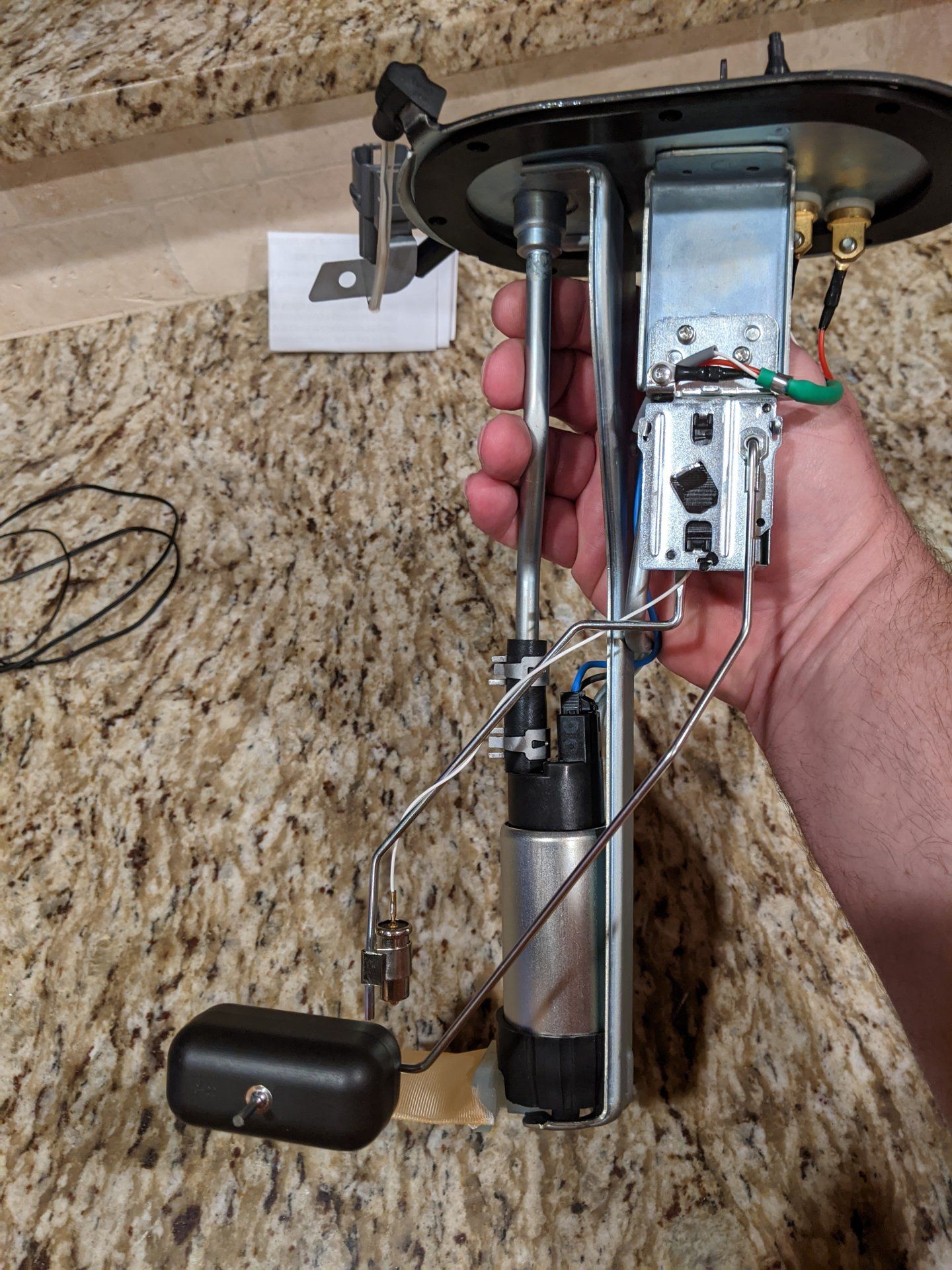

I'm hoping this fixes it...
Jason
Is that all new, or did you replace the sender and clean the rest up?
What did that run, and from where if you don’t mind saying?
There is one part reused from the first pic, because I forgot to order it. Bonus points if you can pick it out. I'll have to look up the invoices, it was a mix of PartSouq and LaGrange Toyota I think, if PartSouq did not show stock. I'll post when I find them.
