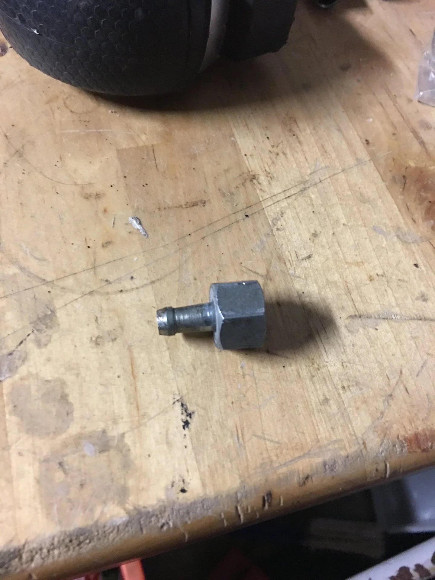

Hi Paul,
I'm in the process of finding replacements for my fuel lines as well. If you have the originals, and remove the current hoses (carefully), you should be left with the fittings like in the picture below. You can take these to a local hose shop and have them clamp on some new hose or just get some 5/16 fuel hose and clamp it yourself. This is the route that I plan to go anyway, I was literally taking the fittings a part just about an hour ago.
I hope this helps or at least provided another option.
Rob
Thanks, Rob. I do have the original line. I will strip it (carefully) and hook it up with 5/16th hose as you suggest. Many thanks.

Did you not have the second nut that appears to have a nylon bushing inside. I just had to make a repair on my 70 FJ40 that the line between the filter and pump crack in half. I found a short piece of fuel line with the double nut fitting on the end. Used a heat gun to soften the old line to remove one of the nuts. I used a heat gun on the other piece I had to install the second set of nuts.
What I would like know is if any know of a replacement for the OEM hose. I have fittings know how to press the second nut on if I have the correct OEM size hose.
Picture of the double nut setup.
