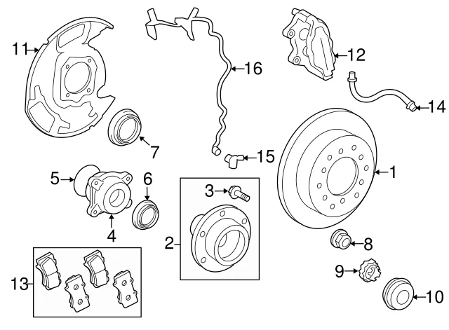

My truck has 204k miles on it, and i'm starting to think the noise i had attributed to my MT tires is actually the wheel bearing. With the miles on the truck, i think its a good enough idea to just go ahead and replace the bearings before they get any worst. I have a harbor Freight 20-ton shop press and have found this video and document laying out the process to where I feel I could get this job done on a weekend. (fingers crossed). I have priced out the parts and for doing both front wheel bearings and re-using my hubs i'm looking at about $500.
I'm listing out the parts below, please let me know if there is any additional part that I might be missing.
Bearing Assembly
Product ID: 43570-60031 - $179.89
Inner Seal
Product ID: 90316-83001 - $44.05
Outer Seal
Product ID: 90312-87001 - $21.18
Bearing Assembly O-Ring
Product ID: 90301-99182 - $6.41
Parts are 4,5,6 & 7 on the diagram below.
I did see on another post where someone got the bearing and hub assembly together and preassembled but cost is $449.00 per side.
Let me know if there is anything I might be missing or not taking into account that could delay or stop this project from taking place. I'm still in the planning stages and would prefer to do the work myself then take it to a mechanic. Baring any serious objections or events that would prevent me from doing this. I'll hopefully post progress and how the process went for me at the end of the month.

How’s the condition on part #11 in your diagram? Mine are the original 08 plates and they are pretty rusted out (mainly the rear). They had a updated part I heard that was thicker metal less prone to rust. Im only at 130k though, so my plan was to wait til I need bearings and then replace those plates at the same time. I think kurt sells some rear axle rebuild kit that includes everything but that’s for the rear.

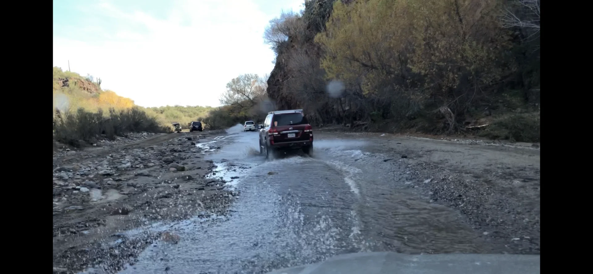

Yeah check them out. I did a trail out here in AZ that’s a wet river bed the whole time. After I realized I had little river rocks stuck between that plate and the rotors. I just wiggled the plates lightly to get the rocks out and the metal started to break apart. I hadn’t even realized they were rusted. I posted somewhere on mud and after the initial sticker shock on those plates (I think like $300 each) a bunch of people chimed in saying if you have the axle apart (which you need to change the plates) you should replace bearings, potentially rebuild the axle, and install lockers if you desire. Take what could be 3-4 separate jobs and tackling at one time. I’ve shelved it for now til my bearing show signs of decline.

I would add the cotter pins 95381-04045
Should be pretty cheap.
Also some people elect to replace the hub bolts to get clean threads and heads. 91672-L1240
If you can't get the dust/grease cover off without mangling it the number is 43514-34020
I wouldn't bother getting these ahead of time unless they are cheap. Can be run without temporarily and installed later when you have time.
If you care about torque values you'll need a 17mm offset torque wrench adapter for those bolts. 73ft-lb
And a torque wrench capable of 251ft-lb for the second tightening stage on the large CV/hub nut.
