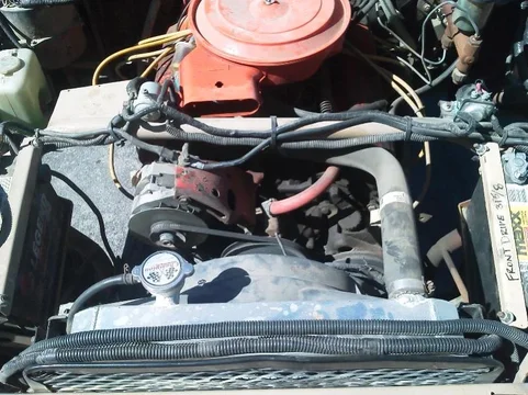

IMO the best solution is to tie the sides together with a bar that runs just behind radiator, sneak it across right on top of the fan shroud. That combined with the frame attachment that comes with the fenders to replace stock fender mount should be strong and protect radiator as well.
I have found that the bib tie in piece tends to not allow enough flex/travel/body movement. The tube fenders seem to need to move more than the stock fender and inner that are all bolted to the bib & skirt & tub.
Incorporating an engine cage or a front radiator hoop/winch gaurd would give some more support and provide more options regarding tieing in the fender tubes.
