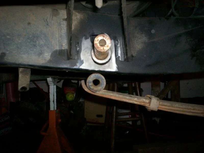

Would longer shackles also help ? I would like a little more lift like 1/2”

Bumping the shackle closer to vertical is going to net some lift
So here is where I’m at now with my hanger as far forward as I can

Why? My rear eye is almost directly under the tube with RUF
My tube is slightly forward compared to yours and here’s my homemade front hanger
I could move the hanger complete mount forward more if needed it’s only bolted for now
These are 5” shackles if I went to a 4” would it help ? In my mind it would some but put the springs closer to the frame
