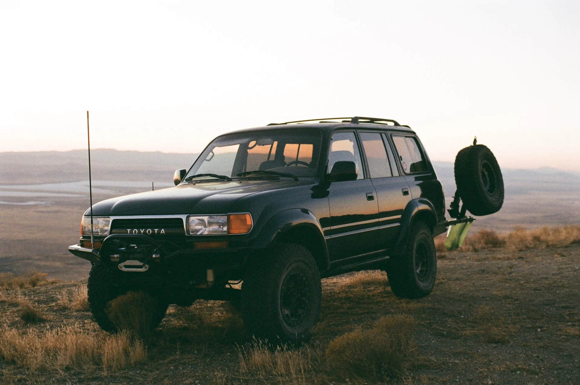

Any thoughts would be appreciated. Here's a photo of the rig just for fun :0)
