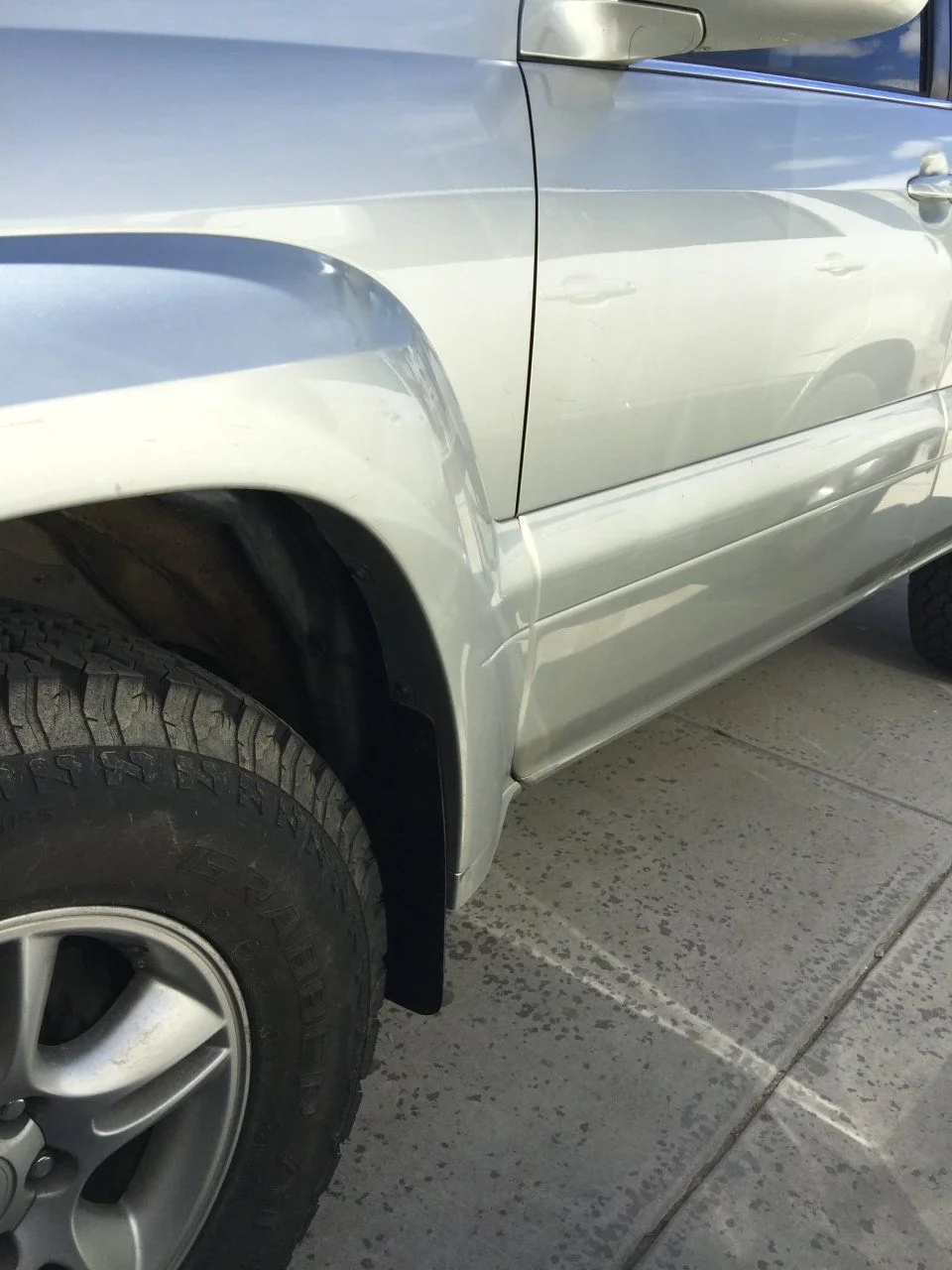

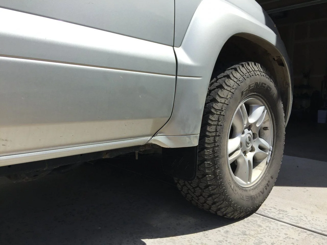

Picked up a $10 set of trimable rubber mud flaps from Amazon and mounted them on the front to try out. Not sure yet if I like the look. I figured why not give it a shot for $10.
I'll try to grab a pic here in a bit. 3 self tapping screws on each flap did the trick. There's quite a bit of real estate on the inner fender to pick where your screws go.
Thanks for the information and effort. Seems like a good inexpensive fix! For rock crawling mud flaps area often avoided. Where I live they are necessity 8 months out of the year.

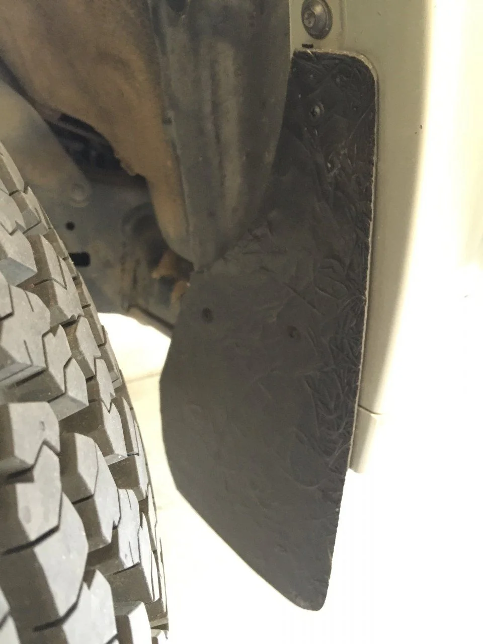

I grabbed a pic. I just mounted the 3 screws in a triangle pattern. I don't really like that the wheel side of the flap is textured, but I doubt many people are looking. It was mainly a $10 experiment to see how it looked and functioned. I did have to trim some of the interior portion because my tires were running at full lock.
