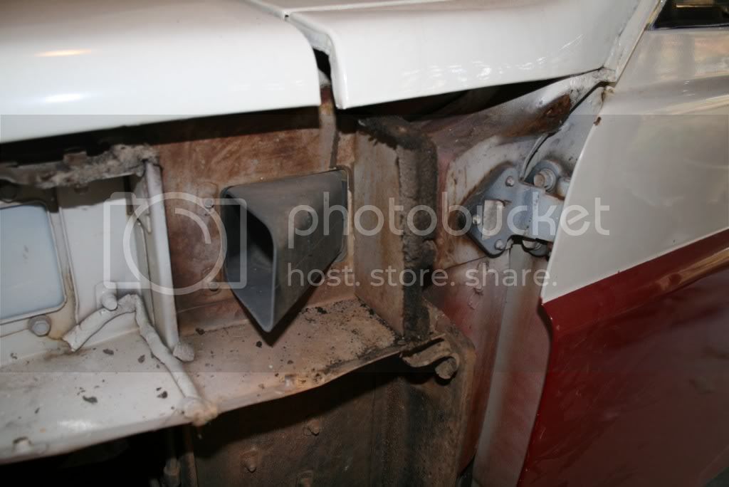

Pics of Front Fender dissasembly
So here is the first pic...I labeled where things are. If these are huge, I am sorry. :)
Here is the seam sealer forward from the vent and the vent baffle foam sealer:
This is a little rubber piece under the vent baffle that tucks up to where the two fender pieces connect.

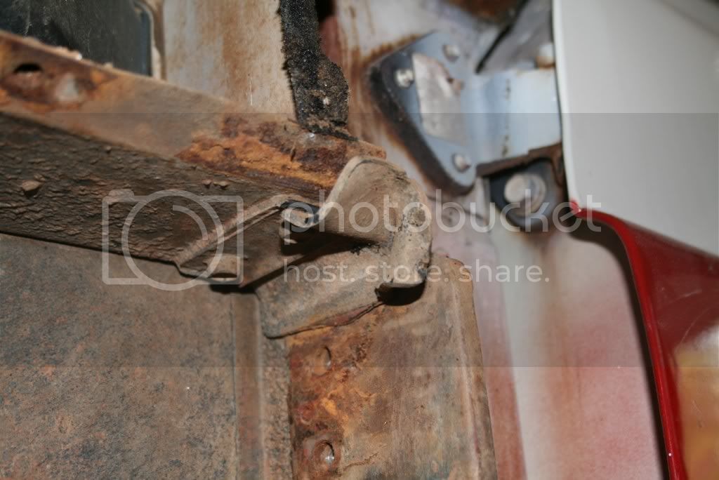

Pics of the rubber seal at the attachment point to the truck.
There is another seal...composed of some sort of gooey stuff at the top of (towards the windshield) the rubber seal.

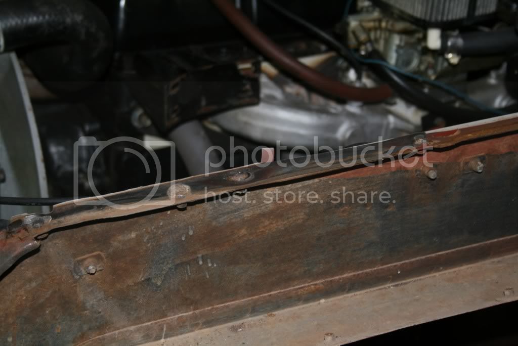

Fender off:
No seal between two fender parts that I can tell as of yet. Might change as inkpot's had body filler in there:
Foam sealer on fender that meets up with upright support (see first pic for location):
Bump stops to be installed after fender to allow hood to rest on them. Two total needed.

They came with the truck. Sorry. But all they are is solid rubber in that shapw with a hole in the middle for a phillips head screw. You could easily make them if they are not available. I can take some measurements for you if you need to go that route.

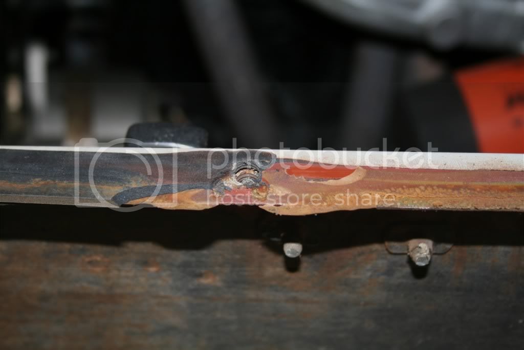

Here is another angle:
perfect...............can you please tell me what is the number of the screw hole counting from the grill back?.........$OR has them at over 10$ a pop not including shipping :( ........hmmmmm,
might give a try at a rubber block and see how it goes....will let you know...........thanks again Heather:)
Lou
They are the smaller 2 holes. Numbers 2 and 8 from the grill up to the winshield. The rubber reminds me of a sanding block if that helps with the density of the rubber to use.
