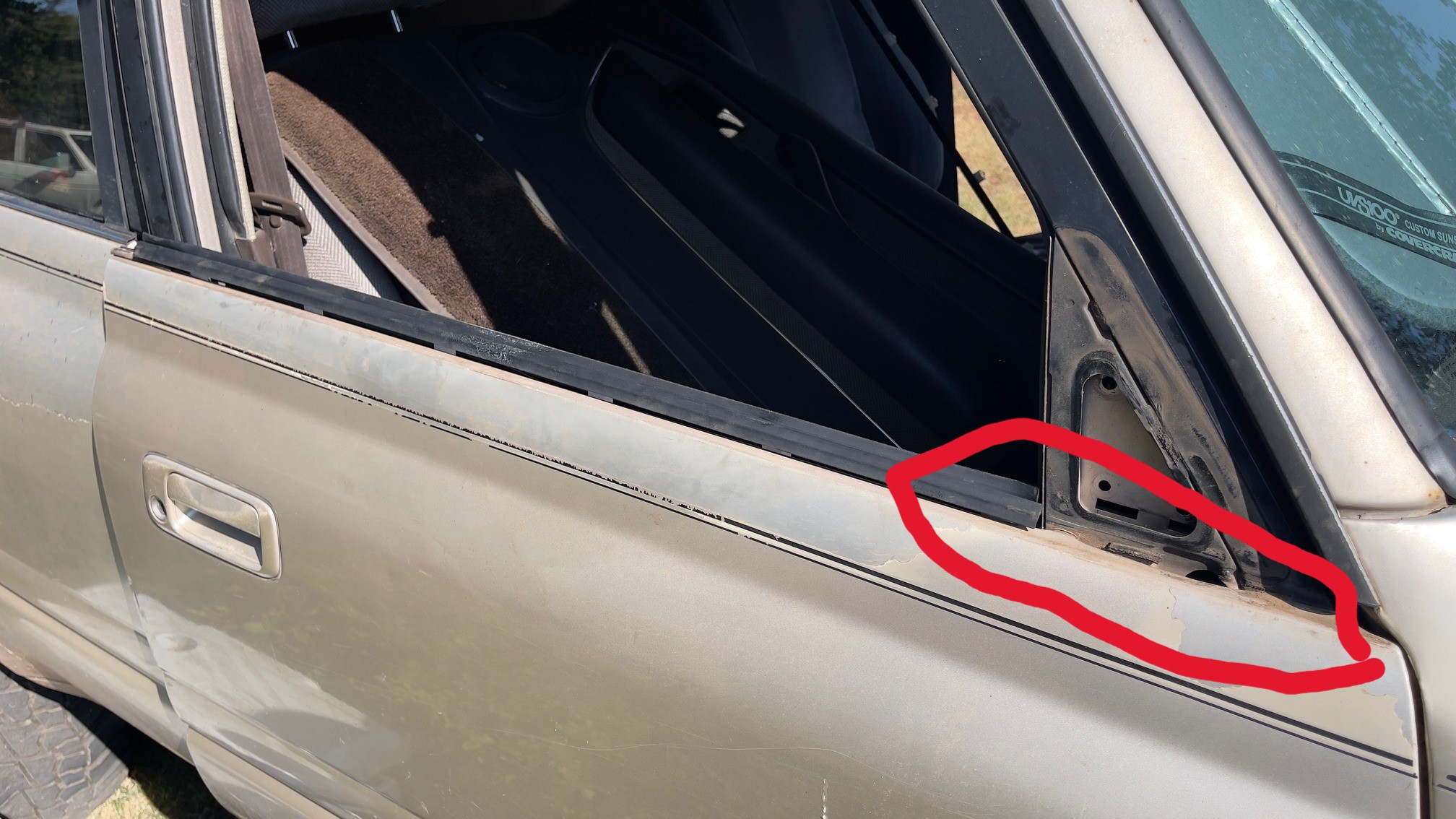

I ordered what I thought was the Outer weatherstrip (68210-60020-Left & 68160-60020 Right) for the '94 to replace the OEM weatherstrip.
First photo shows original outer weatherstrip from under the outer mirror to the rear of the door.
What I got is not the same length. Anyone have the correct p/n for left and right front door?

It's called a Moulding Assembly, Door Belt (sometimes spelled as Molding)
Right Front: 75710-60021
Left front: 75720-60021
You can use Toyotapartsdeal (or Amayama or Partsouq overseas) to help find part numbers.

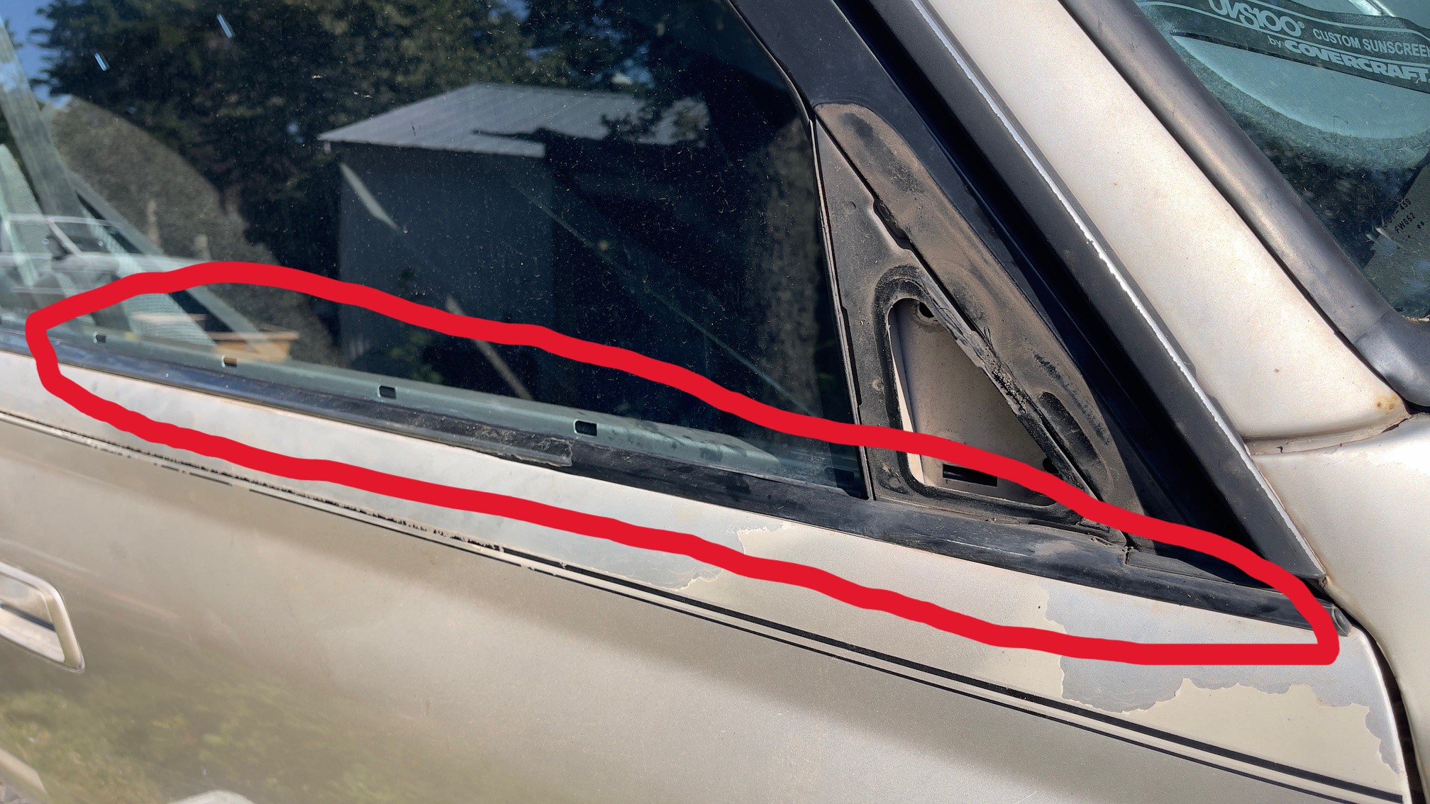

I have driver new oem if you still need.
I ordered a full set from partsouq for like $270 inner and outer for all 4 windows.
Front molding outer RH 75710-60021 $38.24
Front molding outer LH 75720-60021 $38.16
Rear molding outer LH 75740-60020 $41.89
Rear molding outer RH 75730-60020 $42.84
Front inner seal/felt LH/RH 68170-60030 $27.18 you need two of these one for each front window.
Rear inner seal/felt RH 68190-60011 $27.18
Rear inner seal/felt LH 68240-60050 $25.41
I just ordered but they have a few reviews from earlier this summer that sound like the install and look is fine. Time will tell how they wear but I'll start with the $49 option. Mine arrive Saturday so I'll drop my first take review then.
Have you actually purchased these? If so how long have you had them installed. How is the fit? How do they hold up to the weather and UV?
Got these installed. Fit is near perfect out of the box. The only issue is the clips aren't aligned with the slots in the door so you'll need to gently pop and slide them to align. They're also chrome which is a little annoying but I'll live. notice significantly less moisture inside the door behind the cards since replacing so I'll call it a win. Now I need to find a pair for the rear sliding windows.
