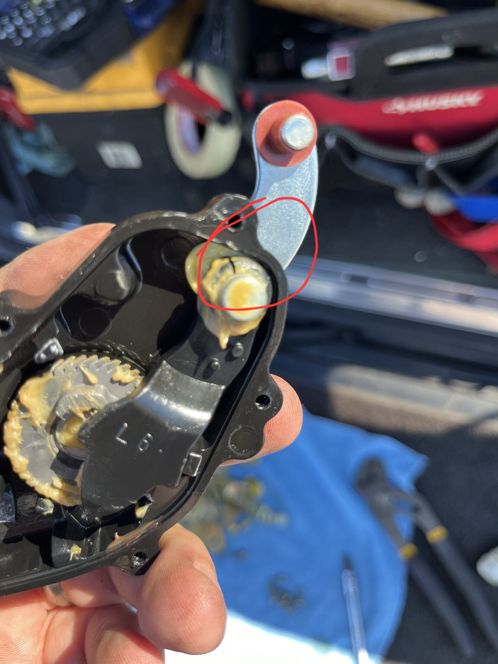

Hi guys!
Took apart my front driver door actuator and replaced the brushless motor on the inside. I thought I was done, put it back together, plugged it in before securing it in the door, and clicked Lock/Unlock button. It motor does work, but it doesn't move the assembly, it tries, but it won't move from one position to another.
Are there other common issues with these actuators that I am not aware of?
Thank you for any tips in advance!

I am having the same issue with my back hatch and rear left door. I can feel the actuator so I realize the motors I ordered will not fix my issue. I pulled them apart today and found a small crack in the internal arm.
This plastic piece is cracked. It has some teeth to grip which clearly fail with the crack. You might be able to JB Weld it but there are threads in the forum with suggestions for a fix.
I had this problem with my rear hatch actuator. Here is a link to the thread. I am amazed that the date was 2008, so my fix has worked for 17 years. I drilled a very small hole through the plastic and the metal shaft. It was a bit of a pain to do. Then I stuck a small brad into the hole, and I think I put some JB Weld over the ends to keep it from sliding out. This way the arm cannot slip on the shaft.
I ended up getting a guy to make me a 3D print and he made them with carbon fiber infused (or something like that). No issues at all now.
