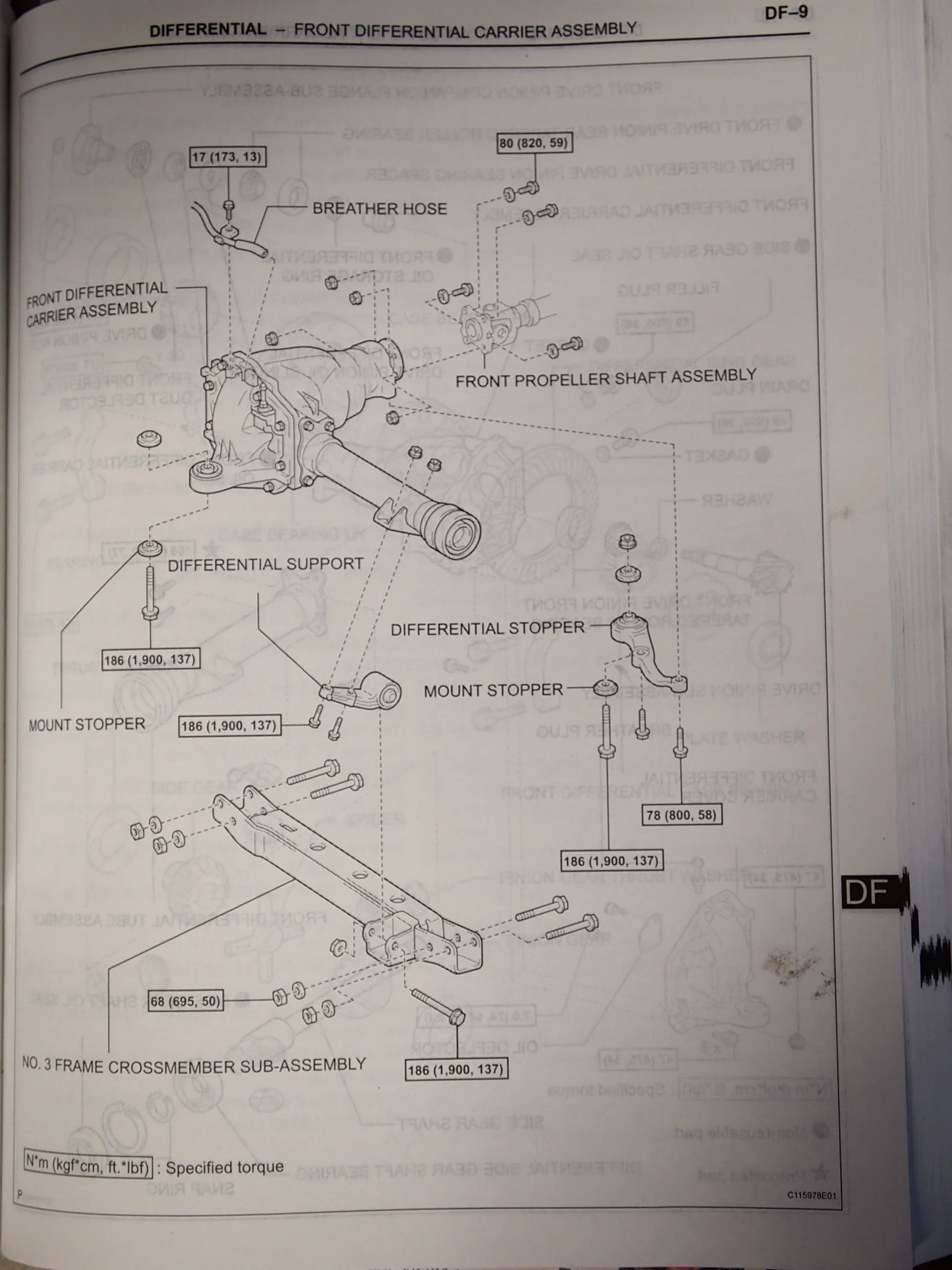

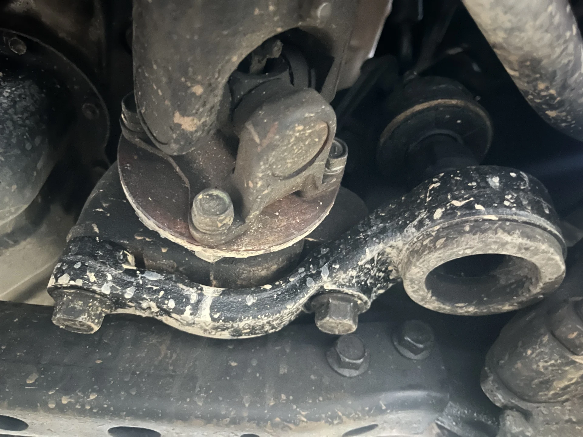

Last Saturday I replaced all of my front differential bushings in my 2000 LX 470 with new oem toyota bushings. I then drove 6.5 hours to Knoxville and went wheeling at windrock. During that time I began hearing a clunking noise that occurred when I took up slack in the drivetrain, shifted from D to R or vice versa and went over bumps. I assumed it was a hub flange or cv since I have a questionable one that makes noise. Well today, after driving home from Knoxville I crawled under the car to find the rear bushing had come apart completely and my differential was resting on the crossmember. I’m confused as to why this happened. All the bushings were torqued to spec and I used an oem toyota part. I originally thought that we left out the top stopper plate but it was on there. Not a new part but it appears to be in decent shape. Does anyone have any idea what happened?
This shows the old bushing compared to the new destroyed one
wow, that is a surprising failure. i wonder if you might have gotten a counterfeit part?
Doubtful because I literally got it straight from the dealership. It look like I left off a stopper plate on the bolt that holds the mount to the frame
