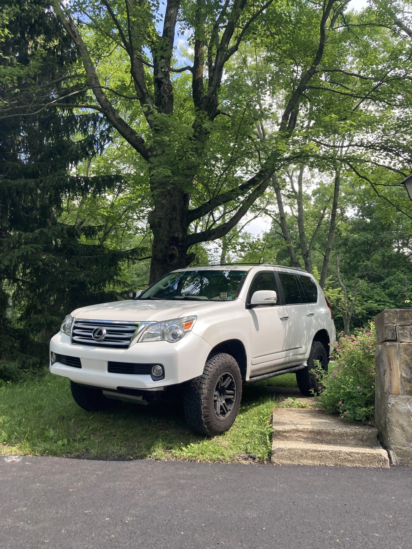

Front bumper chop on my 13.
As slightly different take, looks great.
What size wheels and tires are you running?
I used a Dremel with a cut off wheel when I did the bumper cut on my 470. Went back and carefully cleaned up the edge with a sanding block and 120grit.
cant remember if i posted here, but it did it on my 2012. used a big cutting wheel, was probably overkill. then went back and cleaned it a little with a box cutter. added black door trim after to finish it off. came out nice. 10/10 recommend doing
Surform files work great for leveling out an uneven cut on bumpers or any other plastic.
You'll be able to get a nice straight trim line all the way across.

Are those white, dangly underbits visible beneath the driver's fog light? I ran into that with my Victory install - white sheet metal easily visible. I hit mine with some rattle can bedliner
I dont believe you can see any dangly underbits. you can see the aluminum crash bar and the white foam in front of it a little bit (unless you remove the foam, I didn't) - but otherwise it's pretty clean looking
