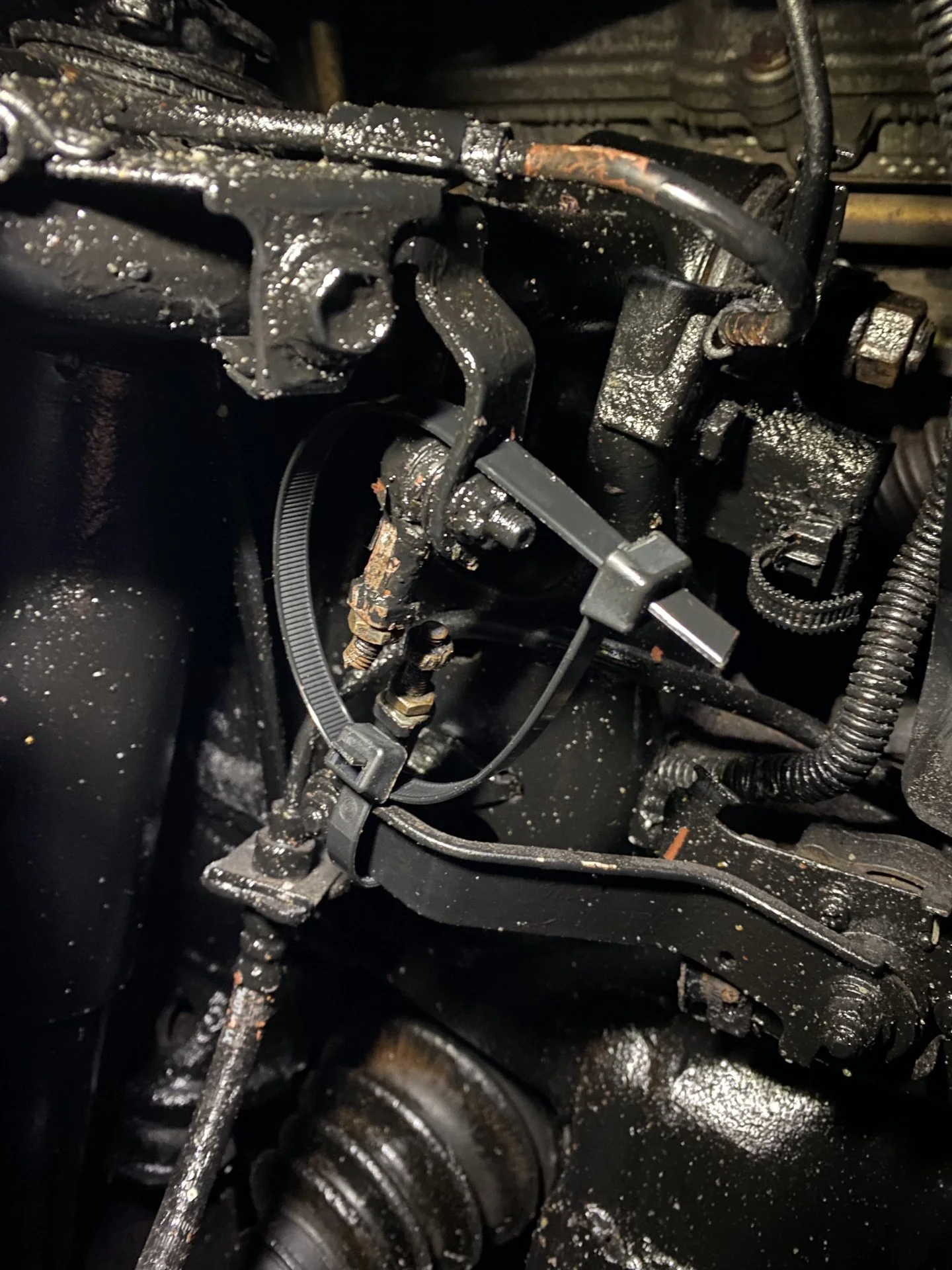

Just use zip ties!
Jokes aside. I cranked a little hard on the heim joint and broke it. It sucks, don’t do what I did. The adjuster nut was worn down so I had to use a vise grip to turn it and it broke.
New one on the way, $80 from Toyota since Partsouq is sold out of that side for some reason.

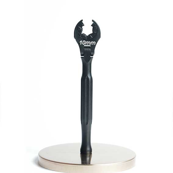

I also have this tool on order which should make adjusting a ton easier:

@Red Beard it looks like you did more than just snapping the bolt. A bit generous with the oil?
It should not be moving in the bracket as it measures the height.
Hahaha thats the FluidFilm Black undercoating I had recently got applied before that photo.

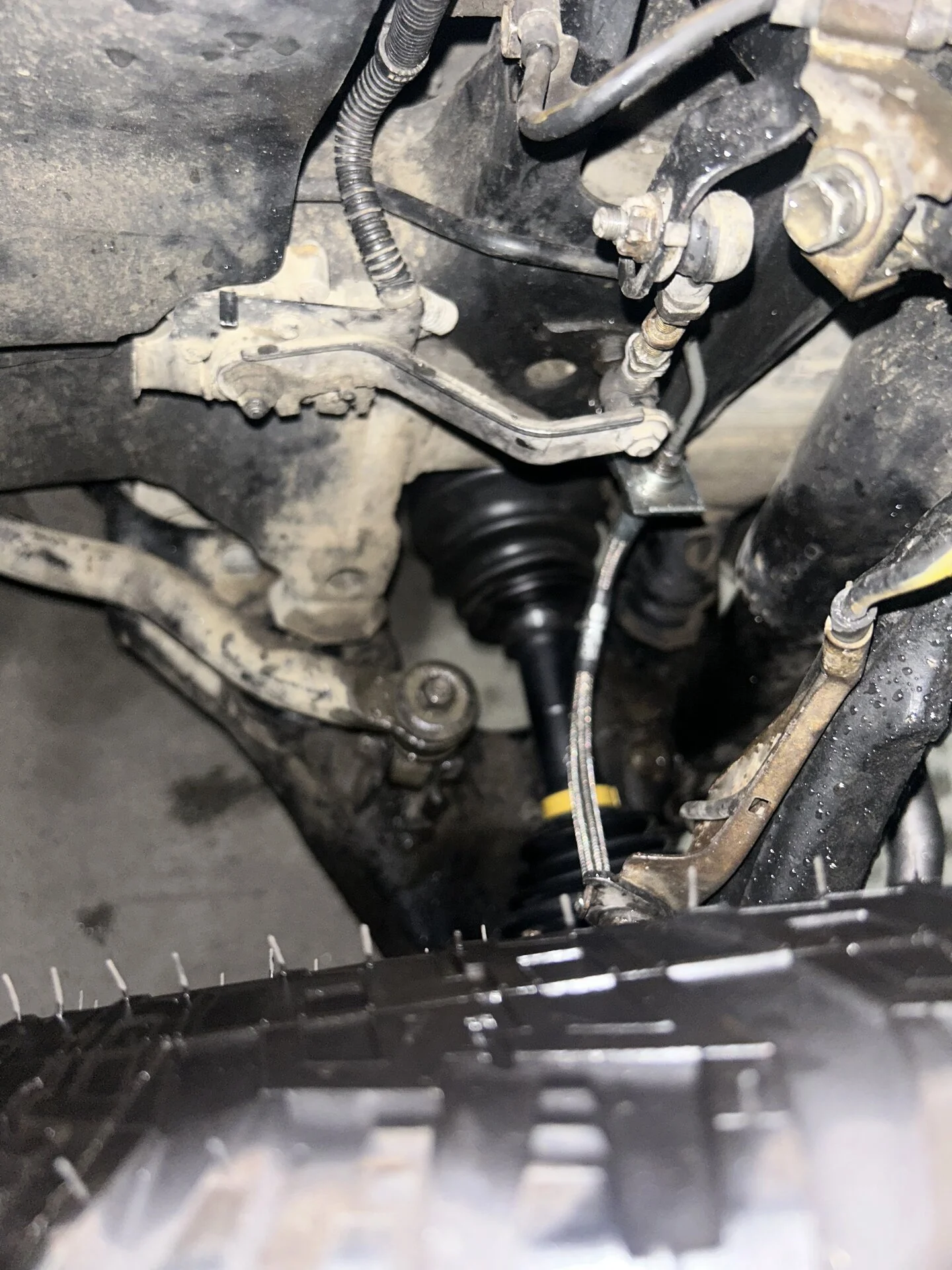

3. When removing the UCA bushings on both sides I accidently bent the brackets that attach to the sensor arms. I tried to align them as straight as I could but I fear that the slight misalignment is causing AHC height issues. Unsure how to fix this other than buying new UCAs or even sensor arm linkage. Photos below of brackets prior to heimbolt adjustment.
