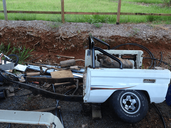

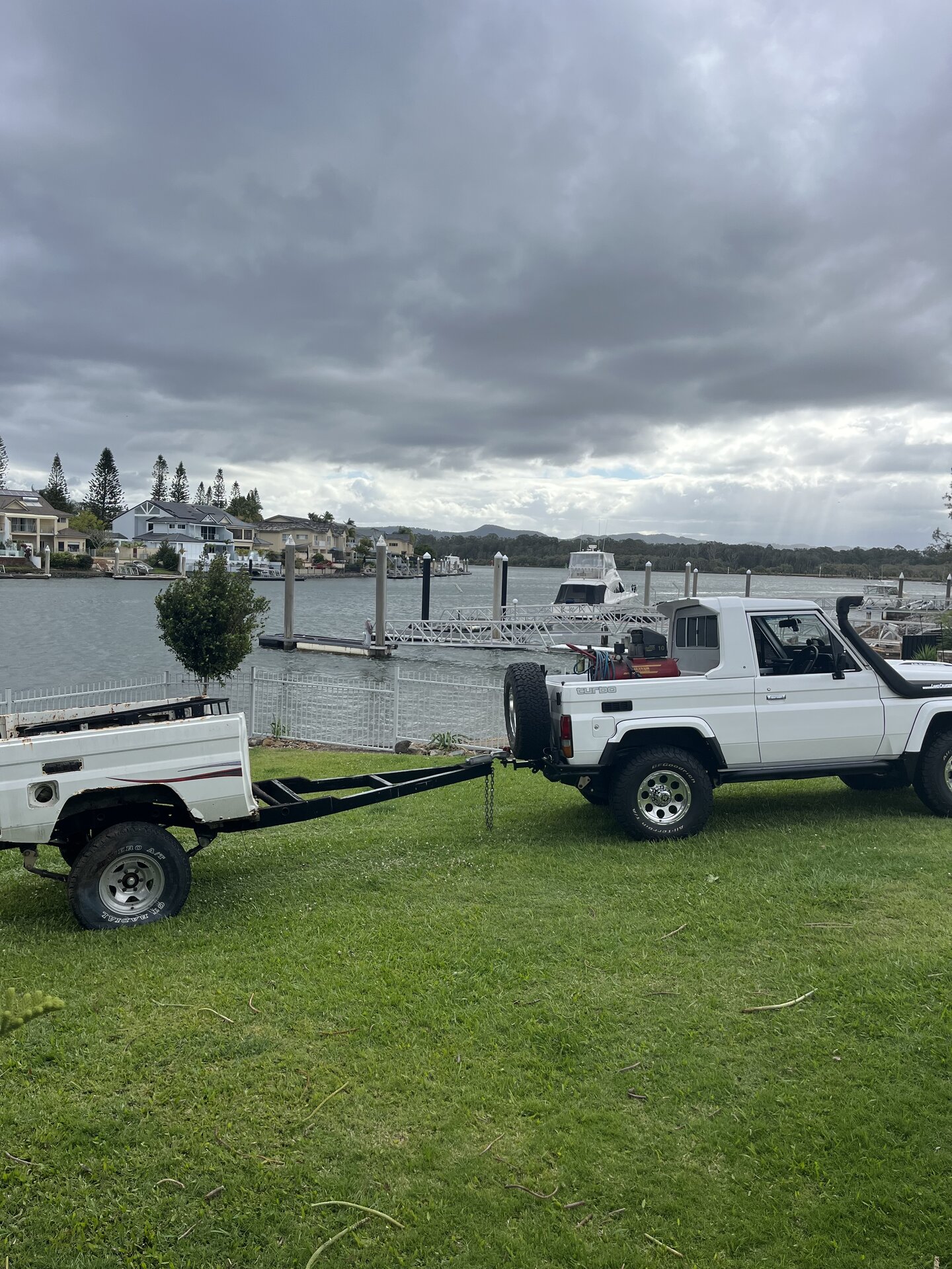

From Wreck to Uluru....Aussie adventure trailer
Living Life got the better of me. Moving house, then renovating. But have dragged the trailer build along with me. It’s been sitting for years in the yard.
The chassis paint system was not as good as they claimed either. The system I used on my car build (rust converter, dewax/rust inhibitor, high build 2pac primer then 2pac Ute liner) is far superior and still looks brand new and the chassis coat kit for the trailer broke down within 3 years.

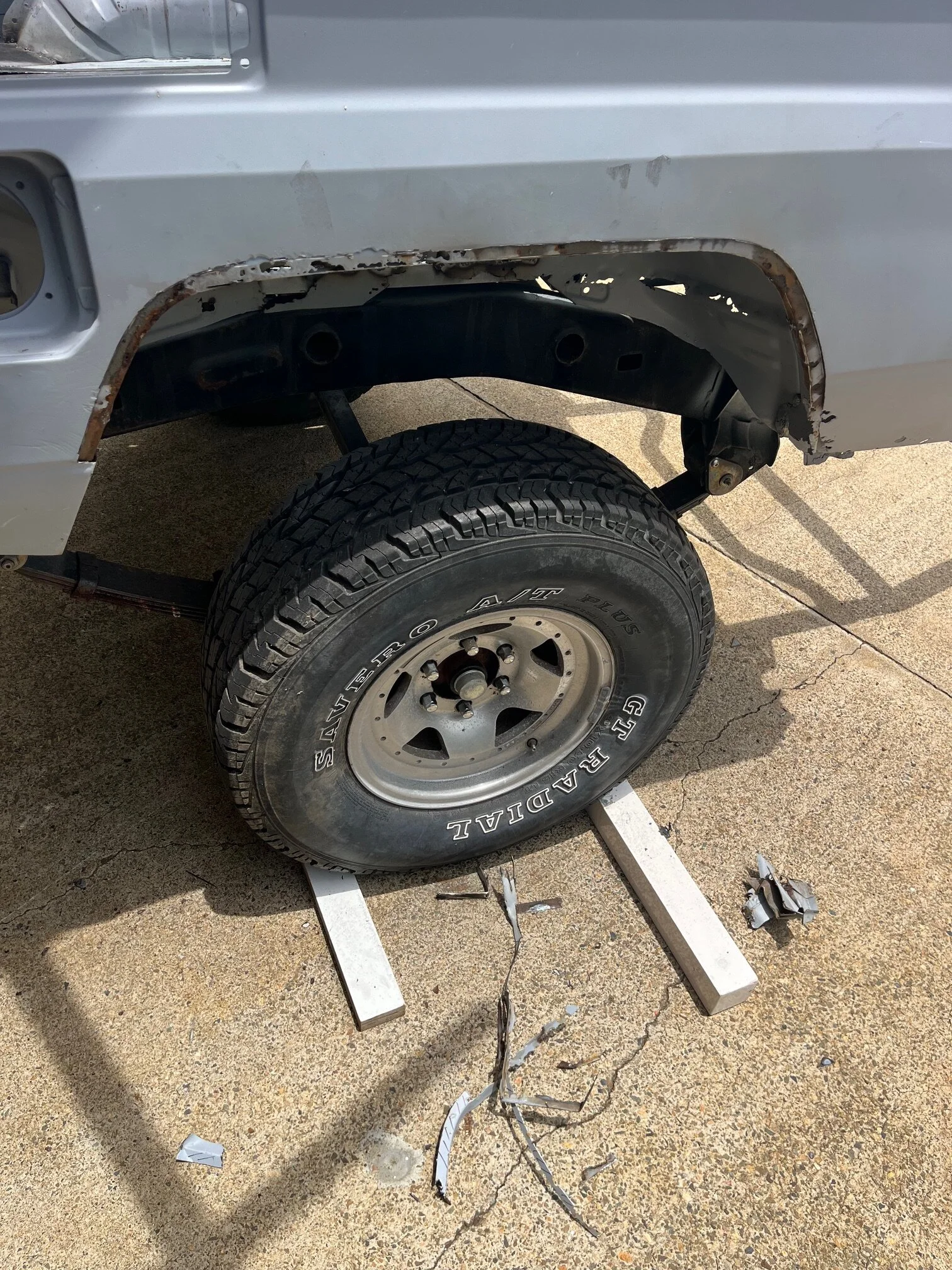

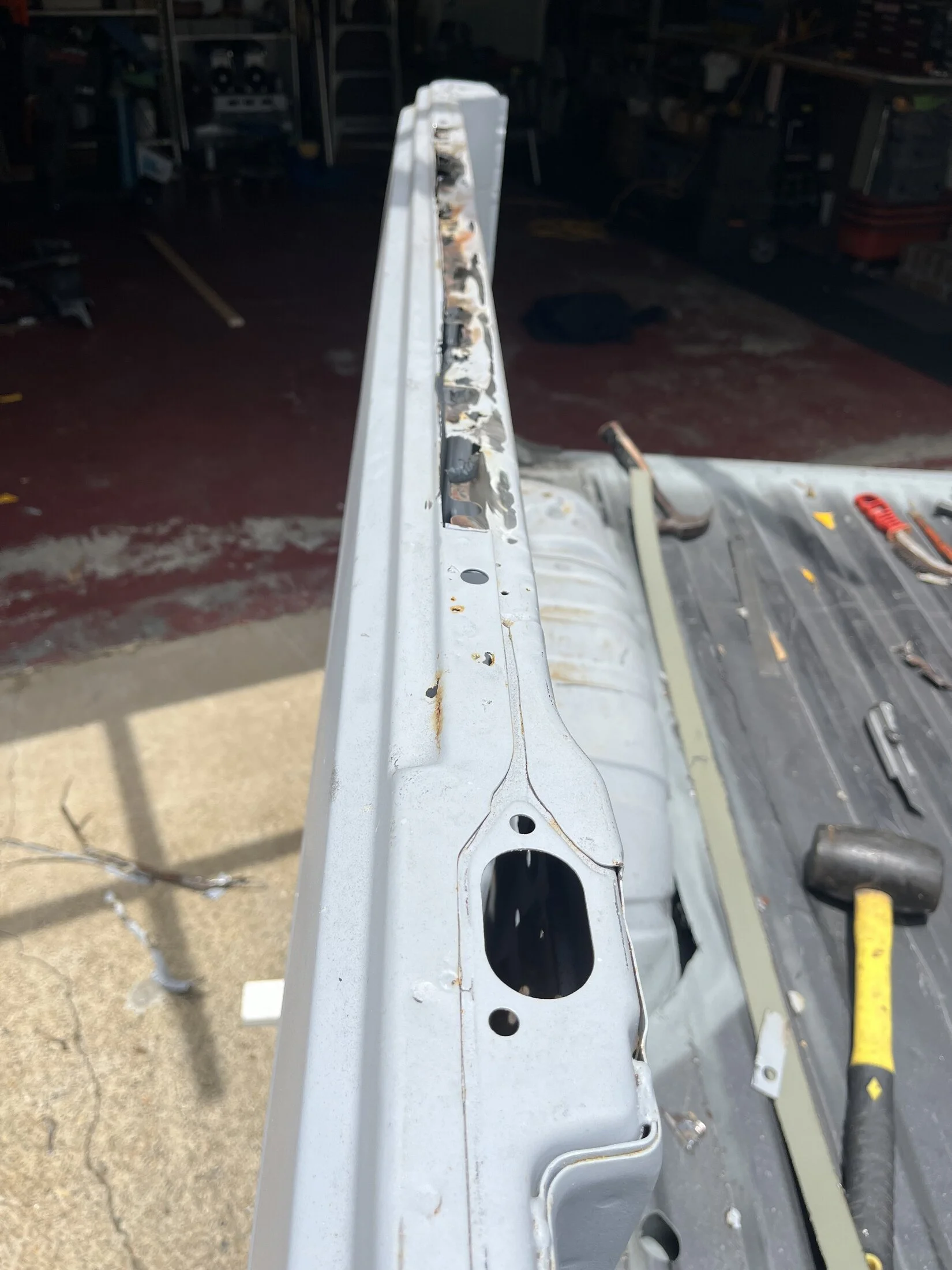

Luckily it’s only got a bit of surface rust in the chassis. The body has a bit more rust and have unbolted it from the chassis and about to send off to be sand blasted and primed so I have a clean canvas.
The plan is:
1) cut and weld patches where there are rust holes.

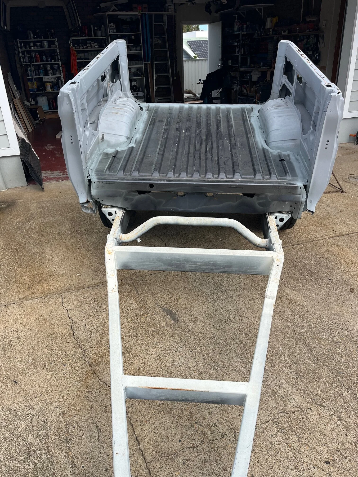

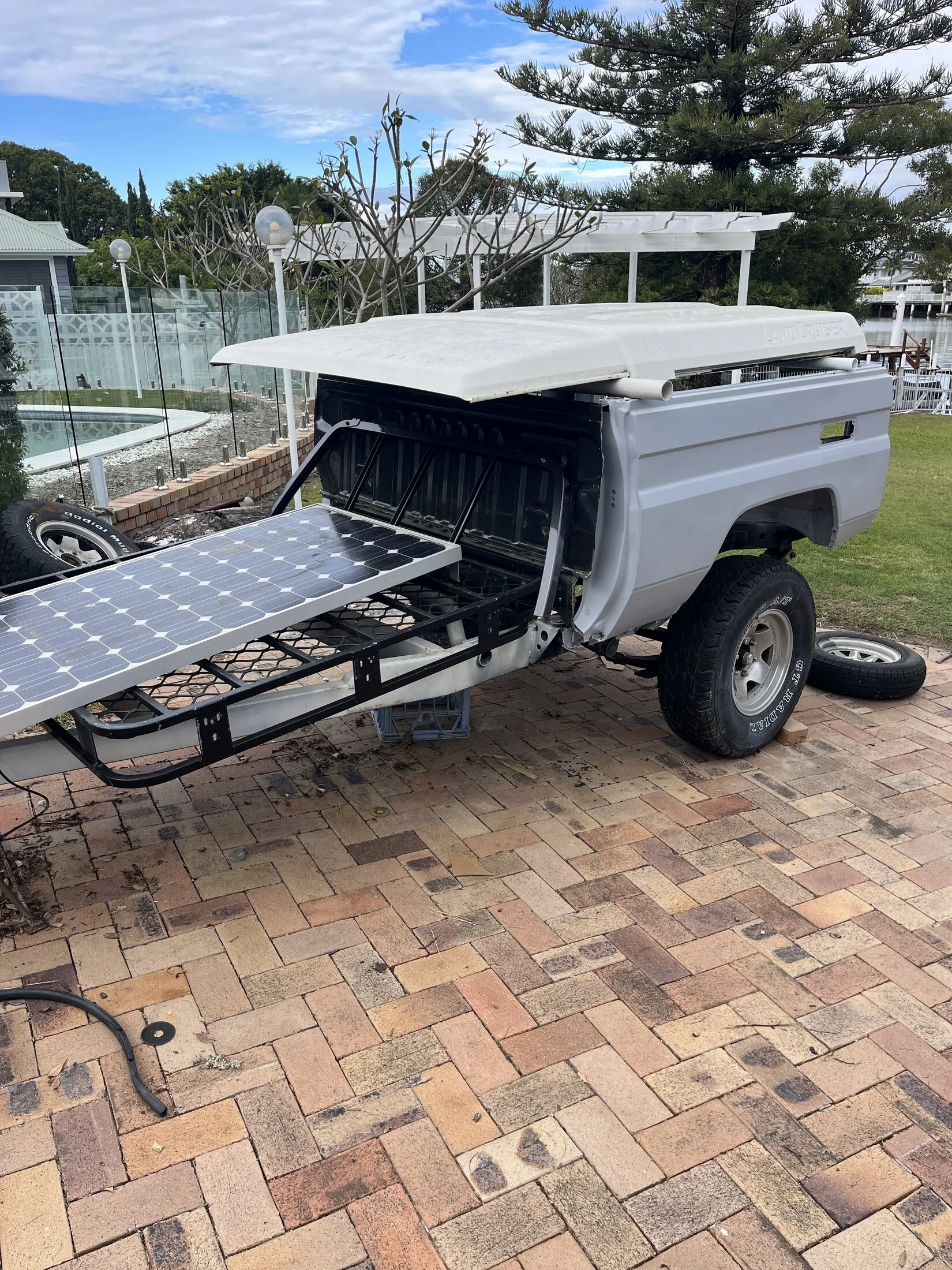

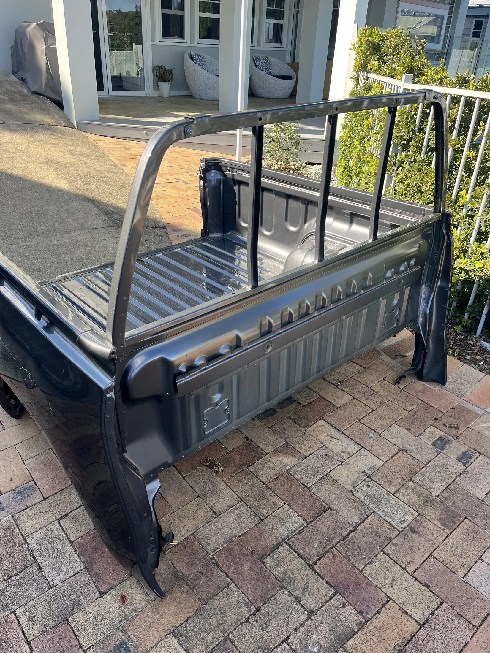

Got the body back from sandblaster all primed ready for next stage.

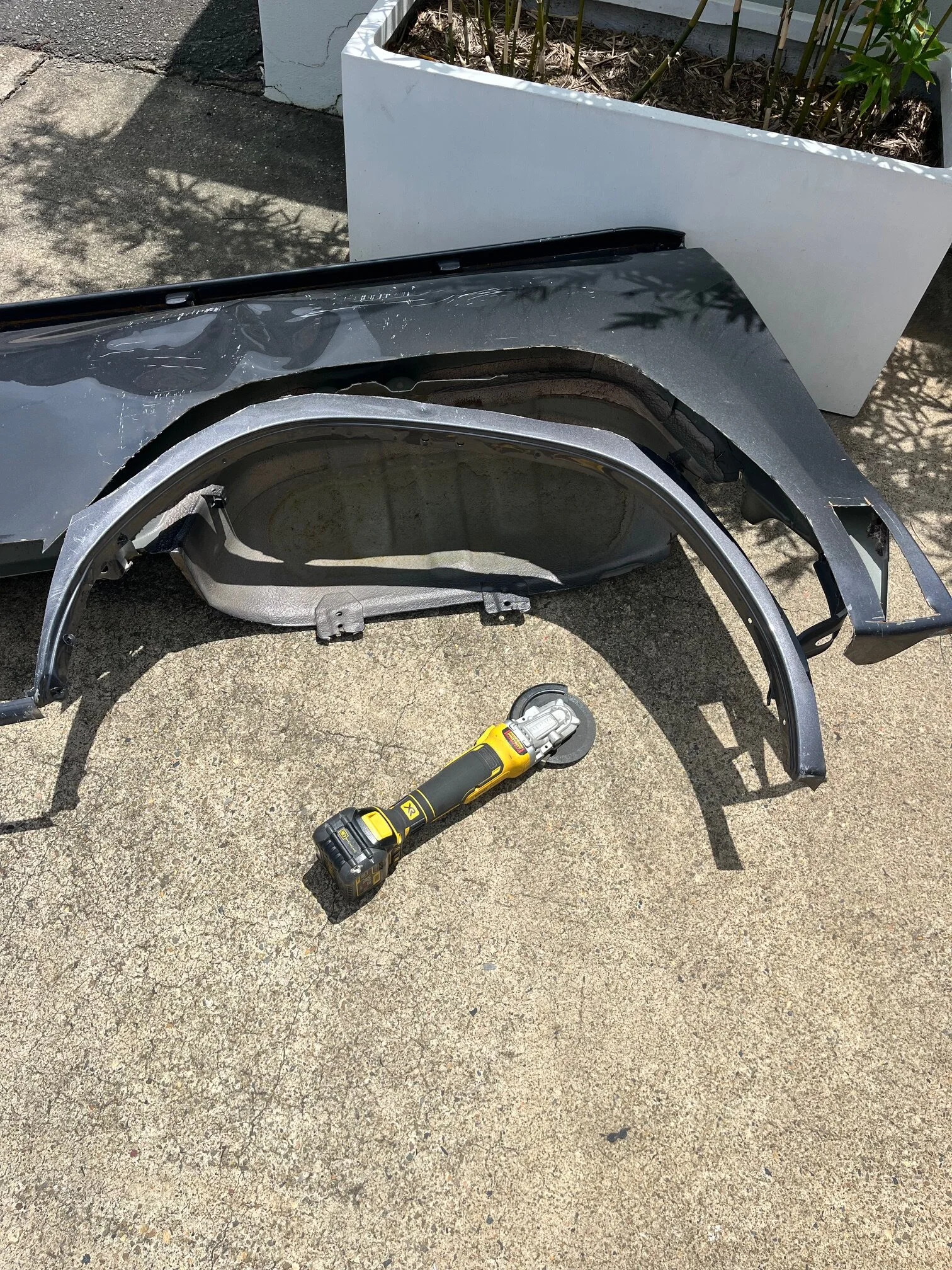

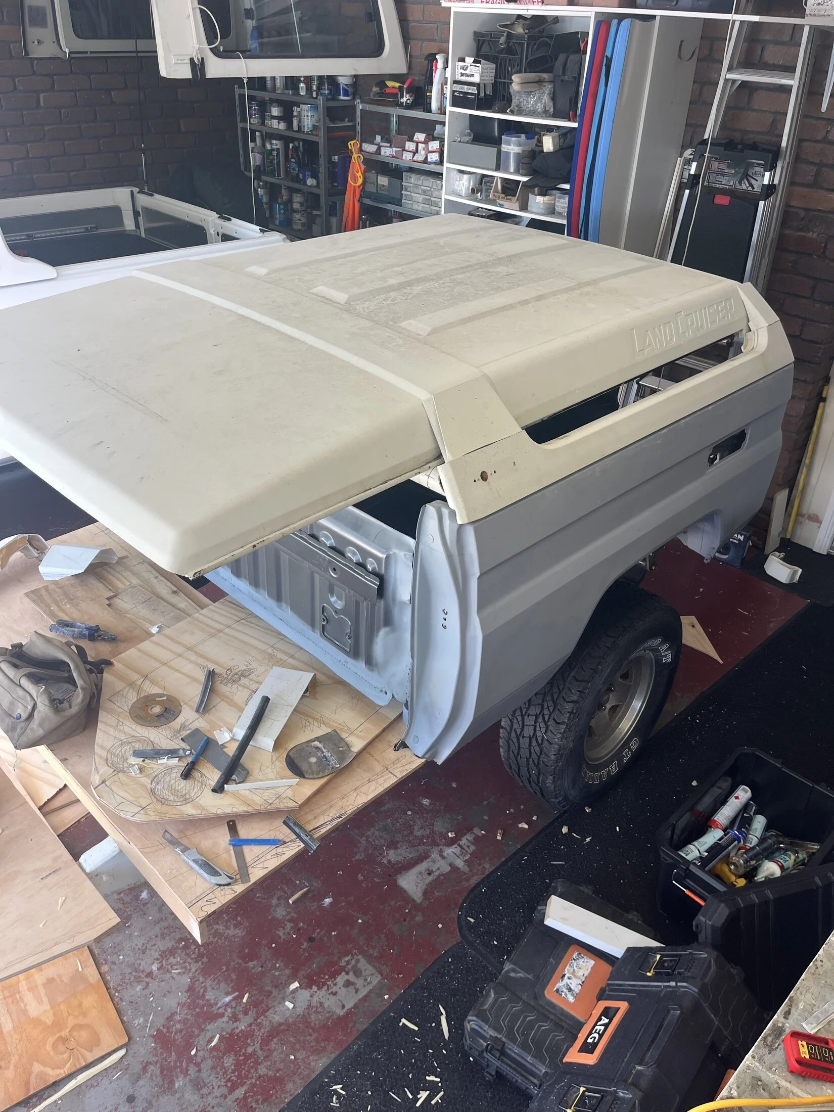

Picked up another roof which turned out better than my original roof so will keep the new roof for my car and paint at a later date if I want to use it.

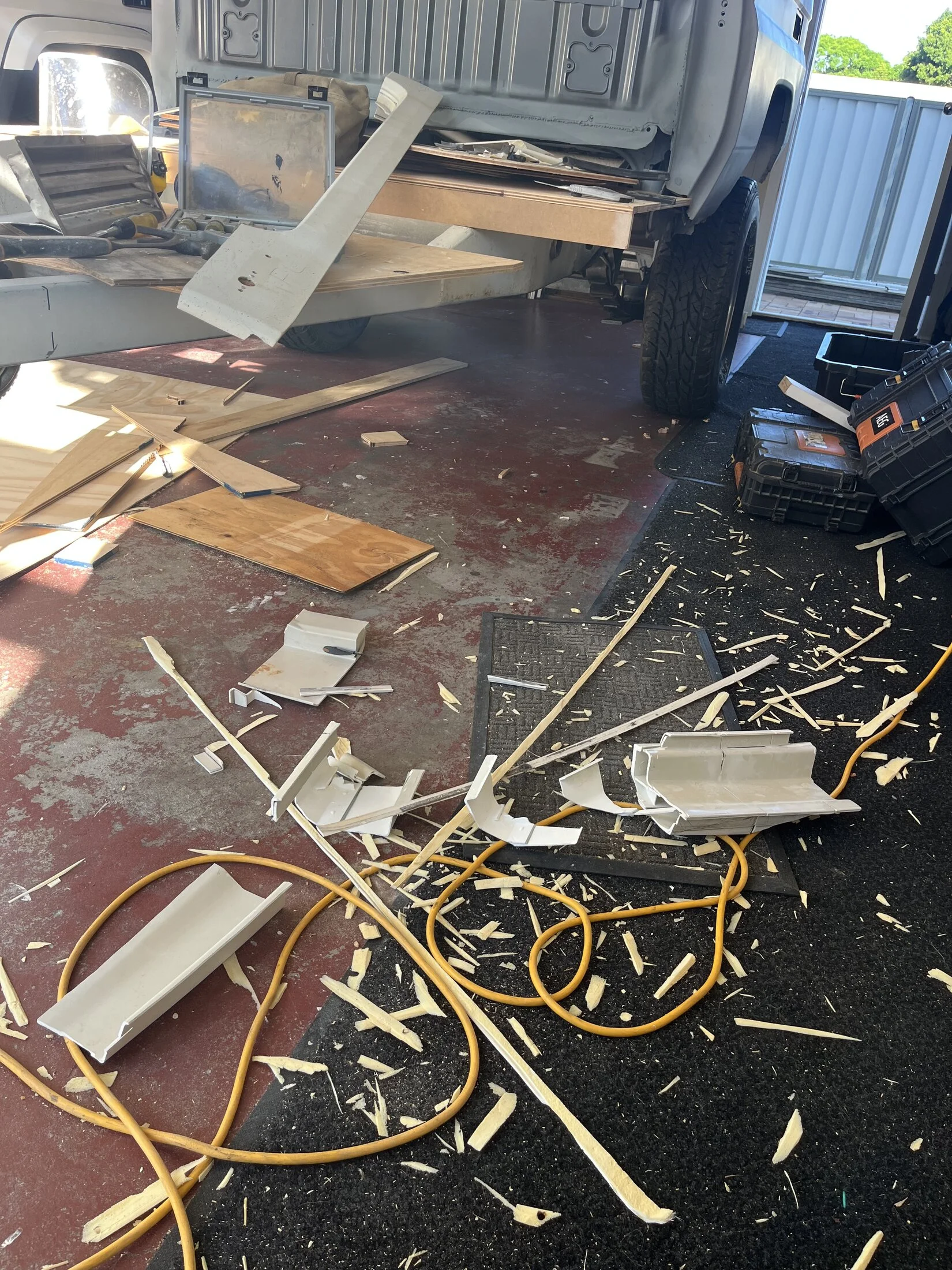

I have sacrificed the original which had damaged seals and window surrounds. It's been cut down to something that resembles the car lines.
I'll fibreglass the bottom lip of the roof back onto the roof lid and hinge it so I can get to the bed and storage underneath. The lid will function similar to a RTT with gas struts and canvas sides. I'll install a 270 deg awning that will wrap down the left hand side and around the back for coverage off the camper.
Now that I know the approx size of the lid I can design and build a box to go at the front of the body to create kitchen storage with a pullout bench to hold a fridge, sink and hotplate.

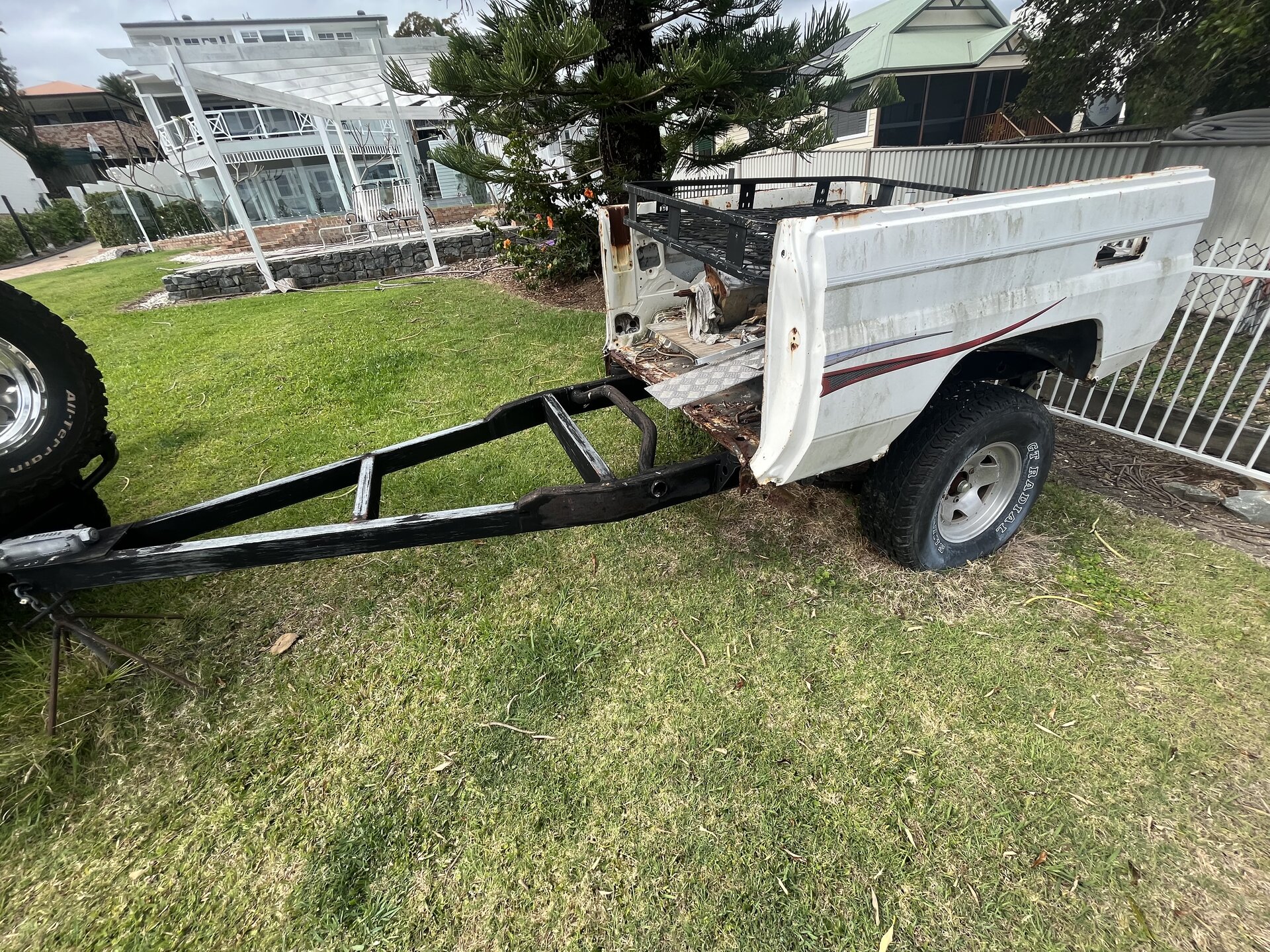

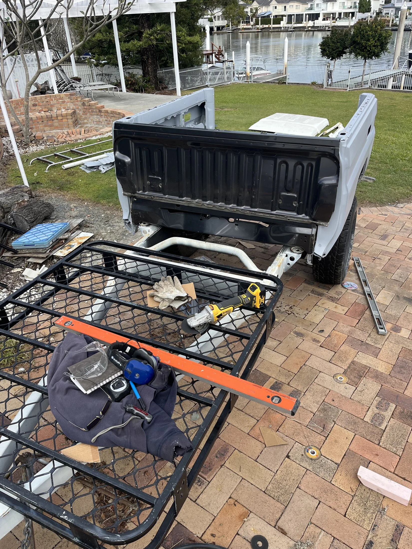

The camper is now all off one donor vehicle - Chassis, body tub, wheels, suspension and roof.

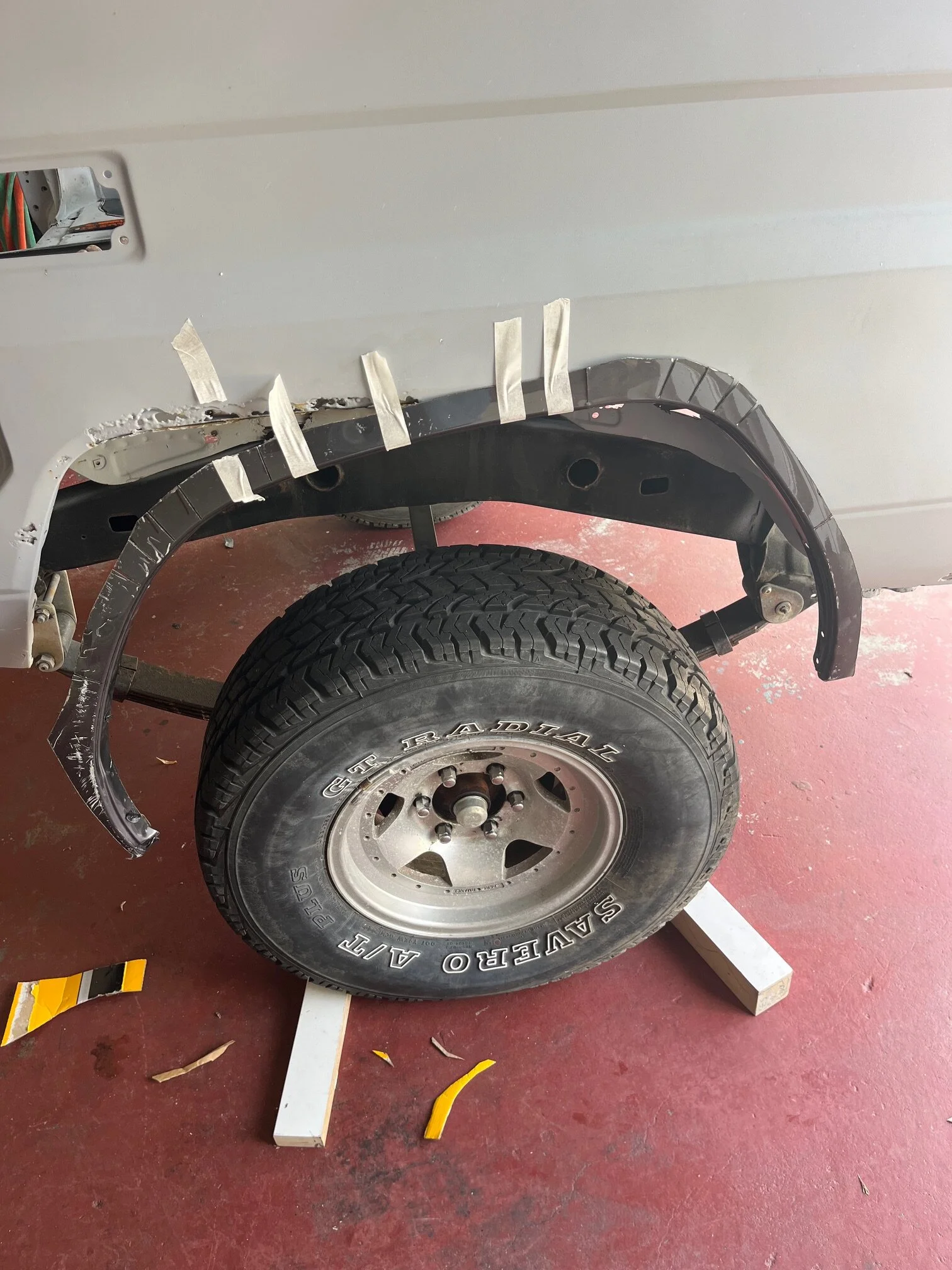

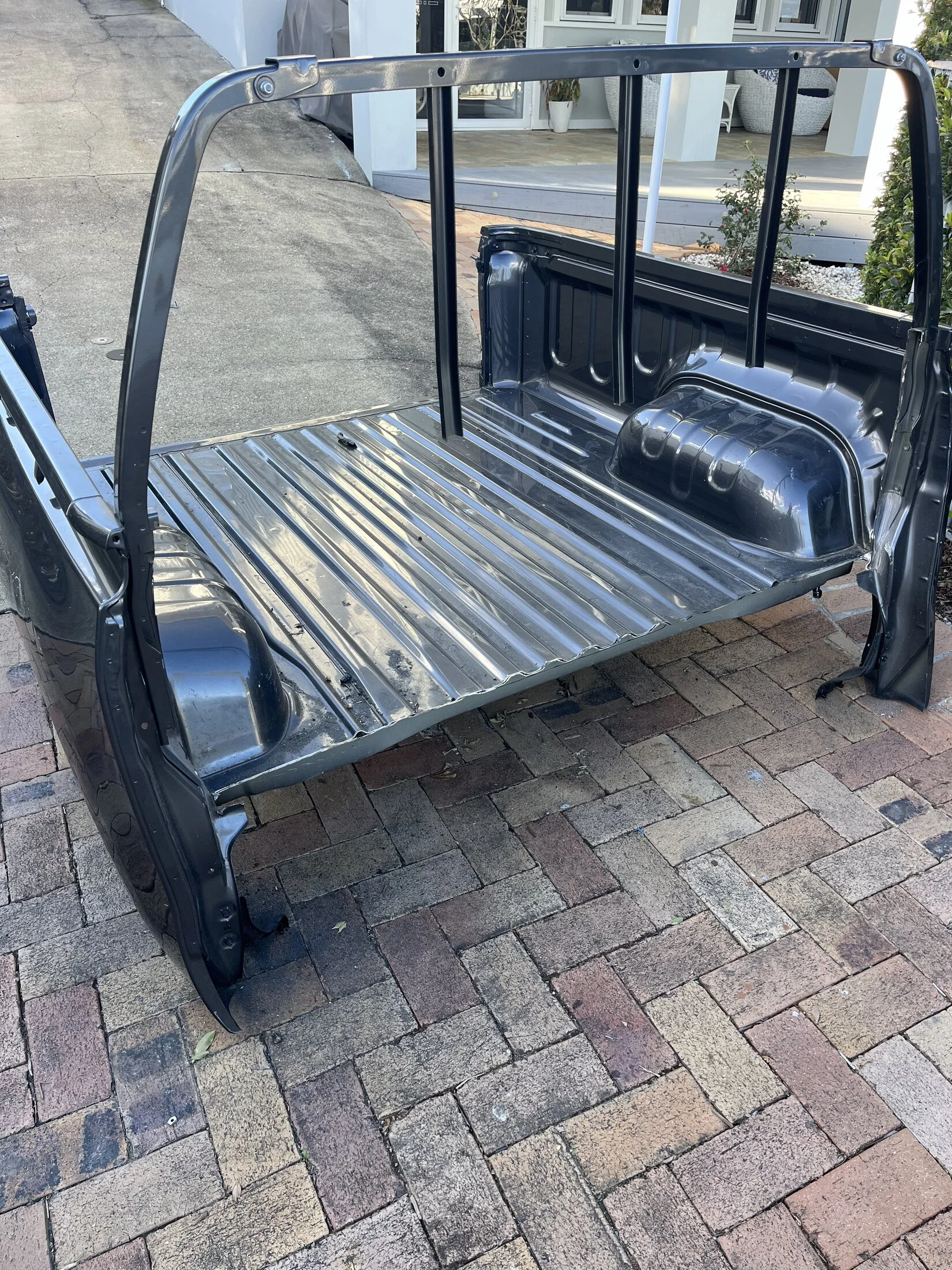

Rather than weld small pieces into floor and wheel arches etc I thought I’d use a whole floor with supports. I want the camper’s side profiles, rear and roof to match my car.
Cut most of the rust from floor. Still need to remove rib supports.

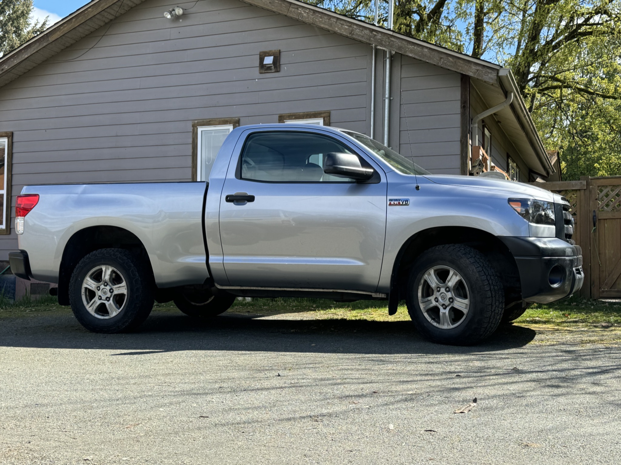

381 Hp, kind of a hot rod. Big fun to go fast in! But going slow is much more affordable.
Yeah, getting under some peoples skin. Alright out of city but contractors are starting to use them everywhere because of tow capacity, so streets are getting choked with them in suburbia which has a lot smaller streets nowadays. Short beds are cool though.

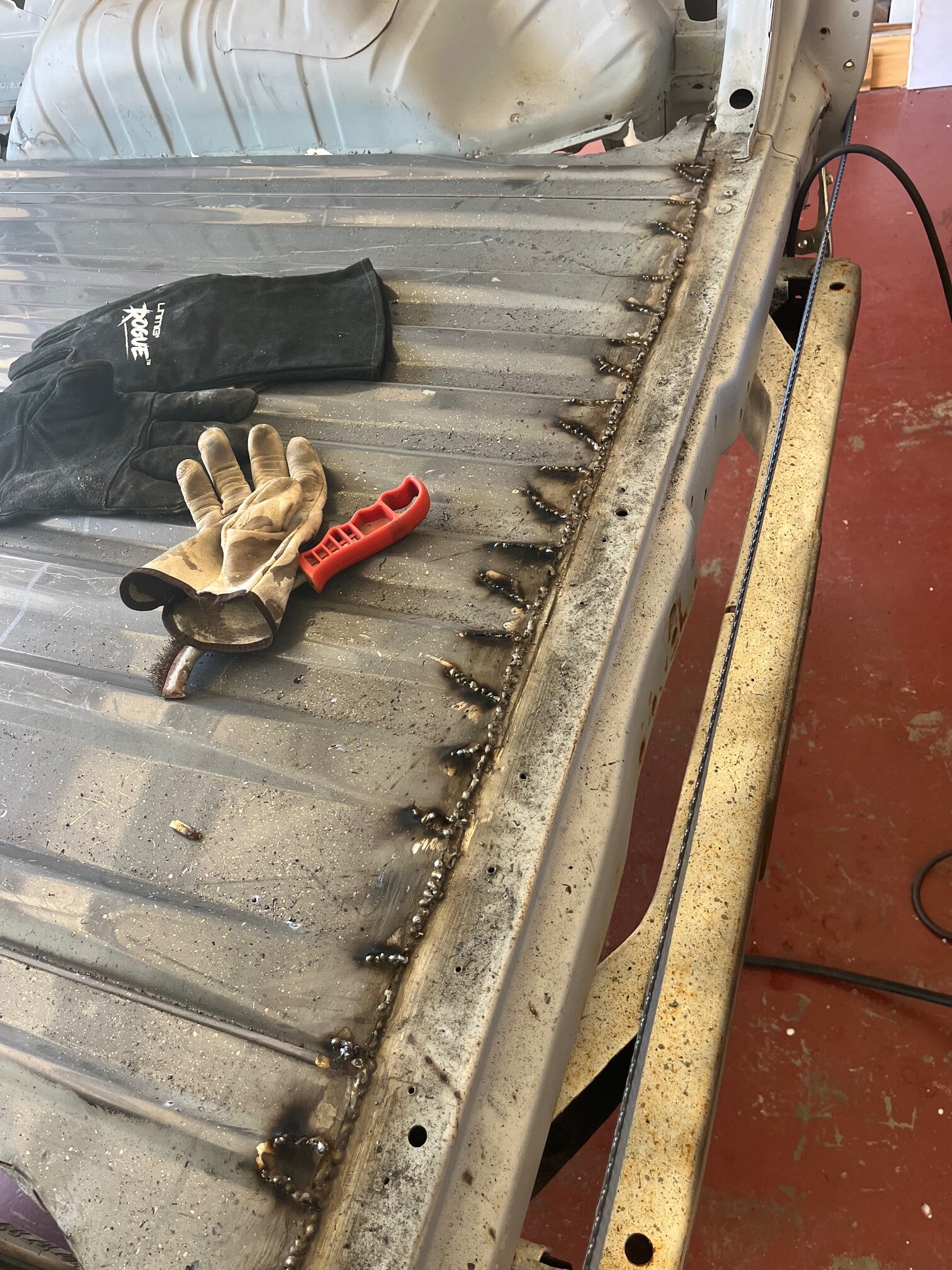

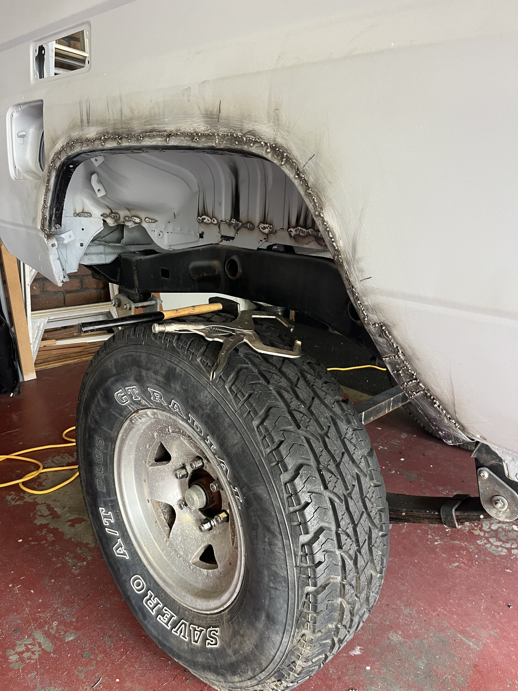

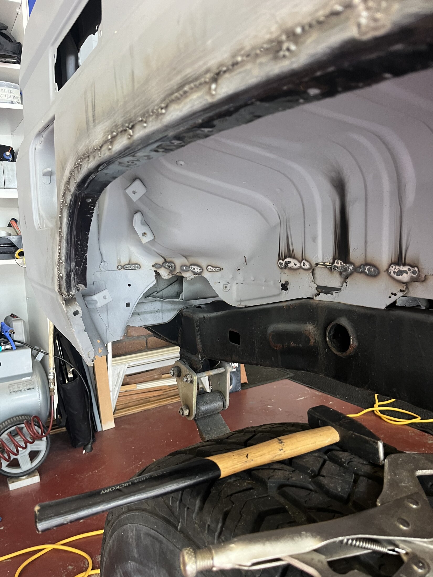

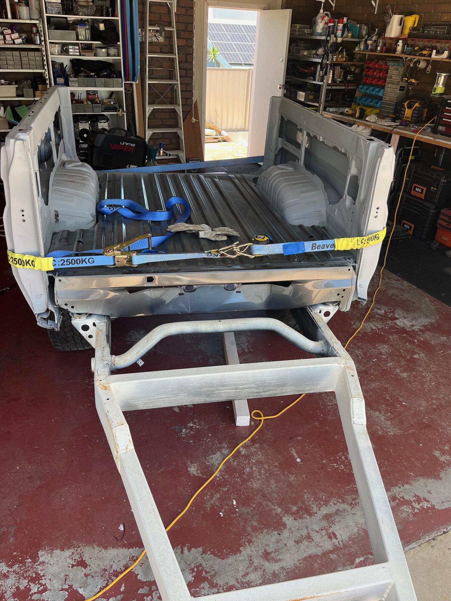

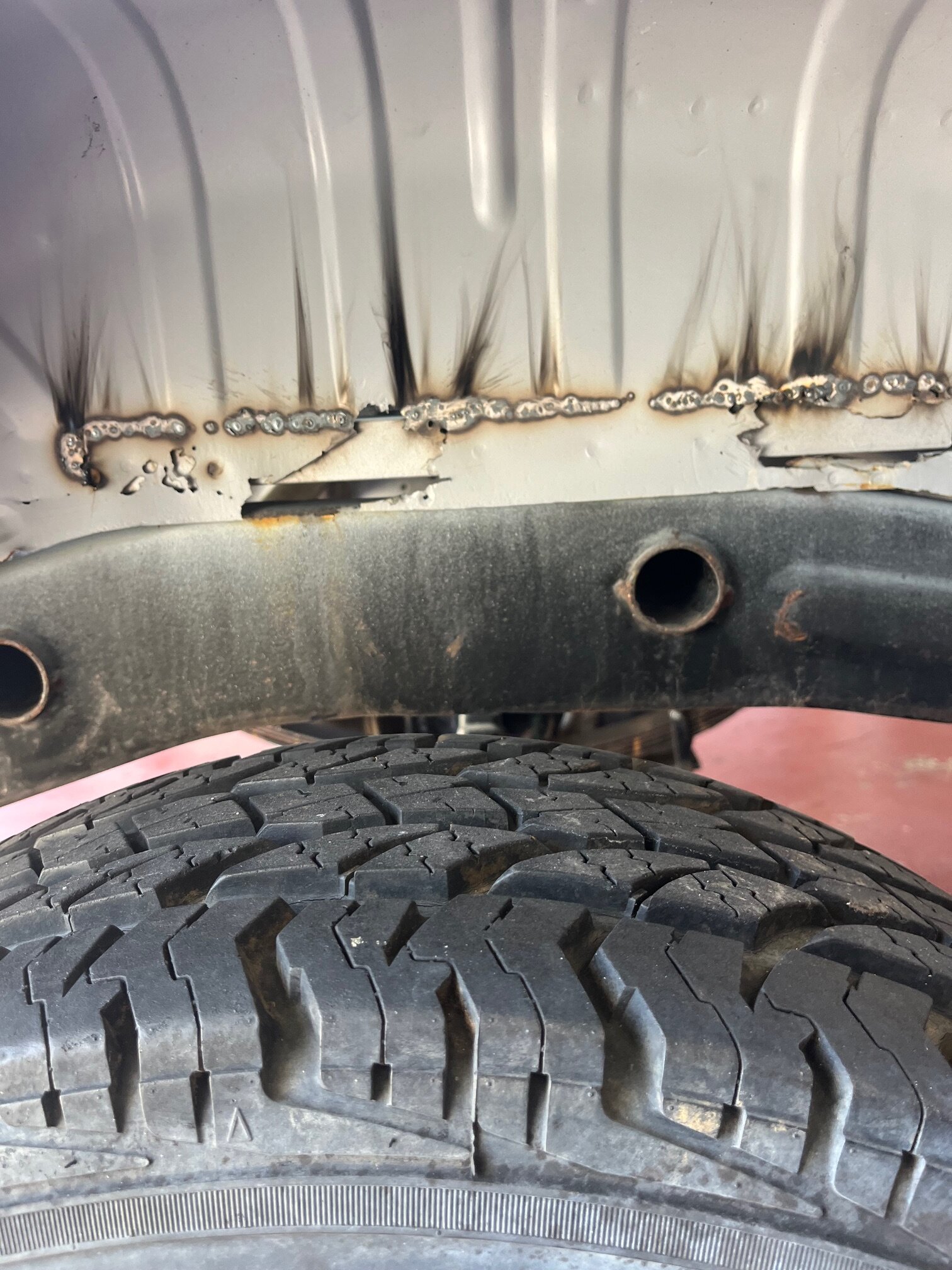

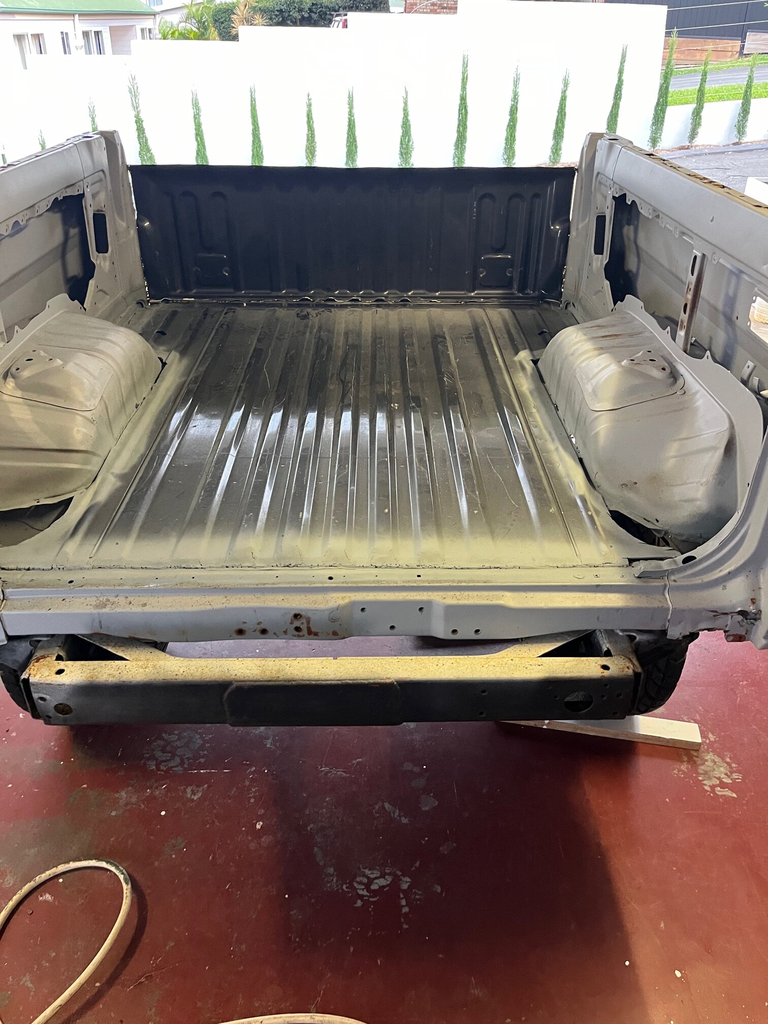

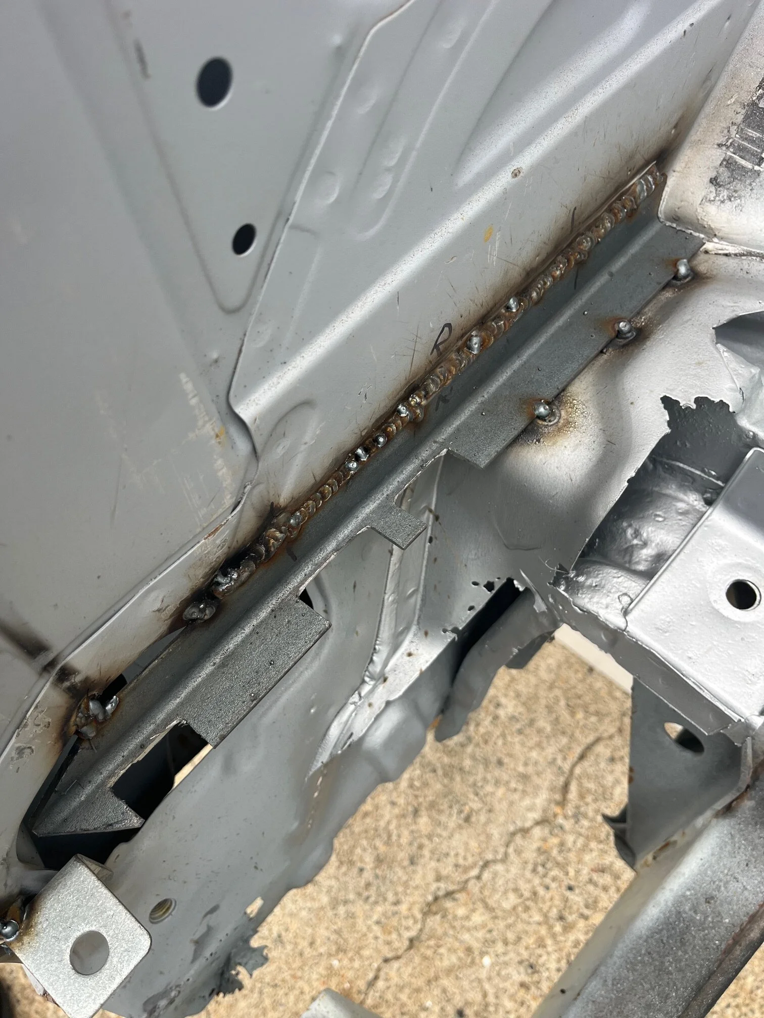

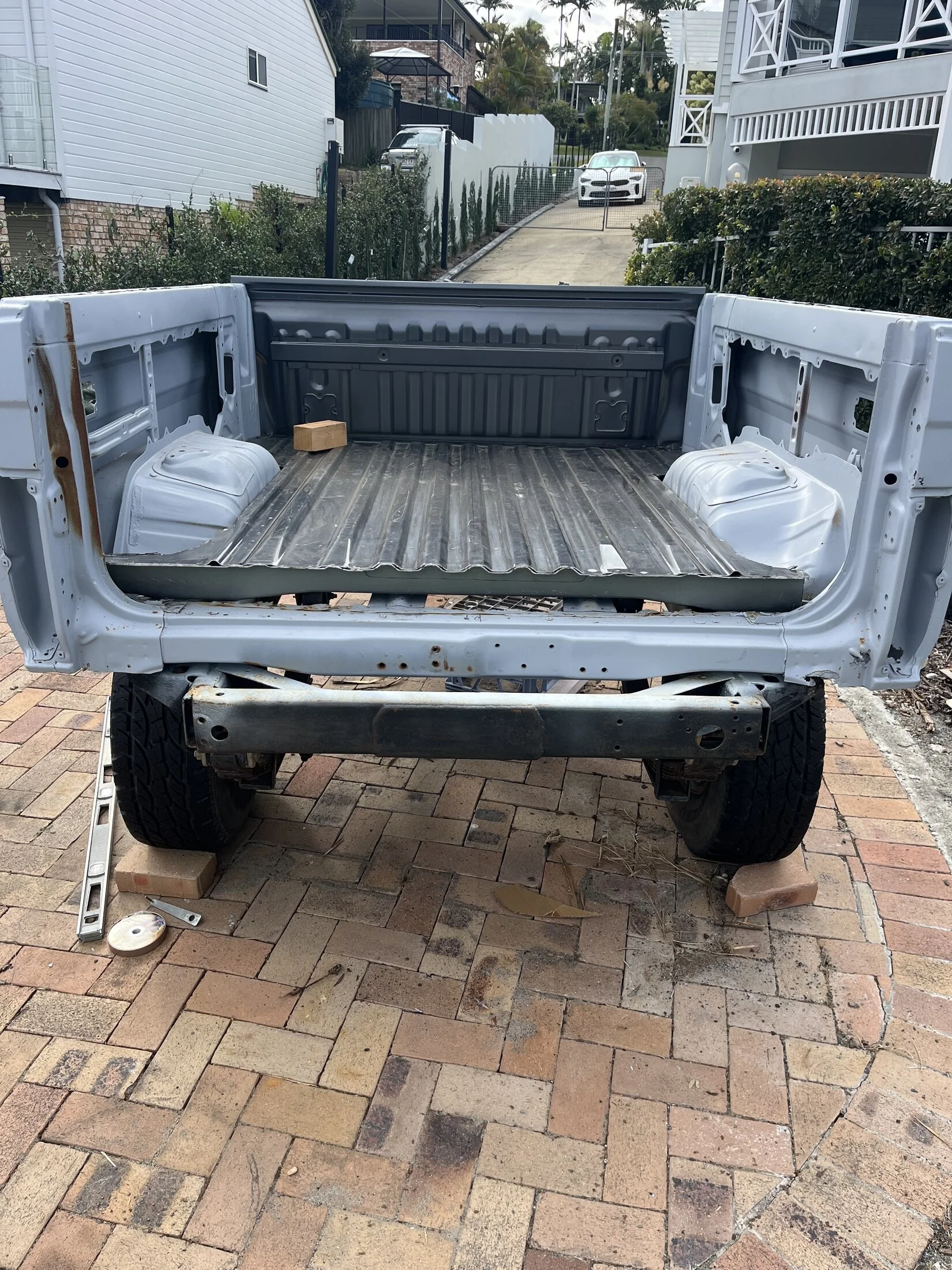

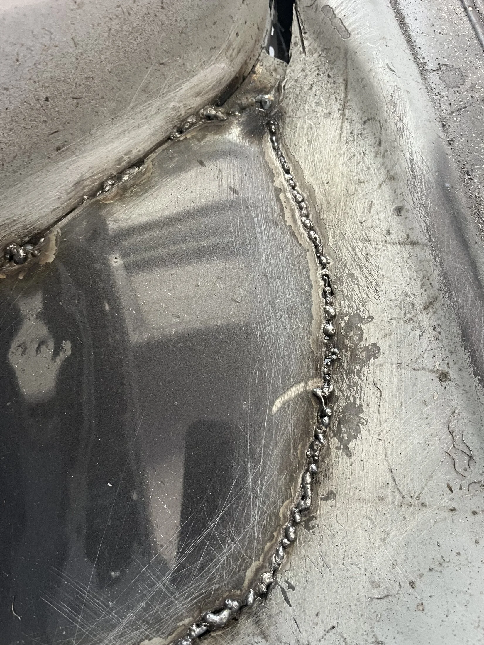

Cut all the sub floor so the new tub fits snug down in place. Welded support stiffeners to wheel arches and at front for structural reasons.
I know my welding has a long way to go but the penetration is good without blowouts and I've yet to grind back and fill in some spots.
Penetration.
I used my car (same tub) to get exact measurements, then used a heavy duty cargo ratchet strap to pull the bottom in about 15mm and to square it up before welding floor in place.

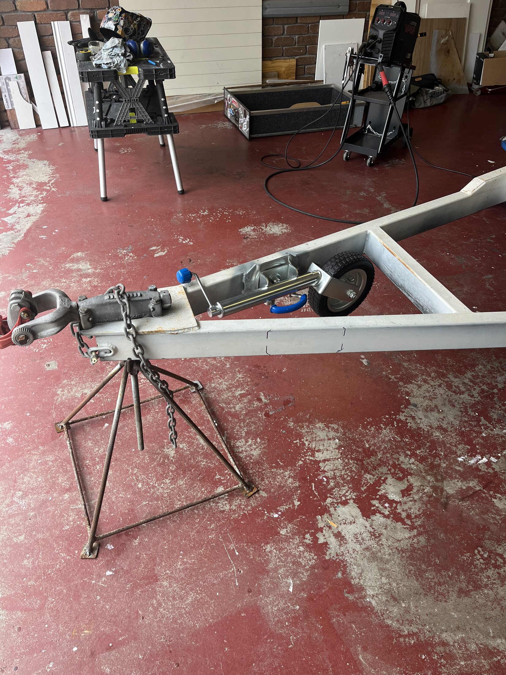

Moving the trailer with no jockey wheel is starting to hurt my back so grabbed one and welded it on the inside so not to interfere with my turning circle or front kitchen.
Can be stored in upright position with handle forward or backwards.

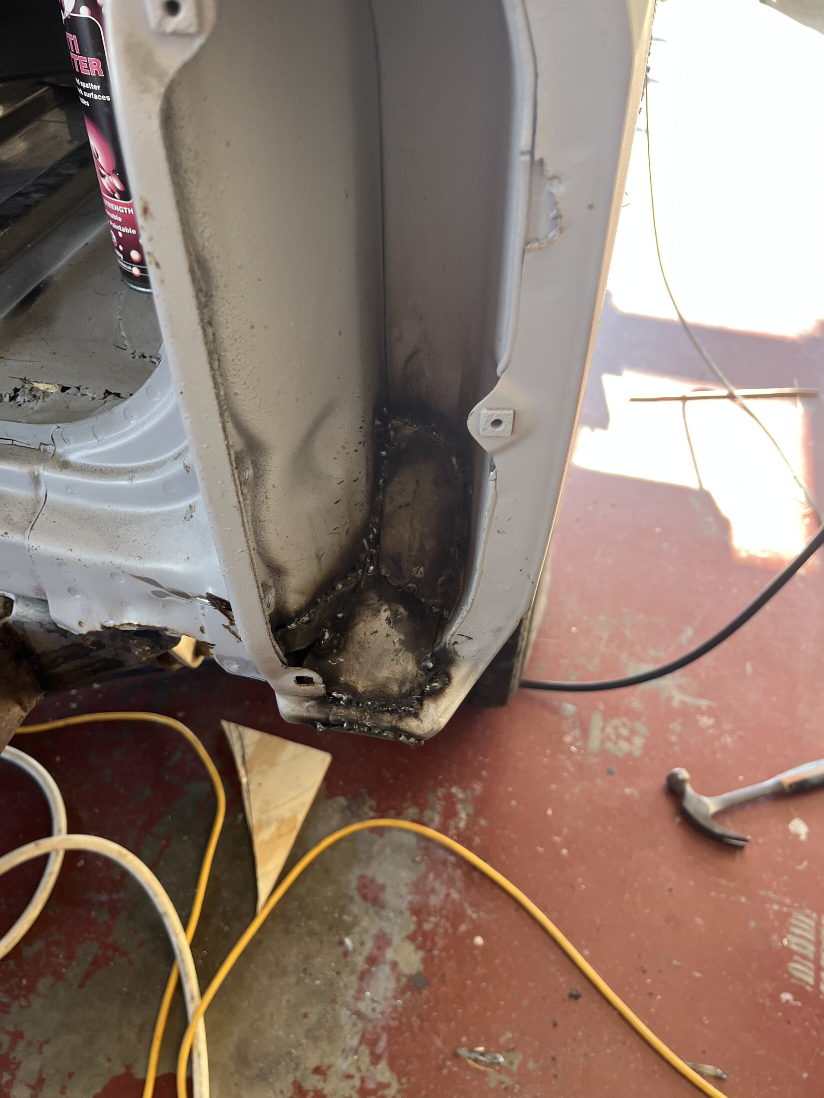

Also started tacking patches in and fixing rust spots with a grind, rust converter and primer between welds. Need to get more gas for welder today as ran out halfway through which didn’t allow the welds to flow very well, luckily I’m a great grinder.
Penetration.
It never ceases to maze me the precision you can get with a ratchet strap. Thanks for sticking with this; I didn't really want to work this morning anyway...

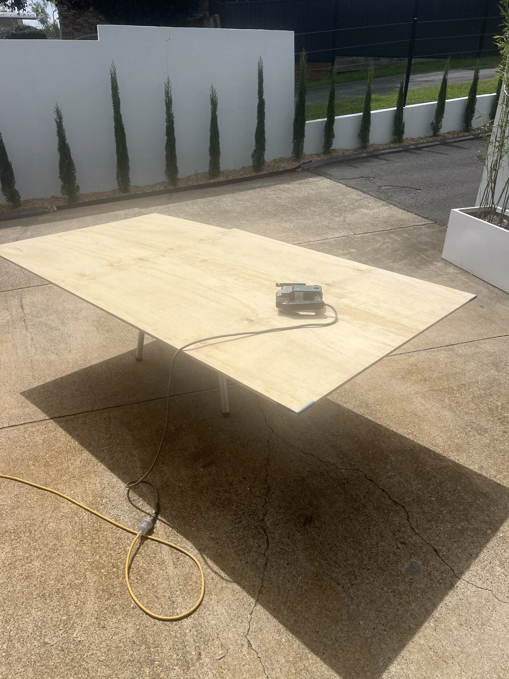

Didn’t want to go too far without having an idea on overall finishing points so thought I’d take a break from metal work and start templating/shaping the kitchen box and roof so all the lines flow best they can. I’ll only dry fit for now, no fibreglassing, then turn back onto the metal work.
Being weight conscious I’m using 12mm CD ply for floor and a couple of other strategic places. 9mm CD ply for doors and ribs and 3mm AB ply double laminated for shaping. Once glued and screwed together I’ll be applying fibreglass and matting and in some places applying sheet aluminium to stop stones damaging the fibreglass like front and underside of box.

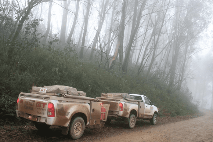

Something like this closed, but with flip over top/hard floor.
And will look similar to this open but with the pull out kitchen at the front.

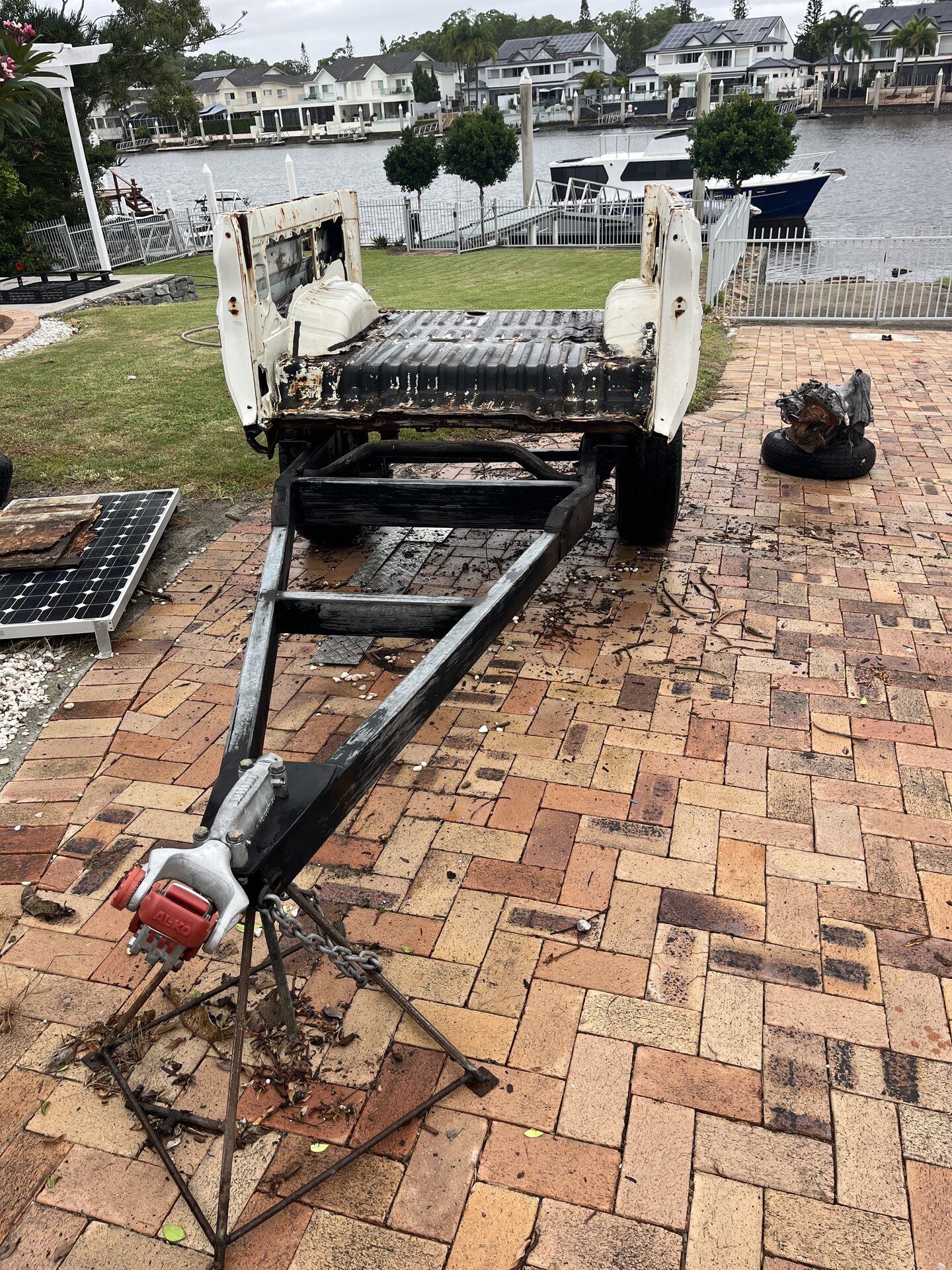

Right now it looks like this
Obviously there’s a lot ahead of me but I just want to concentrate on a primed rolling chassis and tub for now.
This leads to my first round of questions before I spend any money.

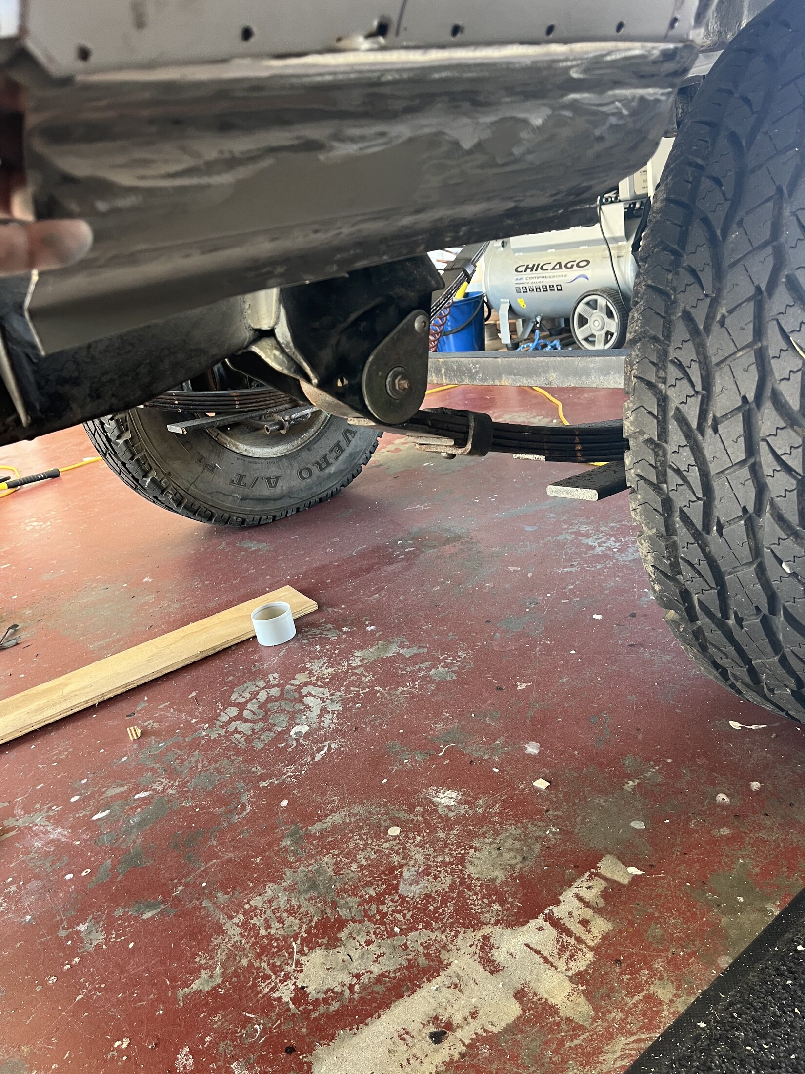

1) Can I make a trailer out of an old car chassis or is it too heavy?
2) Should I cut the chassis off at the front tubular cross member then weld an A frame back in to suit turning circles etc. Mainly because the chassis turns up at the end and would affect the way my slide out kitchen works.
3) Should I remove some leafs out of the leaf pack because it is lighter?
I will get an axle and hubs ready made when I narrow down my options.
Any help would be much appreciated.

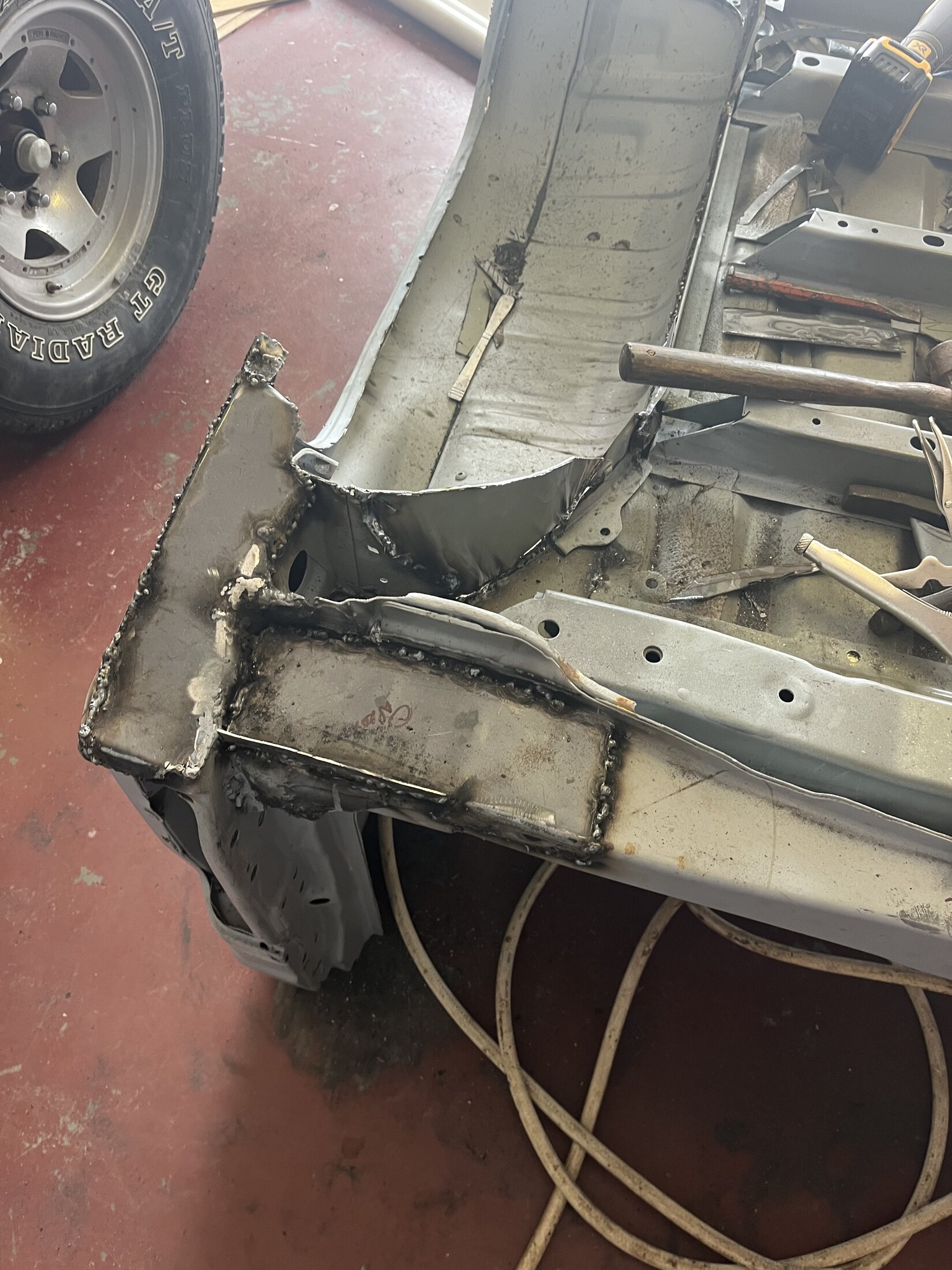

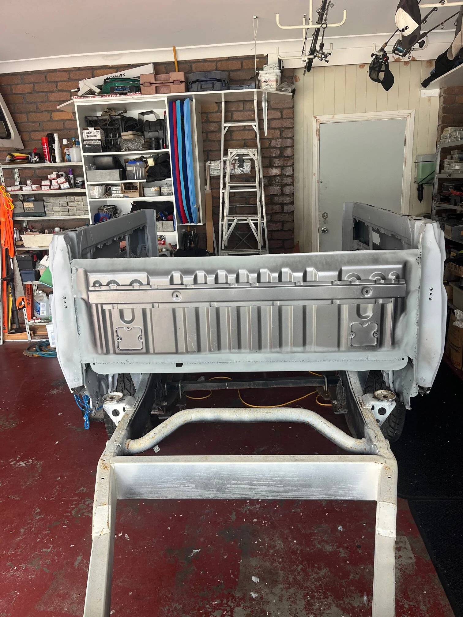

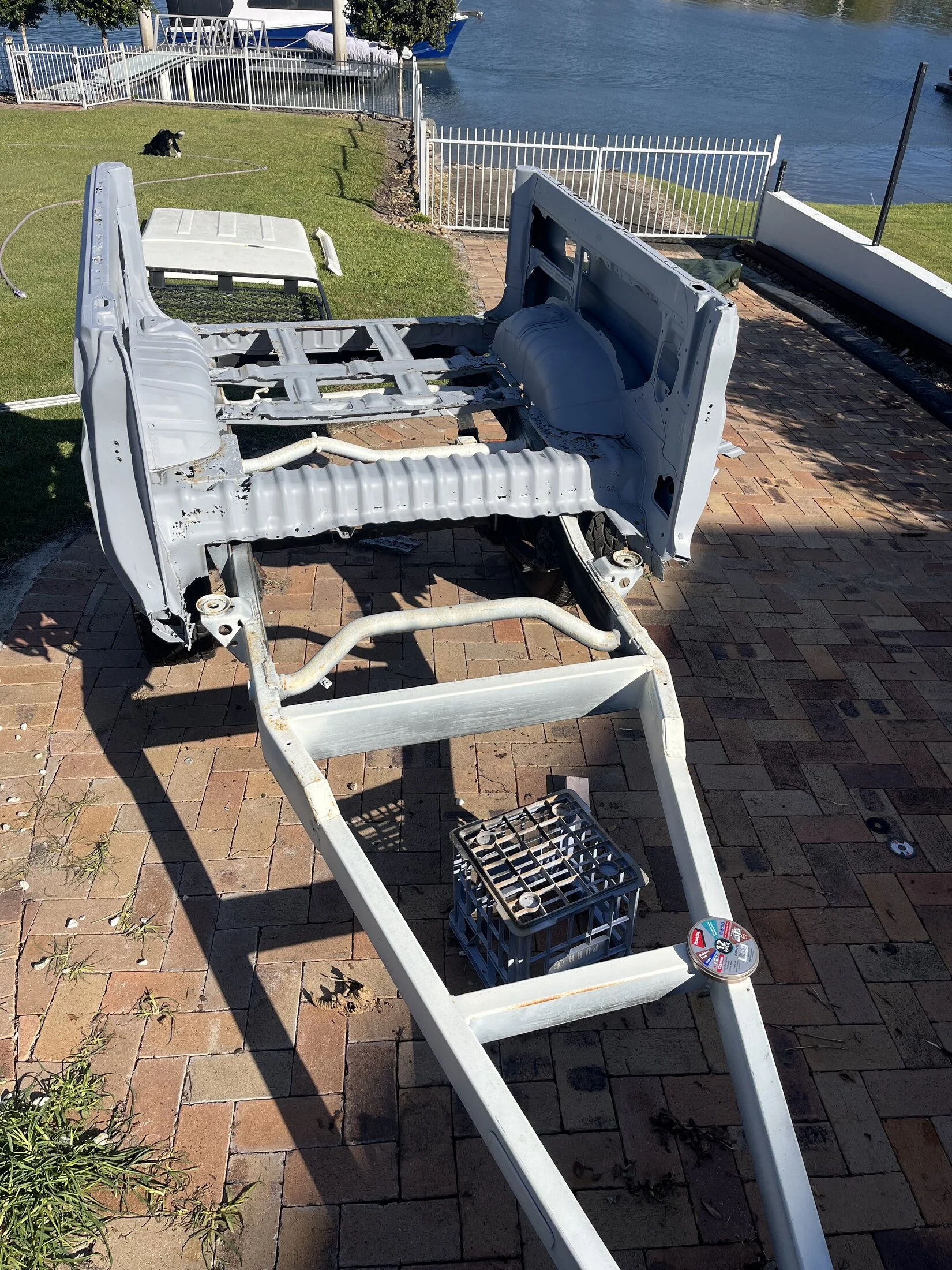

Cut any remaining rust under tub, prepped new patches and finished all the welding to underside of tub for structural repairs.
The plan is to completely finish the underside, then prep and repaint the chassis so I can bolt the body back onto chassis. This way I can just work on tub body sides, internals, front kitchen and roof without having to turn it upside down again.
Grind, rust converter and 2pac high build primer.
