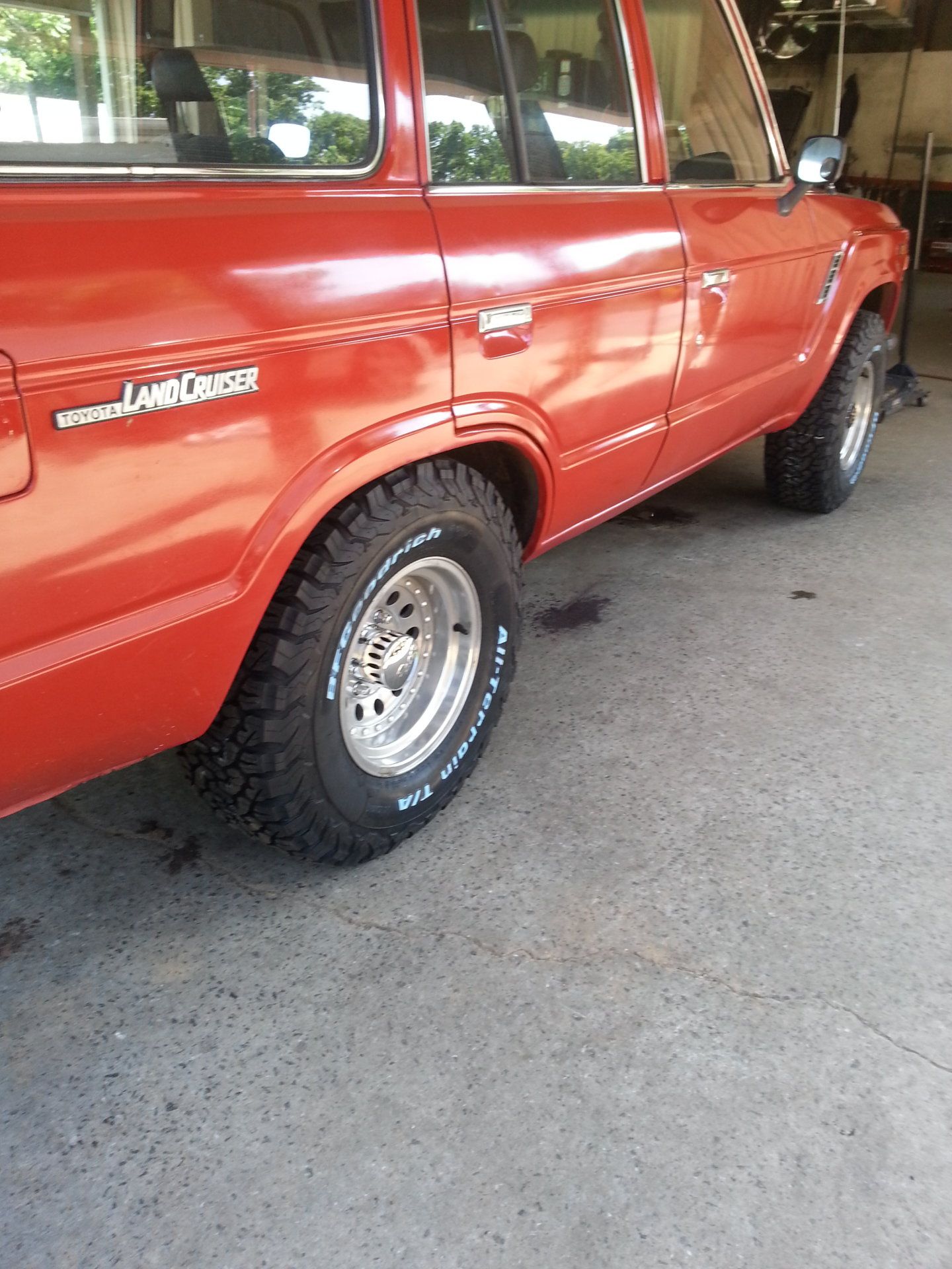

Is the PPG a BC/CC? I had a quart of Nason single stage mixed a while back using the colour code, but it was way off my factory 309 ('84 FJ60). It was closer to early 40 series 309's that I could find images of - was very bright with some pink tones. My truck is more orangey-red, not pink-red.
I ended up taking off one of the cover plates at the rear hatch, polished it up and brought it in for a colour analyzer to try to match to an existing colour library. I would try that - it seems the 309 went through several iterations over the years, so what's 309 on your truck might not be what's on mine.
Here's an image of the original match - that didn't match.
