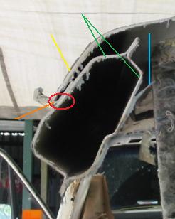

Biggest concern on a 60 for me is around the roof. Most other rust can be economically repaired (relatively speaking). Another odd area for rust is the arch over the rear wheels (the inner and outer panels come together, rub, and rust from the inside.
The roof channel area is quite complex in cross-section and generally rusts from the inside-out through condensation pooling in the metal sandwich formed between the roof panel (yellow), channel (green), and gutter piece (orange). which received little in the way of factory corrosion protection.
The blue piece is the roof liner wire holder and people often mistakenly squirt rustproofer in here. It needs go in higher up to get into red area.
