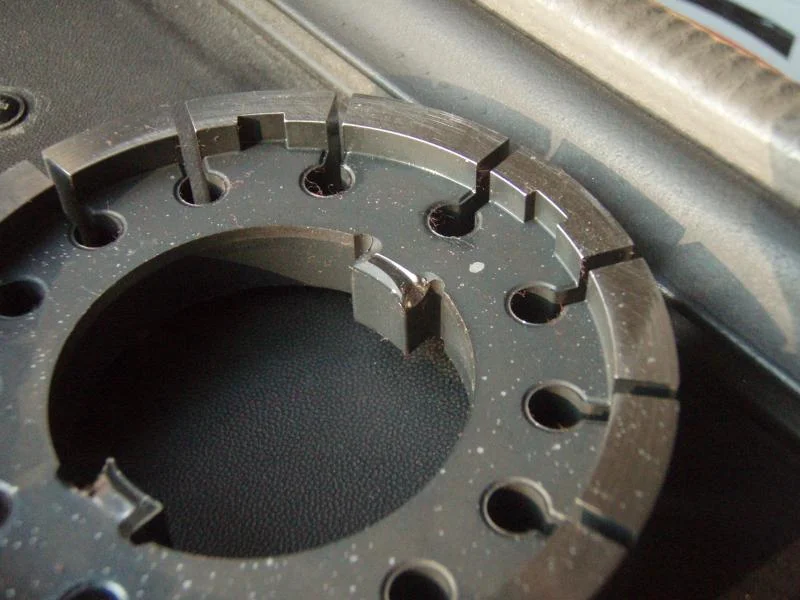

I dropped the tranny today and they will put a HD Sun Gear Shell and a Vette Servo and replace whatever needs replacing....with a 3 year warranty on the job...

Got my tranny back today.. I'll start tomorrow to put it back on....
They put a Vette Servo and the HD sun shell gear...
The guys at the shop stated that the torque converter although seated all the way, it was not graving the pump all the time or slipping off, thus not pushing oil as it should...
Here is a pic of what I mean...
It eventually would of broken right off.
I was provided with longer bolts and was told to installed a washer between the flywheel and the torque converter to asure full contact all the time....
The 3rd and 4th gear clutch was also fried !!
