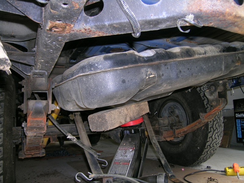

I read and read on what was the easiest way to remove frame rivets to replace the inner "C" channel on the rear frame. Everyone talked about grinding them down and punching them out, using a plasma cutter to torch them off, Oxy torch to burn them off to drilling them out.
Well this is what I found worked for me and the removal takes only a couple of minutes per rivet.
First Locate the pesky rivets.
