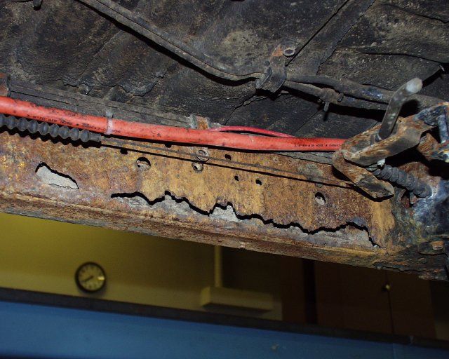

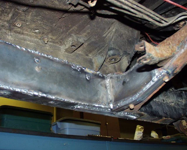

This is a patch I did way back in 2001:
I knew there was a small crack along the frame just in front of the horsecollar. So I starting knocking out the loose crusty stuff, got to here:
I ended up having to cut out the bellcrank mount for the e-brake, it was falling off. Had to convert over to an AllPro transfercase e-brake (which is still on my old red truck).
Took about 2 days of work, making templates with cardboard, torching out patches, lots of grinding, and welding on the patches. At one point I was grinding under the truck and despite having goggles AND a full face shield on, I still got some rusty metal shavings in my eye. That sucked, had to go to the ER and endure the Dreaded Eye Drill.

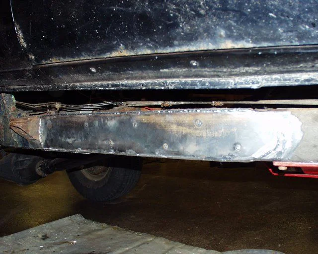

After the patches installed:
When you start cutting out the crusty metal to get to solid stuff, you'll know how to proceed. Good luck.

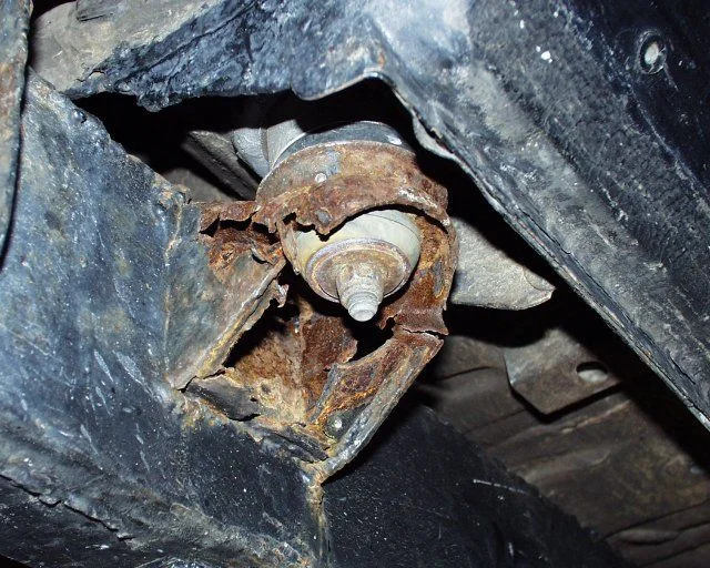

About 3 months after doing that big patch, the rear cab body mount failed, just broke off the frame.

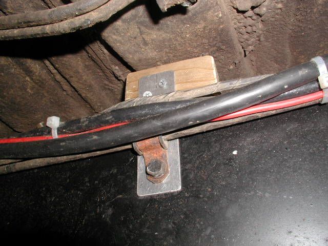

Rather than try to fix it, I just shoved a chunk of wood between the cab and the frame.

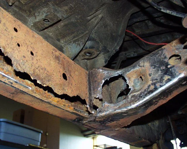

It was obvious at that point that the end was near. I had another hole open up at the top of the arch in the back next to the LSPV. I bought the red truck the next Spring (2002), and started taking it apart. I found this when I put what was left of the frame on the trailer to take it away:

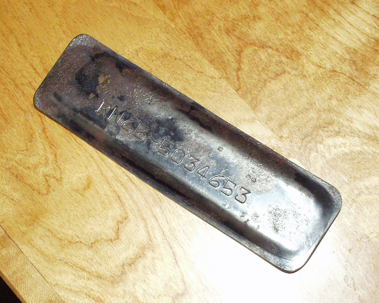

I cut the VIN stamp out of that frame, I still have it on my toolbox:
