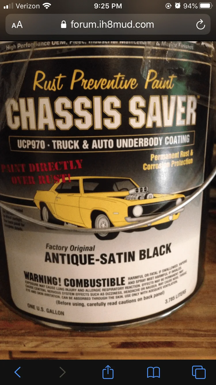

I heard/read all the POR15 suggestions but I ended up going with this. I prep’d pretty minimally with wire wheel and grinder to knock the surface rust off. Painted it on with a brush. Overall it’s held up great and has been tough.
I got it from my local auto paint/body shop. It was $100 for a gallon and I did most of the frame with about half of it. When I shopped it was way cheaper than POR15.
