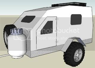

The body will look a lot like this build. I borrowed the picture so people can see what's in my head when I'm talking about.
The primary reason for the build was to haul my Adventure bike inside a body much like the ROAN trailer. And give me a real bed to sleep in with a pull out kitchen.
The back wall will be the loading ramp and the back 60% of the roof will raise uplike a clam shell so I can load the bike inside for towing. The trailer floor is 8 feet long. Enough room for the bike and a slide out kitchen in front of the front wheel.
