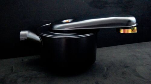

My 1965 came with 2 air cleaners. The one on the right in the first picture and close up in the second picture is the original oil bath type. The other one has two holes on the inside so I feel sure it is designed to be used with a paper element.
I have never used the oil bath type. Is it old technology and now I should use an element type? I am doing an original restoration but if something is better I am not that concerned with being absolute period correct.

Most of my Cruisers have the oil bath air cleaner. Yes old school tech, but works fine. It's probably going to be personal choice, I would stick with the oil bath if i had a choice, but im a by the book Cruiser dork. :)
Cleaning I think is the biggest difference.

Some info on #6 Restored Oil Bath Air Cleaner for a 1965 FJ45 - https://forum.ih8mud.com/threads/restored-oil-bath-air-cleaner-for-a-1965-fj45.866083/#post-9817027
Now that I know which air cleaner (oil bath) air cleaner I will be using can someone tell me the proper installation for the element (is how I have it correct). I don't remember exactly how I removed it. Also how much oil should be inside?

I think the element goes in the top of air cleaner, i can double check later today.
There is a embossed fill to line on the lower part of air cleaner, visible from inside or outside of lower part.
Goes in part C
