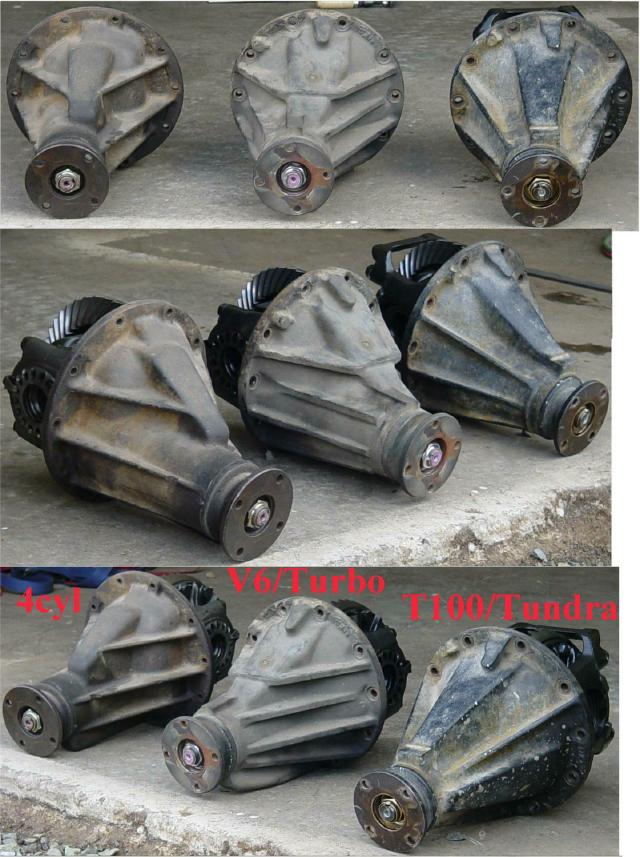

Definitely looks like an 8 inch axle, does the diff look like any of these?
If it is an 8 inch, then your options for traction devices are plentiful, which is good.

Erik's Toyota Differential info
Gearratiosanddiffs
