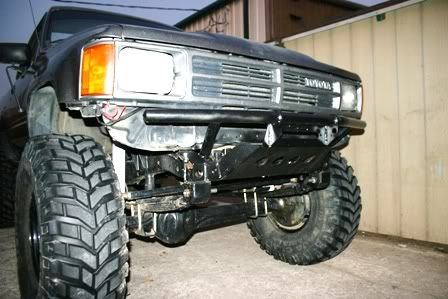

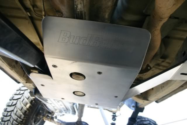

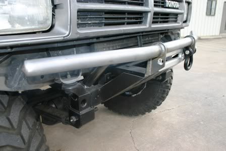

I build all of the armor for it. Front/rear bumpers and sliders.

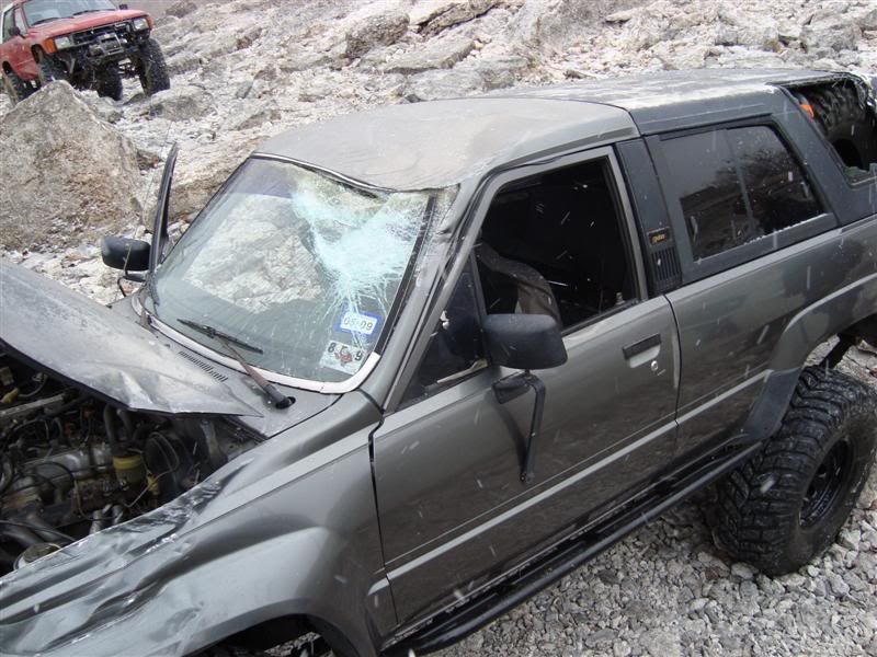

....This is as far as the truck got before i rolled it.

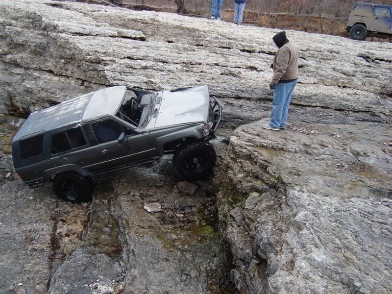

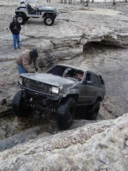

OHH no, you break it you get the chance to build it better. I acctually rolled it a couple weeks ago at hogans on the GM Stair Case.
Sometimes thats true, but that thing is straight! You wheel hogans alot? Its been a while since ive been, in fact... I dont think ive had the chance to run my truck there since ive locked it!
Nope, that was my first run there, and the first real run in the truck since i built it. Stay tuned and you'll see the turn out.

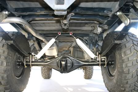

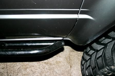

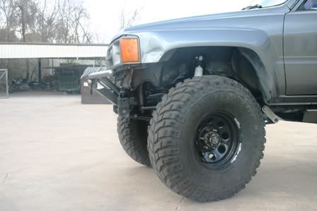

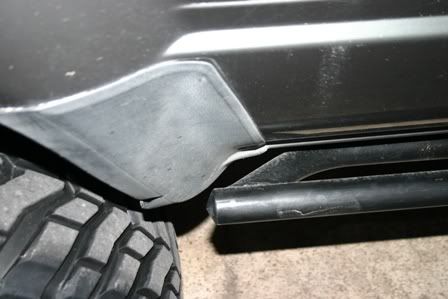

I'll start with the armor. The sliders and front were build after the truck was decided to be a trail rig, and the rear was one of my first tube projects back when it was strictly DD.

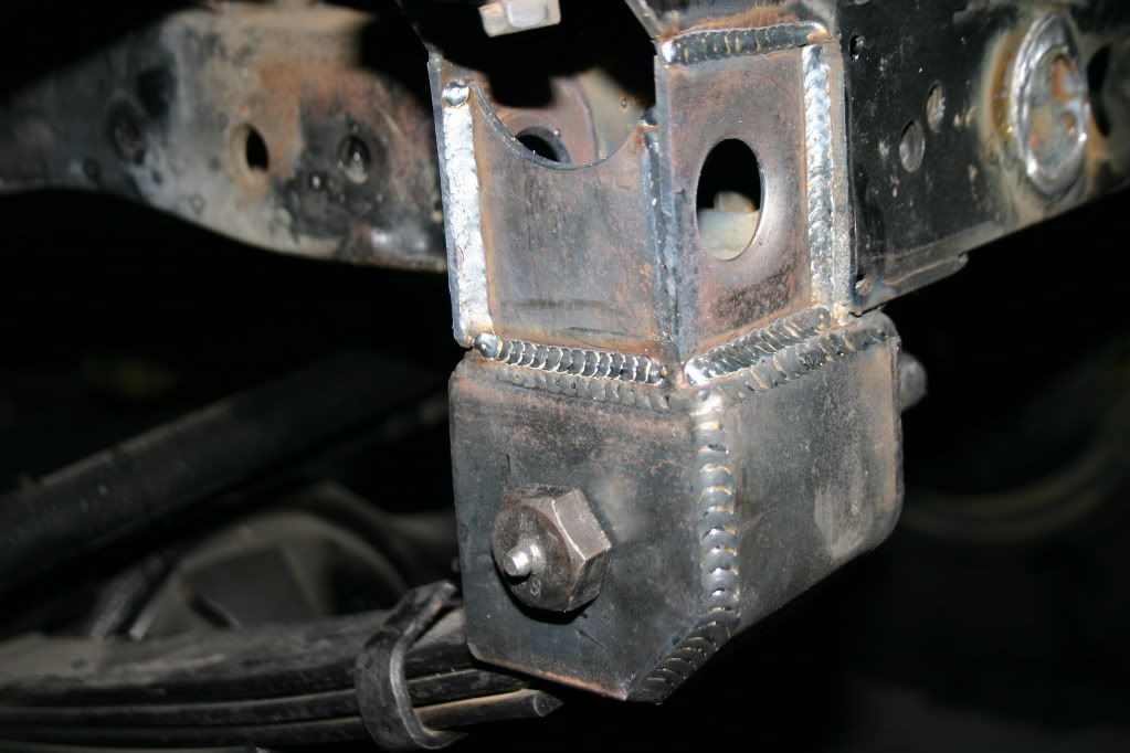

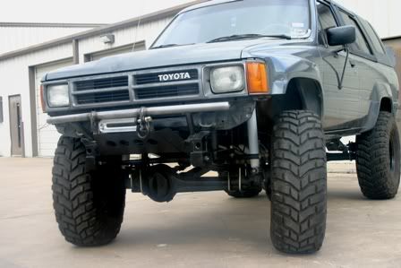

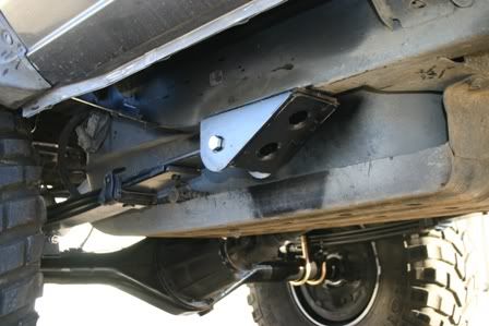

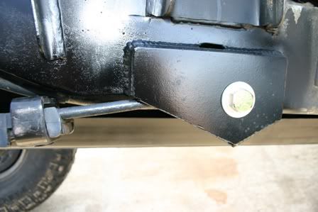

With the truck being originally IFS the frame cause some interferance with the steering linkage and box. I got it as low as i could by making my own spring hangers (2" less drop than most aftermarket sas hangers) and mounting the shackles through the frame rather than under.
If I can find a way to drop the front down i will go back and french the rear hangers like i did on my last truck.
4runner chevy hangers
Frenched hangers from my last truck

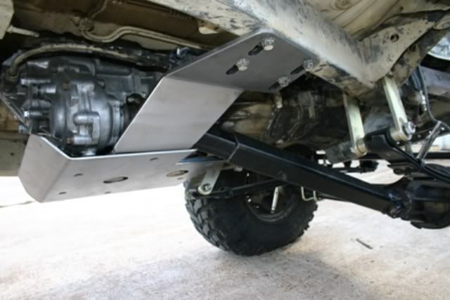

the drivetrain.
Motor- 22r converted to a 22re. The original motor was a 22re and i replace it with a 'rebuilt' 22r block and head from an 85. That motor had a little work done to it ie: bored .30 over, low range cam and port/plolished head. My advise, dont spend your money on that stuff, it really didnt make a noticeable difference and was prob close to 1K in parts and labor. BUT, i got about 3K miles out of that one when all of the oil just seemed to dissappear after a 200 mile trip and started knocking like crazy.
So, i pulled another "rebuilt" 85 22r from my last truck, stock specs, and that is what is in there now. Soon to be replaced with a 7mgte (3.0 Turbo I6 from an early supra)

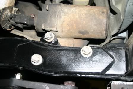

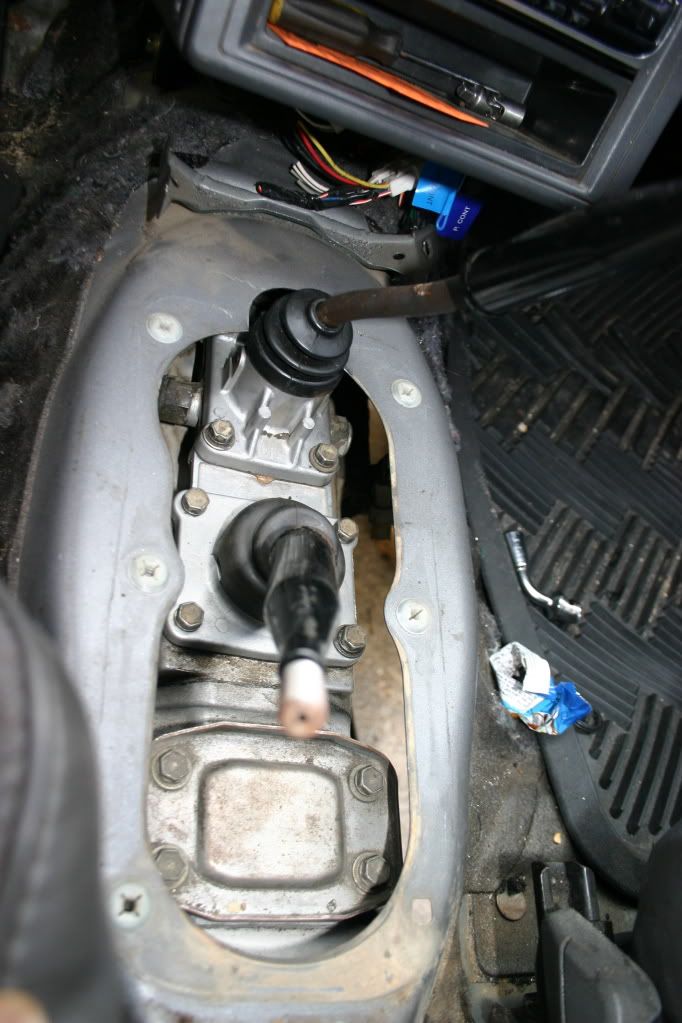

Trans/t-case - stock w56 mated to a forward shift stock geared t-case, fallowed by a stock geared crawler. The original t-case was a top shift which has caused an ugly mess in my floor board since all of the shifters have moved and dont line up any longer. i have yet to do anything about that.

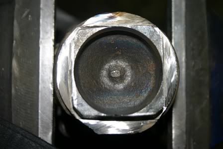

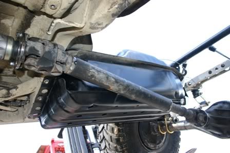

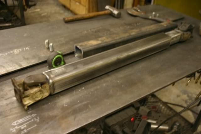

Drive shafts- Rear is a front cv cut down and retubed. front is a rear single square tube of my own make;)
Axles - front is from an 85 w/ 1.5" wheel spacers and the rear is the stock IFS rear. i have done nothing to them other than some diff armor i made but i do have some 5.29's and lockrites i haven't had a chance to put in. Oh, and the rear spiders were welded (awful on the street but does the job on the trail)

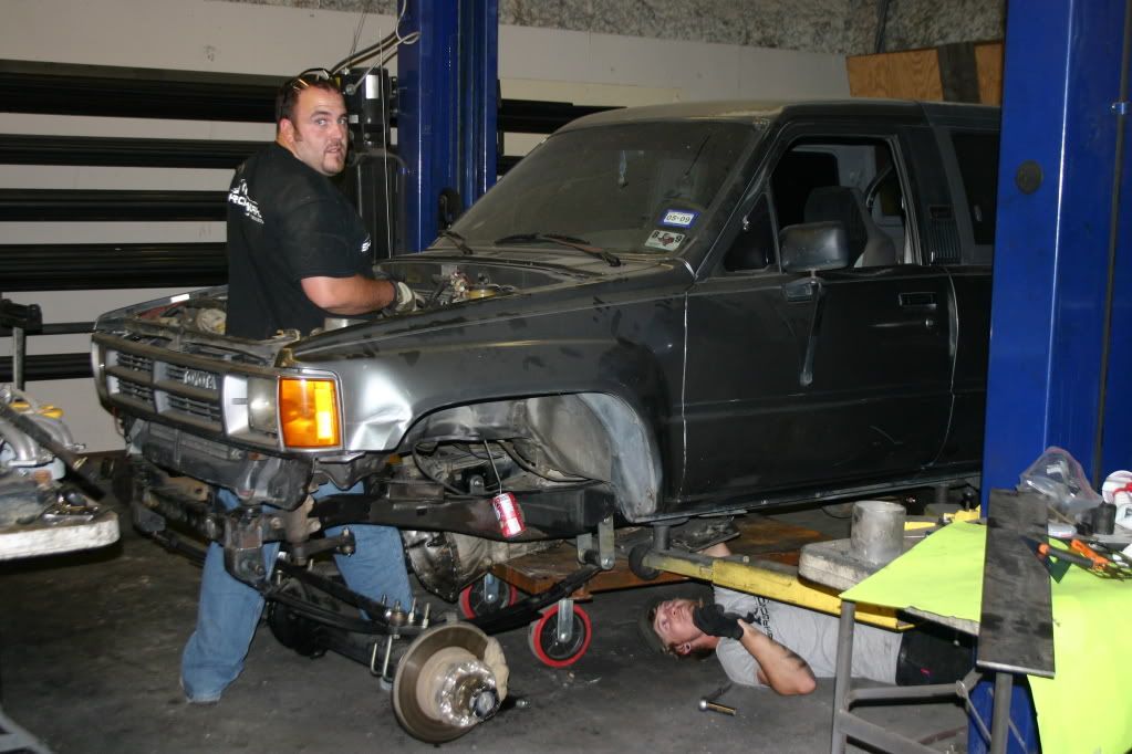

my buddy steve givin me a hand...

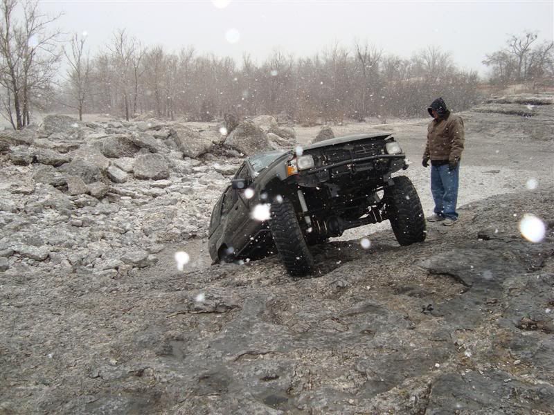

Moments before we went over

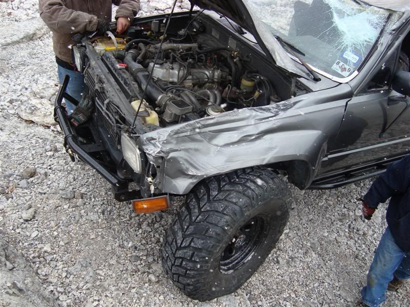

Evacuation!
Evaluating the damage...just had to put the battery back in!
Lining up for round 2

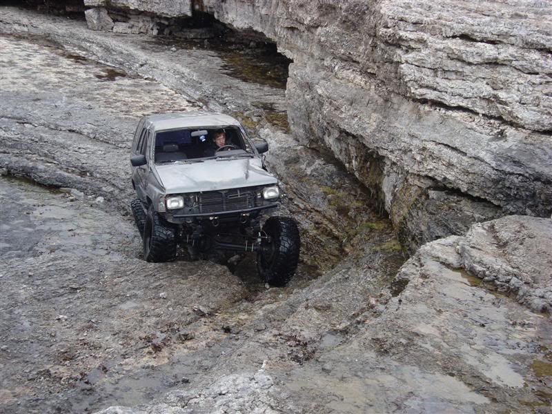

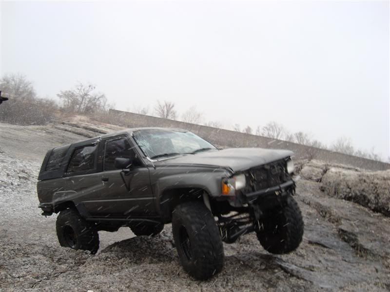

waterfall trail...took 3 shots but i made it. Front locker next time.

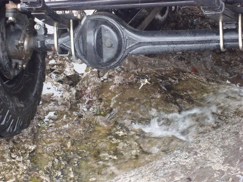

With all the hopping and banging around my keys fell throught the shifter hole in the floor board, luckily they were spoted

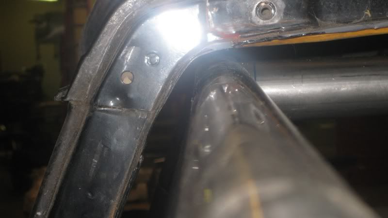

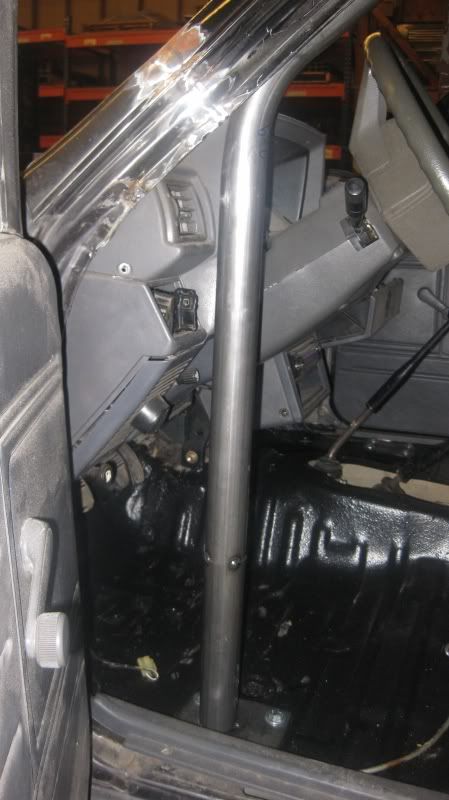

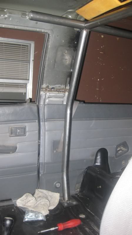

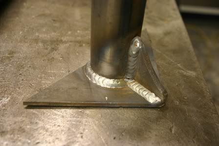

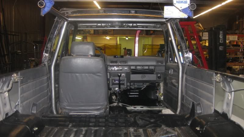

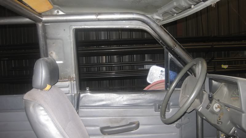

On sunday i reinstalled the cage feet in the front and started my "FOE cage", its just a mach up so i can get my measurements while im waiting on DOM. its turning out pretty decent, there will be some slight alterations but this is how its comming together.
