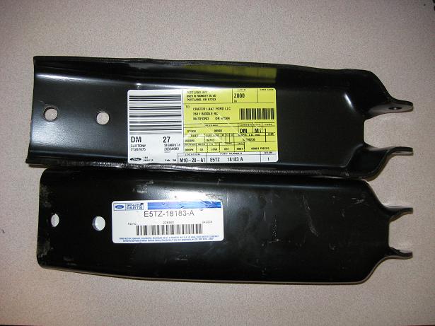

I know this is an old topic but it was the most complete one on just ford shock towers and I figured as so many people ask I'd just bring it back to the top with aditional information ;P
part # E5TZ*18183*A
ford f250 1980
just googled ford shock tower.I think it cost me like 35$ for a set a couple months ago.
Thanks for the numbers, they are still the same. Don't think it matters but Lee (the service tech at ford) said these were from 1990 to current?? (not saying he's right)
Just bought mine today here's a couple pictures to confirm whats already been said :)

Hey Dark Realms, can you tell me the measuremnent from the bottom of the mount to where the shock pin mounts. Thanks.
Sure thing, along the flat edge (outside edges of the U shape) it is 13.75". Let me know if you need a different measurement.
. . . ok I wasn't even satisfied with that answer! Standing it up at the angle it will be bolted to the frame and measuring from the table (it is standing on) is 13.5" to the center of the holes.

Thanks for that. They are huge! I measured the standard shock mounts to be about 6". I ordered some to see if they will fit with a 2" bodylift without cutting the guards out.
I ligned it up next to the current shock mount and it almost fit. I plan on doing some hammer work instead of doing the cutting. Maybe I'll do a little circle cut but I don't think I'll need to :)
If you look at the below picture by brokenparts it almost doesn't need to be cut. Although I will probably have fun getting the bolts in . . . thats my plan.
